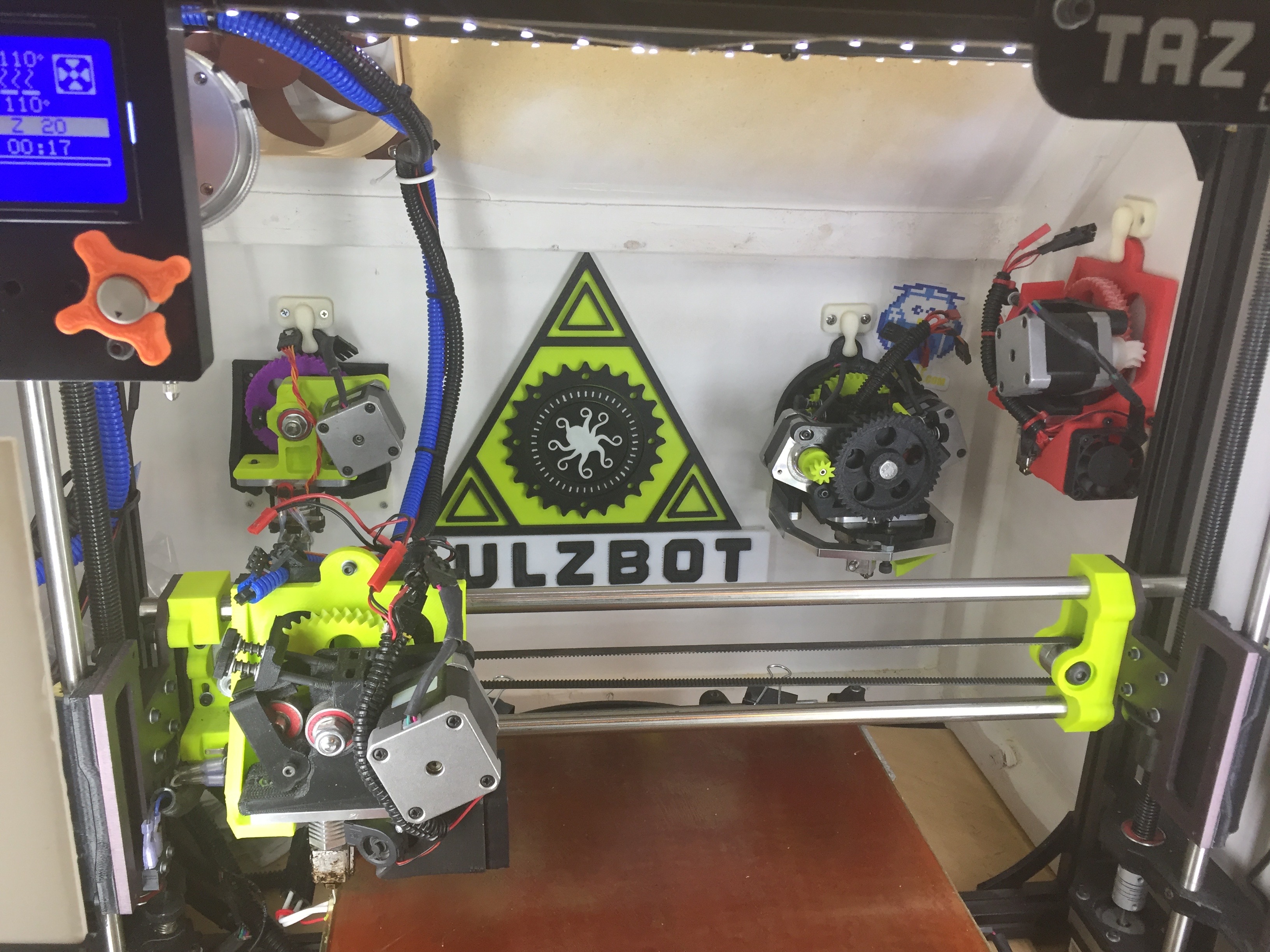

I’ve done the 12mm rod X axis upgrade using the Billyd mod. Drilling the plates was no big deal especially if you have a drill press. I’m very happy with the results and WAY less sag when using the dual extruder.
Shameless showoff pic with my other latest mod (holders for my toolheads) and my Lulzbot logo. 🙂

That work station looks great. We may have a spare tool head or two that could use some storage around here… Any chance you can share your tool head holder hooks?

Absolutely Brent.I. Thanks for noticing.
I went ahead and posted it under the user gallery topic [here](https://forum.lulzbot.com/t/toolhead-storage-solution-latch-and-holder/4103/1).
And here’s the Thingiverse [link](http://www.thingiverse.com/thing:1828290).
