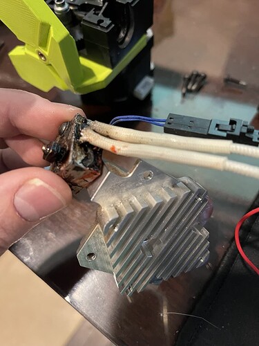

**Author:** ![PWn3R](https://avatars.discourse-cdn.com/v4/letter/p/91b2a8/32.png) [@PWn3R](https://forum.lulzbot.com/u/PWn3R)\
**Post date:** [May 4, 2022, 5:20pm UTC](https://forum.lulzbot.com/t/2nd-hand-taz-workhorse-multiple-issues/24479/13 "2022-05-04T17:20:44Z")
Thanks for all the feedback. This is what I am seeing after disassembly:
 ![IMG_0755](https://us1.discourse-cdn.com/flex020/uploads/lulzbot/original/2X/9/93703a2ed2d1c67c75f81004f629b114a6912d3e.jpeg)
It looks like the heat brake tube is not inserted far enough and the filament is going out of the side up and around. Can you confirm if the tube is threaded or not? I tried wiggling a little with fingers, but can’t move it. Not sure if it’s smooth or if I need to grab by the part with no threads with say pliers and thread it in more (needs to come out first because there’s a ton of PLA in there right now).
**Post date:** [May 4, 2022, 6:12pm UTC](https://forum.lulzbot.com/t/2nd-hand-taz-workhorse-multiple-issues/24479/14 "2022-05-04T18:12:13Z")
That looks correct. The assembly instructions for the extruder is here: [https://e3d-online.zendesk.com/hc/en-us/articles/360016764817-Titan-Aero-Assembly-Guide-Edition-2-](https://e3d-online.zendesk.com/hc/en-us/articles/360016764817-Titan-Aero-Assembly-Guide-Edition-2-)
Note this is just the assembly of the E3D Titan Aero extruder and not the entire LulzBot toolhead assembly. But you can refer to this to see the heat-break.
