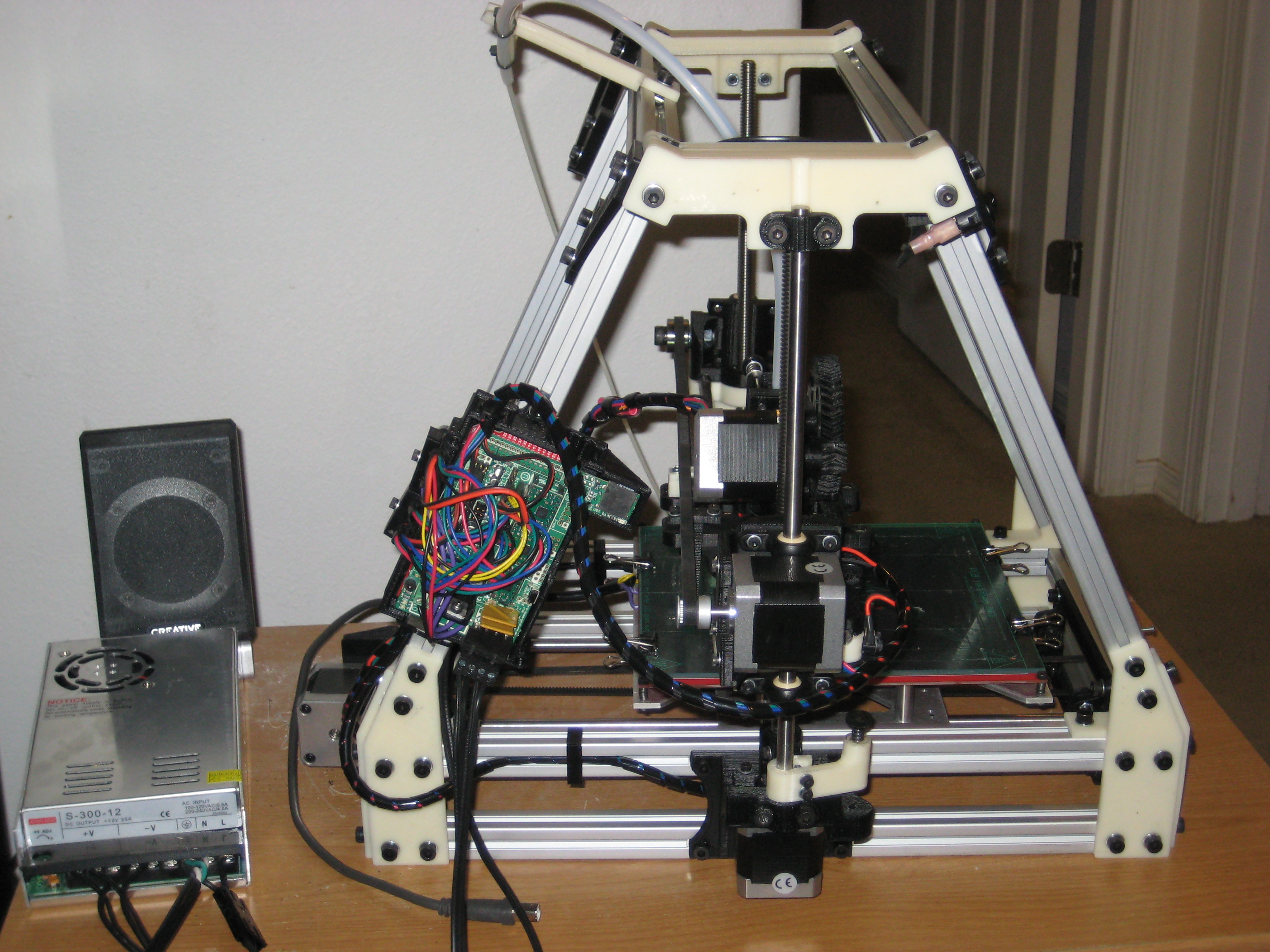

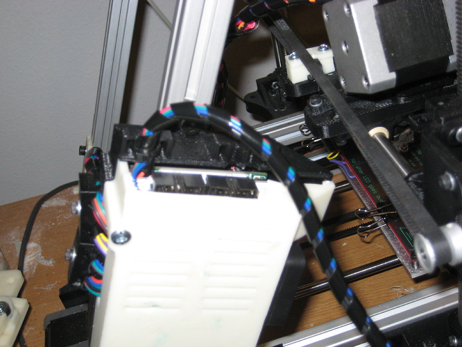

It works! It printed! Pictures and exclamation points! (ignore the green residue on the surface of the cover, my Kapton tape and I got into an argument, and I lost. I should have replaced the tape before I attempted the print.
 ![IMG_1157.JPG](https://us1.discourse-cdn.com/flex020/uploads/lulzbot/original/1X/a661ef0ad46da8772e6cea923ae37755378af039.jpeg)
 ![IMG_1158.JPG](https://us1.discourse-cdn.com/flex020/uploads/lulzbot/original/1X/1c823738b12d079afaa4cc5a350beee6ff25f7a0.jpeg)
It looks like I may need to either flatten my wires more, or possibly make the cover slightly taller. I haven’t actually bolted it down yet because I need to aquire a side fan for it. Everything lines up, I may need to clearance the MicroSD card slot a bit, but it fits!
Also, for no apparent reason, the X axis belt tensioner. It works well!
 ![IMG_1160.JPG](https://us1.discourse-cdn.com/flex020/uploads/lulzbot/original/1X/8998ffacd78abbd7223f41df365cb9d006b7dbc5.jpeg)
And my machine too. Why not?
 ![IMG_1161.JPG](https://us1.discourse-cdn.com/flex020/uploads/lulzbot/original/1X/ac59c2822a2eae9b8eb4bbf1f581a11da29f6615.jpeg)

**Author:** ![Gemini64](https://sea2.discourse-cdn.com/flex020/user_avatar/forum.lulzbot.com/gemini64/32/8_2.png) [@Gemini64](https://forum.lulzbot.com/u/Gemini64)\
**Post date:** [September 8, 2013, 5:19am UTC](https://forum.lulzbot.com/t/a0-100-ramps-cover/259/12 "2013-09-08T05:19:08Z")
Nice work. 🙂
> [@piercet](#):
Yeah, I had a look at your stl and figured it was rather low. I think it should be 40mm (1-9/16") high at a minimum, maybe up to 50mm (2"). Also, at the height you did you won’t be able to place nuts in the inside to hold the fan. Going higher will allow you too. It would also be a good idea to make the same thing as the current lower RAMPS mount and thicken the wall in the hole areas to make hexagon recesses for the nuts.

**Post date:** [September 8, 2013, 8:39am UTC](https://forum.lulzbot.com/t/a0-100-ramps-cover/259/13 "2013-09-08T08:39:50Z")
It actually does fit with a little persuasion. The fan itself is mounted to the cover half only by fan screws, the ones that are designed to thread into the fan screw holes themselves and lock the fan in place. It only needs anchored at the top or bottom for stability. I’ve already modified the cover some to make room for the LCD cables for the LCD that now goes off of my RAMPS 1.4 board with the correct pins. I need to reinforce the cover itself in the middle to provide some mounting holes for the bracket for the LCD as an option. I’ll probably extrude it up another 10mm at that point, but it will be a while before I get to that now that I have a working one and I’m on to the next upgrade project. The current cover is fully bolted down and operational though, so it will work as is.
The tensioner came from thingiverse. It’s listed as a Y tensioner of some sort, but i didn’t write down specifcally which one it was at the time. Here’s the stl file for it, but it is not mine and I take no credit for it. You’ll have to either widen it slightly or (like I did) clearance the holes slightly as it prints slightly narrower than the screw width, but there is plenty of case left over and its plenty strong.
