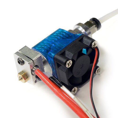

Wouldn’t it be possible to take something like this:
> **[Amazon.com: 3D CAM\] All Metal Hot End V6 for RepRap 3D Printer Bowden Extruder...](https://www.amazon.com/RepRap-Printer-Bowden-Extruder-Filament/dp/B013Z36EOY)**
> Amazon.com: 3D CAM\] All Metal Hot End V6 for RepRap 3D Printer Bowden Extruder 3.0mm Filament 0.5mm Nozzle 12V 40W Heater : Industrial & Scientific
Remove the tube quick connect, make an adapter plate that fits my extruder, wire the fan to one the two unused fan the Rambo 1.0e fan outputs.
I realize that doesn’t get a filament fan…

Sure. But don’t get that one, it’s a piece of junk. Thats a bowden tube setup, they have pros and cons, usually they result in stringy parts. Either way, that setup or using an extruder body setup for an E3Dv6 in place of your stock one ([https://www.thingiverse.com/thing:673312](https://www.thingiverse.com/thing:673312)) you are still going to have to tinker with firmware and wiring. if you are comfortable with that, go for it. It will be a massive quality improvement.

I realize that one is set up for bowden tube. I guess my query was that the criteria for mounting any hot end to the extruder is that it bolts up so the input (top end) to the tube in the heater block is close to the output of the extruder.
How does one tell the one I happened to pick is junk and the one nearly 5 times the price from this source is any better?
(not trying to be sarcastic or anything, I just want to know how I would go about telling.)
And the firmware tinkering is because the thermistor is different?

The real ones are made from decent metal, and have a properly polished inner bore. the fake ones are sometimes made from plated pot metal and will fail catastrophically and most likely not work. The only real way to tell is source. I’ve never seen one of the cheap chinese ones work right. Sometimes they catch on fire when the heater block burns, destroying your 3d printer.
The firmware tinkering is due to different thermistor, different heater core, enabling the fan pins, and diffferent maximum temperature ranges so you can actually use the thing at full temperature. You can copy many of the values from the Taz 5 firmware.
