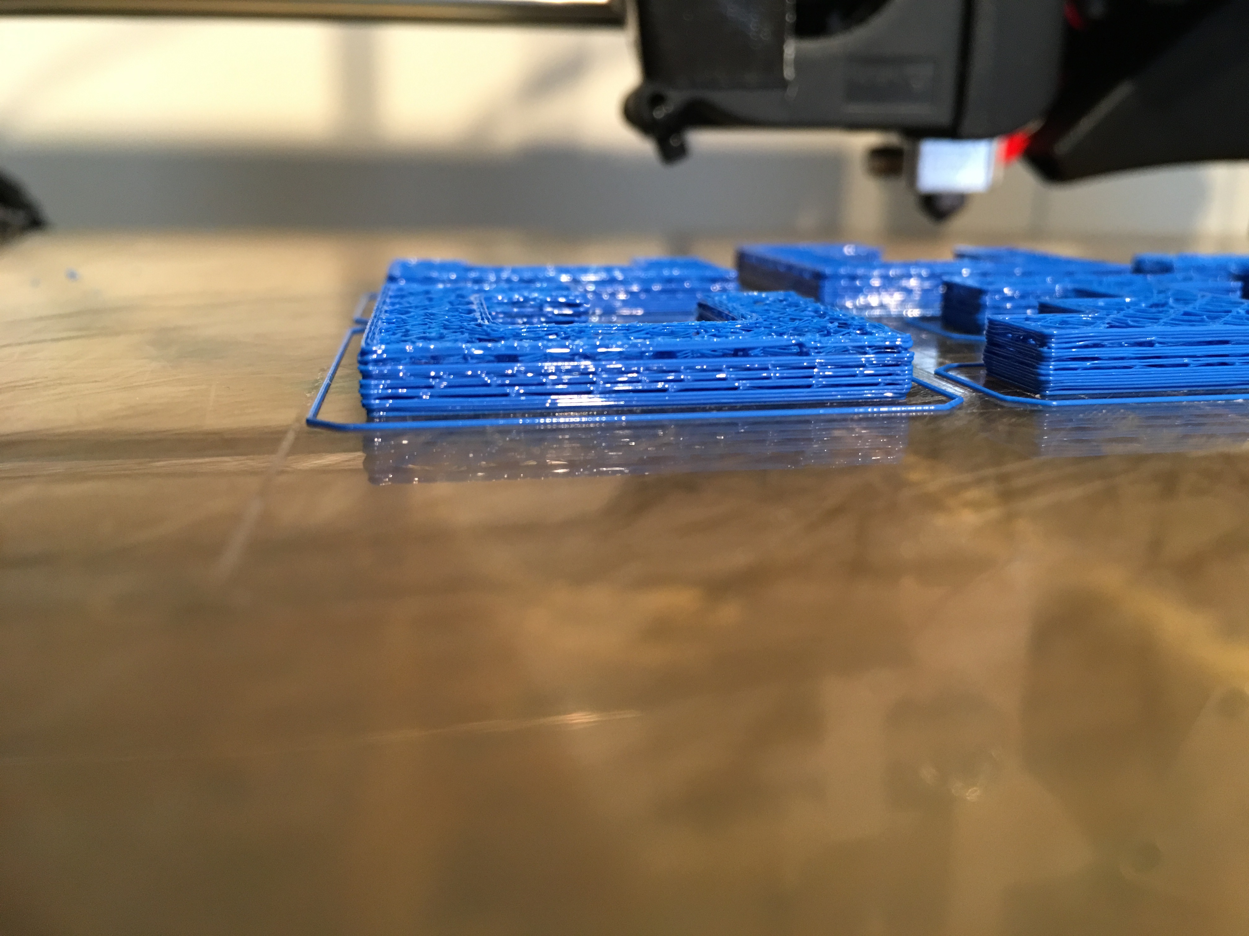

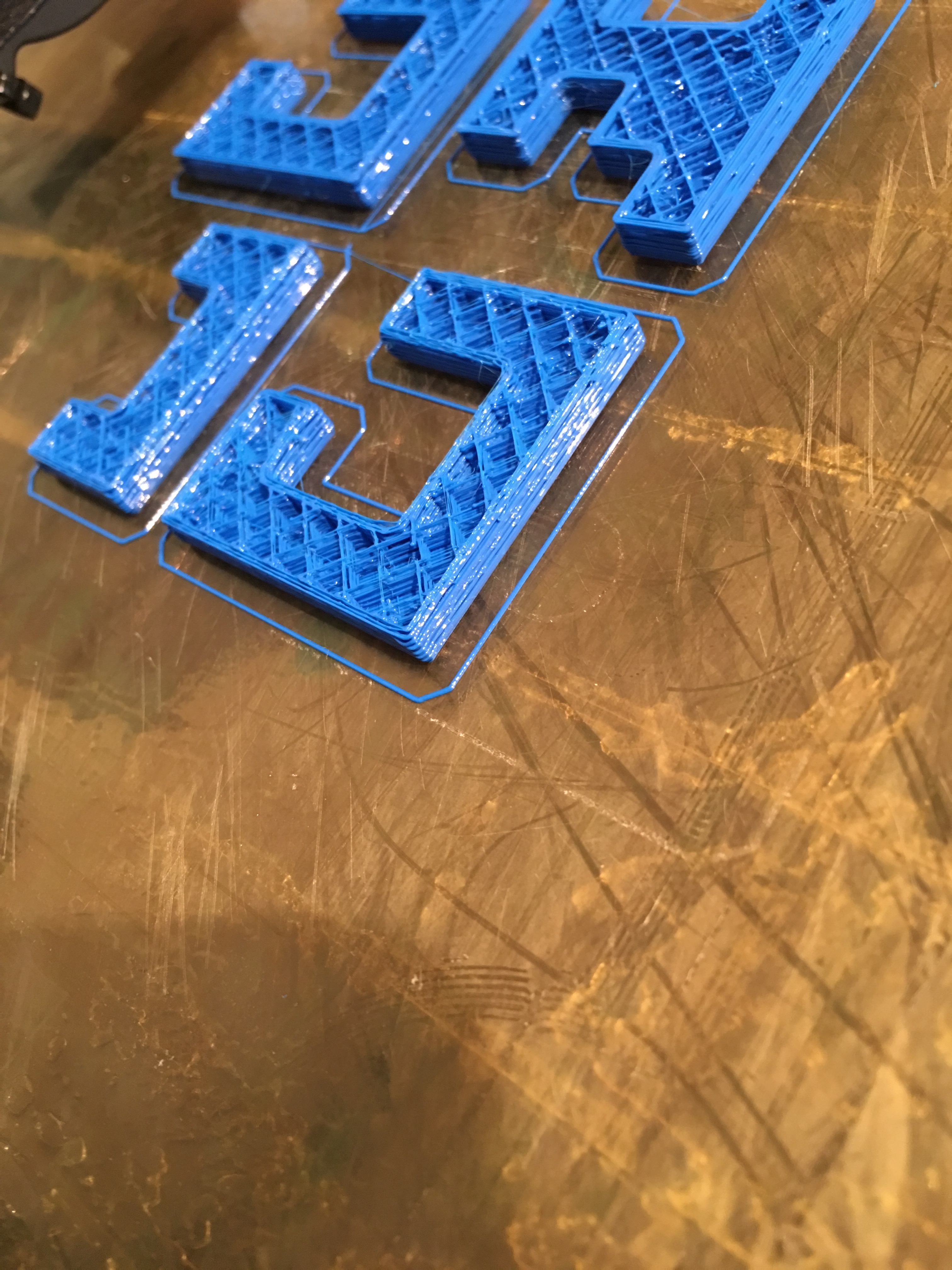

I’ve had the Lulzbot Hexagon hotend since March and have yet to be able to print successfully with PLA. ABS prints great but PLA is another story. At first I thought it was heat creep so I tried one of the blower fans on the heatsink but the problem persisted. I even tried the latest Mangrove extruder carriage with front mounted 5v fan. Still no luck. I’ve tried switching between both eSun and Village Plastics PLA. Same problem. What else could my issue be except heat creep?

Which slicer? Please post your profile settings.
Why do you think it’s heat creep, do you get extruder jams?

Thanks for your reply. I’m using Cura Lulzbot edition with the default profile for PLA. Only adjusting for filament width.
**Post date:** [November 22, 2015, 7:16pm UTC](https://forum.lulzbot.com/t/about-to-give-up-on-pla/2512/4 "2015-11-22T19:16:57Z")
Ok, I need more 😉 what’s the value for your e-steps. What’s your pla nozzle temp. When you are extruding in the air, is the pla coming in a nearly straight line or is it curling up on the nozzle?

I haven’t adjusted the e-steps from the default that came with the printer. I think it is 824. Nozzle temp is 205. Nozzle diameter is .35. PLA comes out nice and straight when extruding into the air.
**Post date:** [November 22, 2015, 7:34pm UTC](https://forum.lulzbot.com/t/about-to-give-up-on-pla/2512/6 "2015-11-22T19:34:38Z")
That’s realy strange. I throught it might be under extrusion or too cold extrusion. But with your values, that should be OK. Why I was asking for free air extrusion: If you did no perfect cold-pull when switching from ABS to PLA, there might be some ABS in the nozzle that blocks the flow.

Ok folks, I think I’m narrowing down the issue. I have tried different hexagon hotends (I have one spare) and still had the same issue. I’m convinced it’s either a filament or slicing issue. I’m leaning towards filament. I have a fresh roll of eSun PLA on order and will post back with results on that.
