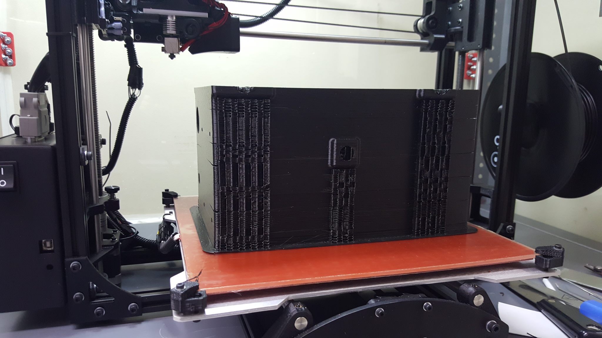

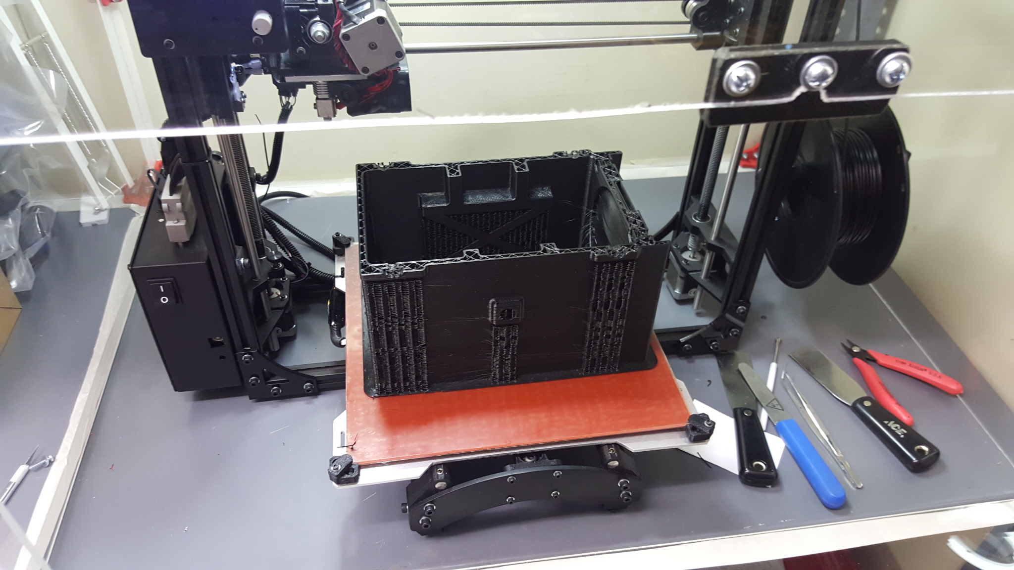

Ladies and Gents!
I really hope someone has a few answers.
I have built an enclosure and upped the nozzle to a hex .8 the nozzle temp is at 255c and the bed is 110.
I have tried printing at different temps from 240 - 255 and have not changed the bed temp.
I am using 3mm matter hacker filament and set it to 2.85 in cura. I have tried turning off the fan and have changed layer height from .6 to .4 and still have this issue. I also have been using brimming with 10 lines.
please let me know if you have any idea on how to fix this issue… thanks!

.8 is quite high, what’s your print speed? It might be possible that you print at a too high volumetric speed so your extruded filament isn’t hot enough (like if you pull your finger through a flame quickly)
How thick is the wall?

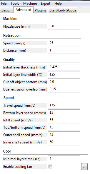

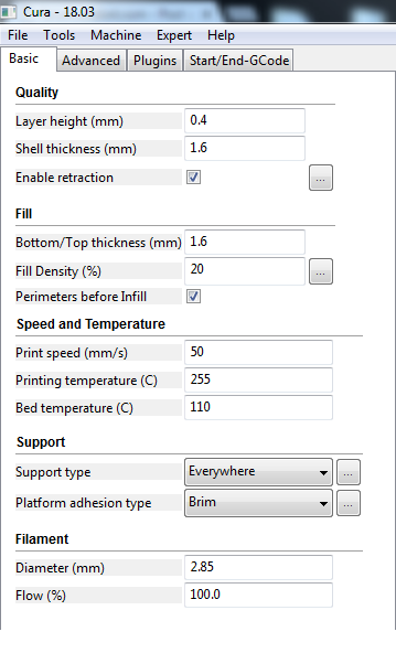

i am attaching my current cura settings as well for you to look at

The problem with cura is that you have no real control about the line with. But assuming it’s using .8mm, you are printing at 16mm3/s.
The Wall thickness is quite low, maybe it’s not possible with abs. But I would try to reduce the volumetric speed below 10mm3/s, that’s 30mm/s, at 0.4mm layer height. Don’t forget to change the speeds in the advanced tab as well!

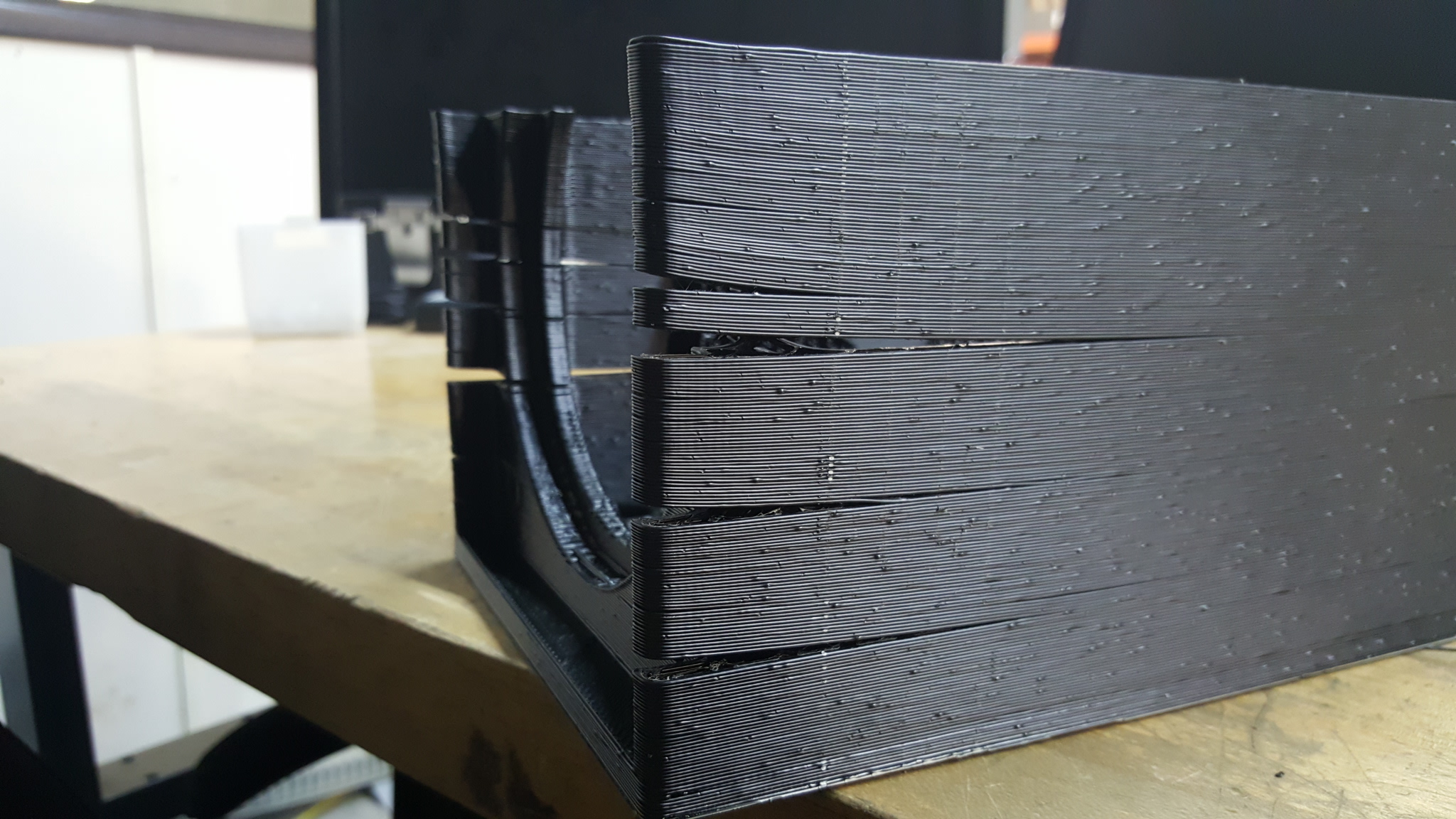

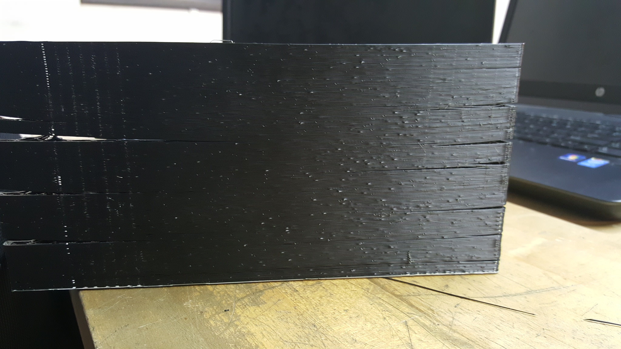

ok so i printed this one at
print speed: 50mm/s
layer:.40
nozzle: 255
bed:110
no fan…
brim: 10 lines
travel speed :175
still cracking but much better then last time
 ![20160213_084400.jpg](https://us1.discourse-cdn.com/flex020/uploads/lulzbot/original/2X/7/7ac7b450d4856ade588dc10952d9587af9dc6371.jpeg)
 ![20160213_084324.jpg](https://us1.discourse-cdn.com/flex020/uploads/lulzbot/original/2X/1/1a35b461ea2b398136638b1c47e2240408eeabb8.jpeg)
 ![20160213_084338.jpg](https://us1.discourse-cdn.com/flex020/uploads/lulzbot/original/2X/2/222677e20e44aced5e4629cc35a8199500e3f8c0.jpeg)
i just put in another one to print with the suggested changes and few other changes i think may help. I am listing the changes below if anyone has anymore input i would really appreciate it! 😃
print speed: 30mm/s
layer: .40
fill:20
nozzle temp:260
bed:110
no fan…
brim: 15 lines
travel speed: 100
at 15mm the bed temp will go up to 115 over 5 layers
I also put a small space heater in the room and set it to 80 to keep the room nice and warm all night…

Extrusion temp seems a little high… I try to stay around 241-245 with ABS. Also give it a little fan to help set the ABS… 40%-50%.
Check the temp in side the enclosure… it should be a little toastier than the room once the print starts.
**Post date:** [February 14, 2016, 6:55am UTC](https://forum.lulzbot.com/t/abs-delamination-taz-5/2936/8 "2016-02-14T06:55:51Z")
I would agree, 250 is the maximum you should ever have to go for ABS. Also consider trying a skirt extruded up to almost the full height of the model. It wastes plastic, but it will increase interlayer adhesion.
**Post date:** [February 14, 2016, 11:04pm UTC](https://forum.lulzbot.com/t/abs-delamination-taz-5/2936/9 "2016-02-14T23:04:43Z")
I may be out in left field here, but try a layer height of .25 or even .20 and see if that doesn’t give you better layer adhesion. Layer hight of .40 sounds large to me.

after a bit of troubleshooting and everything we found that the best way to print for us is at 267 nozzle temp with a .25 layer height and print speed of 30 with a travel speed of 100 and no fan also lowering the bed to 100 after 5mm.
just if anyone is wondering
