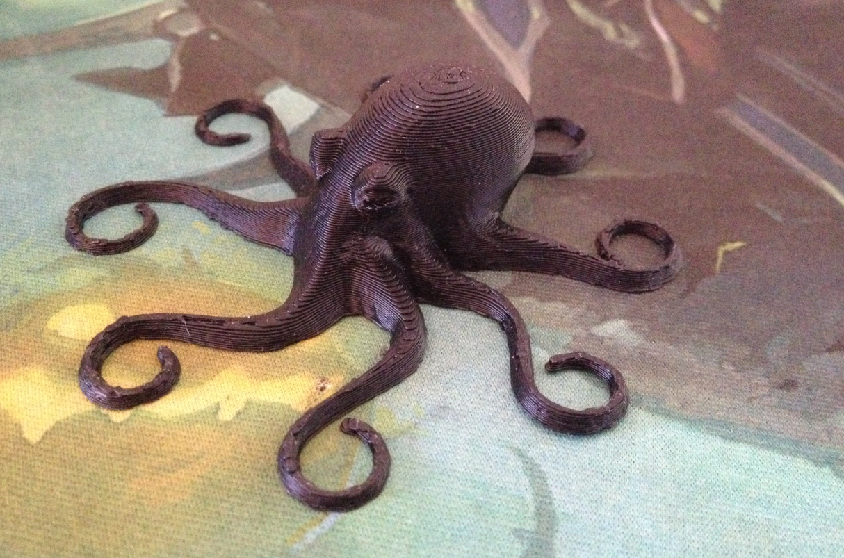

I’ve recently received my Lulzbot TAZ 3 and after calibrating it, and printing the little octopus (not an incredible print, but i think it’s good enough for a newbie: [http://prntscr.com/2p9y2i](http://prntscr.com/2p9y2i)), I’ve tried to go and print a ring I made in Cinema 4D.

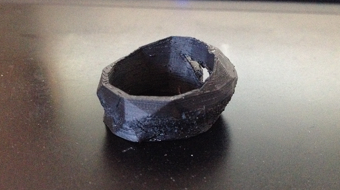

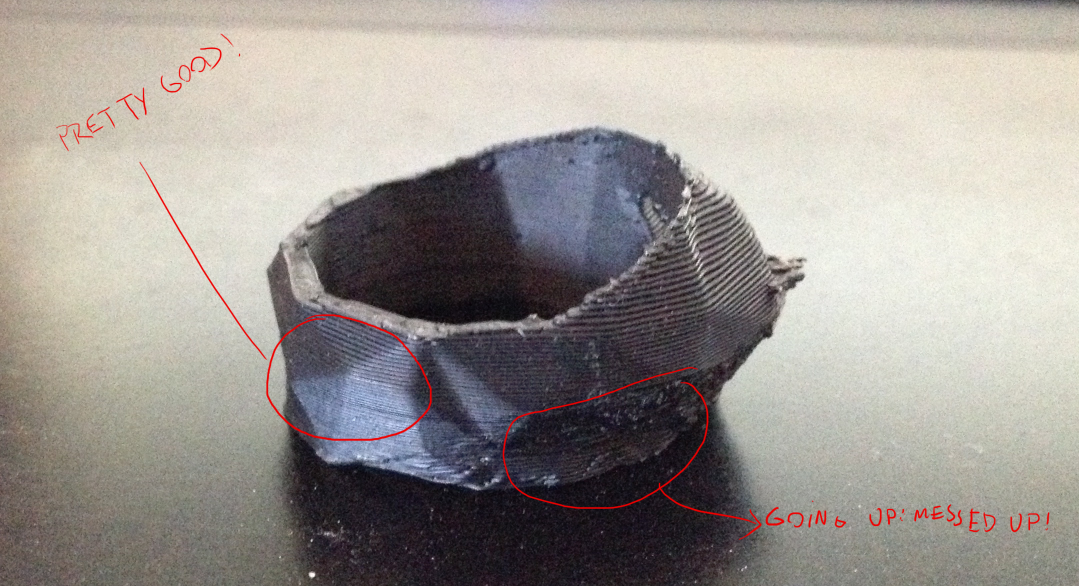

At first, Slic3r had a few troubles but i managed to solve them (even though Slic3r still tells me that there are several issues with the model but it has managed to solve properly). The point is that the upper part of the ring comes up pretty good but the lower part, that has little overhangs, come up pretty messed up.
First test: 235° for first layer - 225 for other layers // 110° heated bed // 0.1mm layer thickness: [http://prntscr.com/2pa1p9](http://prntscr.com/2pa1p9)
Second test: 235° first layer - 230 other layers // 110° heated bed // 0.2mm layer thickness: [http://prntscr.com/2pa3u1](http://prntscr.com/2pa3u1)
As you can see on the second screenshot, the upper/back part of the ring came pretty good, nice “low poly” look and a extremely smooth surface. Just what I expected.

Oh, sorry!
First image:
 ![96nf.jpg](https://us1.discourse-cdn.com/flex020/uploads/lulzbot/original/1X/b979d5d34942ab020ce9a3fa45d166a61585c207.jpeg)
Second image:
 ![ky33.png](https://us1.discourse-cdn.com/flex020/uploads/lulzbot/original/1X/480b28c4ecc85629705801cd4fdc7142bef6fd44.png)
Third image:
 ![uwly.png](https://us1.discourse-cdn.com/flex020/uploads/lulzbot/original/1X/071fca309fe2bb0f7c86e0c8a3c33a612e6f627c.png)
Hope this solves the issue 😛 (never found the upload attachment/place inline functions, weird :S)

**Post date:** [February 4, 2014, 12:44am UTC](https://forum.lulzbot.com/t/abs-plastic-print-tests/452/4 "2014-02-04T00:44:47Z")
That’s a fairly small print, so one thing that might help out is A. upgrading to the 1.0 version of SLic3r if you are using the older version, and 2, there is a setting inside the slicer profiles (I think in the filliament section) that says “Let Slic3r automatically manage your cooling and fans for small parts” or something along those lines. Your starting layer hight also might be slightly off, but looking at the print, it’s probably a combination of the circle bug in older slicer, and the small layer melty issues. Maybe try grabbing the updated ABS profiles in the download folders too if you haven’t already grabbed them.

**Post date:** [February 4, 2014, 2:52am UTC](https://forum.lulzbot.com/t/abs-plastic-print-tests/452/6 "2014-02-04T02:52:49Z")
Yup, that’s them. And the exact setting to try first is the “enable auto cooling” checkbox on the filliament tab cooling section. Check your bed calibration as well, and make sure your first layer height is good. On smaller parts that makes a huge difference in quality of the first layers. If you are too close, basically plastic pressure builds up in the melt chamber and extrudes out the nozzle with excess force at the edges where it has room to relieve pressure. as that release happens pressure normalizes as you go up in layers.
