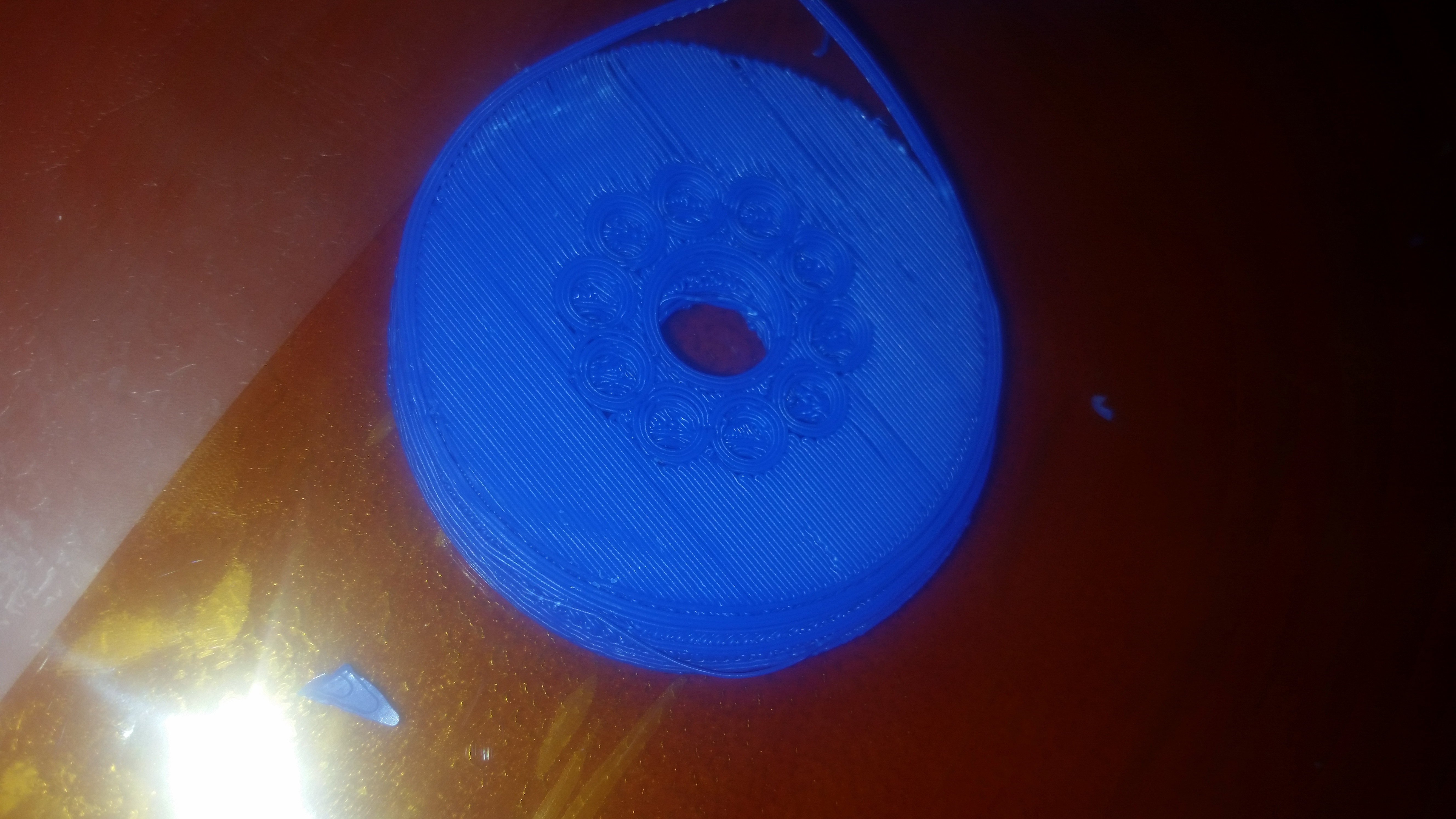

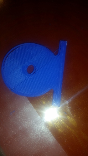

All of my prints seem to slide to the right as the height increases. I’m using ABS, with both Cura and slic3r with temps from 230-258 / 100-110. > This is on a new Taz 5 and anything under 24 delaminates.
Your X axis power train is loose. Check that the belt has proper tension (it should make kind of a thumpy twang sound when you pluck it and should be fairly tight) , and that the 2 setscrews on the X motor drive pulley are all the way down, tight and that at least one of them is lined up with the flat spot on the X motor shaft.
I was just going to add some images, and the shift is actually forward , I. E. Y axis
Oh. Same cause then, but it’s your Y axis, not the X.
I tightened every bolt I could, and the belts. I could not find the right allen wrench for the stepper couplers. >What size are they? I’m trying a new print now using the quick print options in Cura to eliminate setup errors from me.

I got everything tightened up nicely but still had issues. With the steppers off the Y axis , sliding the bed back and front, was really jerky. After a lot of messing around I finally tracked down an issue I have not heard mentioned before, The stepper pulley was pressed down too tightly, binding against the stepper bearing. Raising the pulley slightly fixed it and the bed is now nice and smooth. Can I get the same print speeds with lead screws / ball screws on the X and Y axis?
