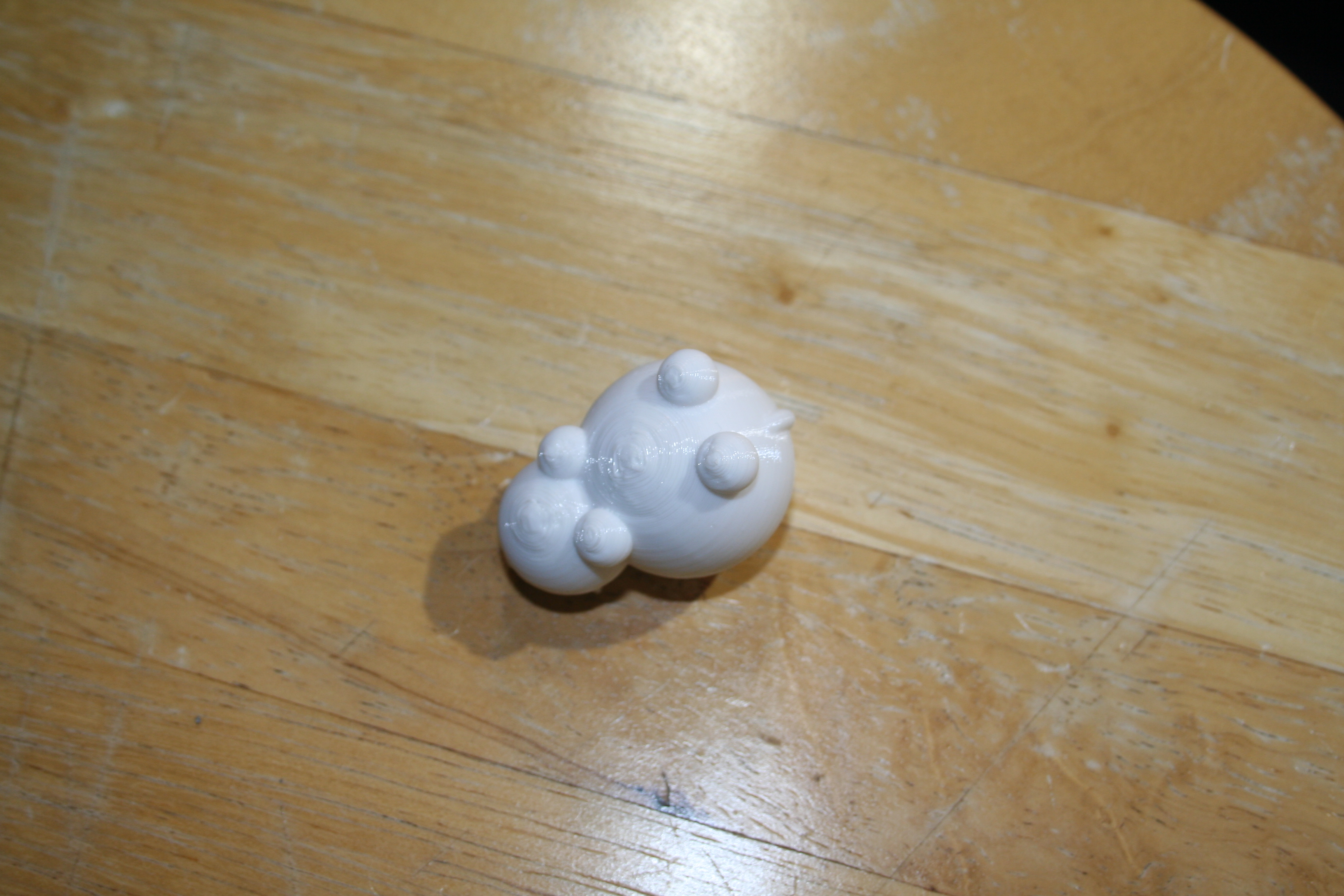

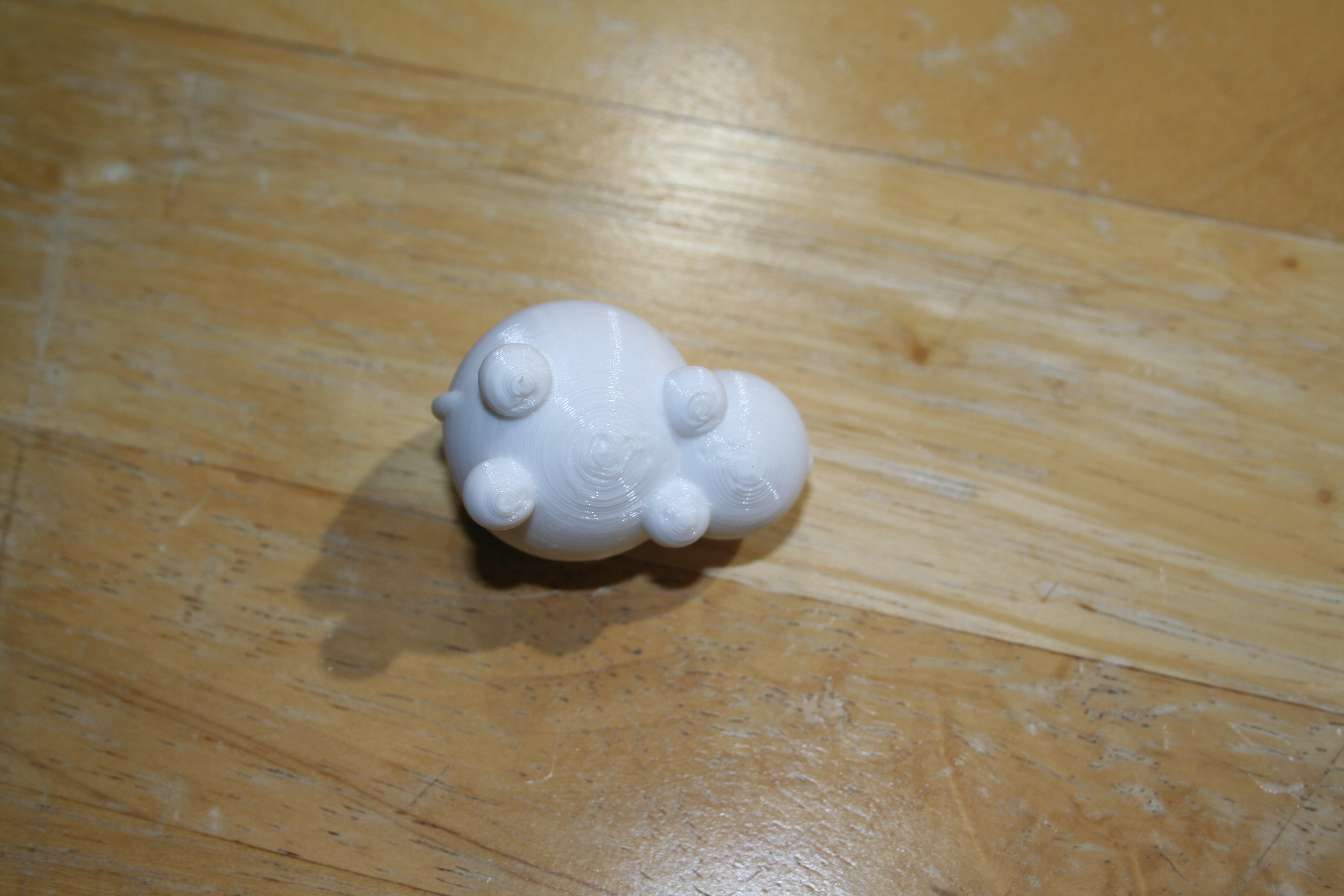

Focusing on the fat cat. First, I’ve only bought one spool of IC3D ABS (in black) and I found that it was much more gooey than eSun’s ABS. I’m not saying for certain that is your problem, but when I look at the underside of the cat, I can imagine that the plastic in that area was still soft and moving around underneath the printhead, especially because that area has such a narrow diameter in those layers. To make matters worse, if your filament is sort of extra gooey, the nozzle will pick up a residue and become sticky and increase the amount those little nubs wobble around.
I’m printing a test of the cat right now in PETG, which is gooier than ABS. Watching the nozzle run over the feet and head low layers, I can see the nubs that are building up wobbling all over the place. I’m stopping it – it’s already looking terrible.
Getting the bottom right is a matter of letting it harden before you put on another layer, otherwise it’ll just wobble into ugliness. So for my second try, I’ve dropped down from 248 to 240 for my nozzle temperature, and from 85 to 75 for my bed temperature. Mind you this is with PETG. With ABS, maybe drop the bed to 100, or even 95, and the nozzle to 235.
In Cura, you can set a minimum layer time which may help. It is in expert settings, advanced tab, under “Cool” heading. I bumped that up to 60 seconds minimum per layer.
I’m using a lot of fan in my unheated garage with PETG because it seems to like the cold. The conventional wisdom with ABS is that you want to use as little cooling as possible because it doesn’t like cold. With too much cooling on ABS, you get layers splitting like in the house model you made. However, for a small piece like the cat, you might actually want to give cooling a try. It probably is small enough to avoid delamination, but getting those bottom layers really solid when they are just nubs so that they don’t wobble around is going to be key. It may take some fiddling to get the balance right between having the first few millimeters solidify, and the larger areas not delaminating.
Also, my first aborted bad version had 4 shell layers. My second more successful one only two layers. I think you want to have the nozzle on the edge of those nubs as little as possible. Anyway, it isn’t perfect (there is still some roughness on the underside) and more fiddling would make it better, but this is my result focusing on what is happening with the nubs (bottom of the spheres) – I cut off the round pedestal so it would be easier to see the bottom. Printed at 0.2 mm layer height:
