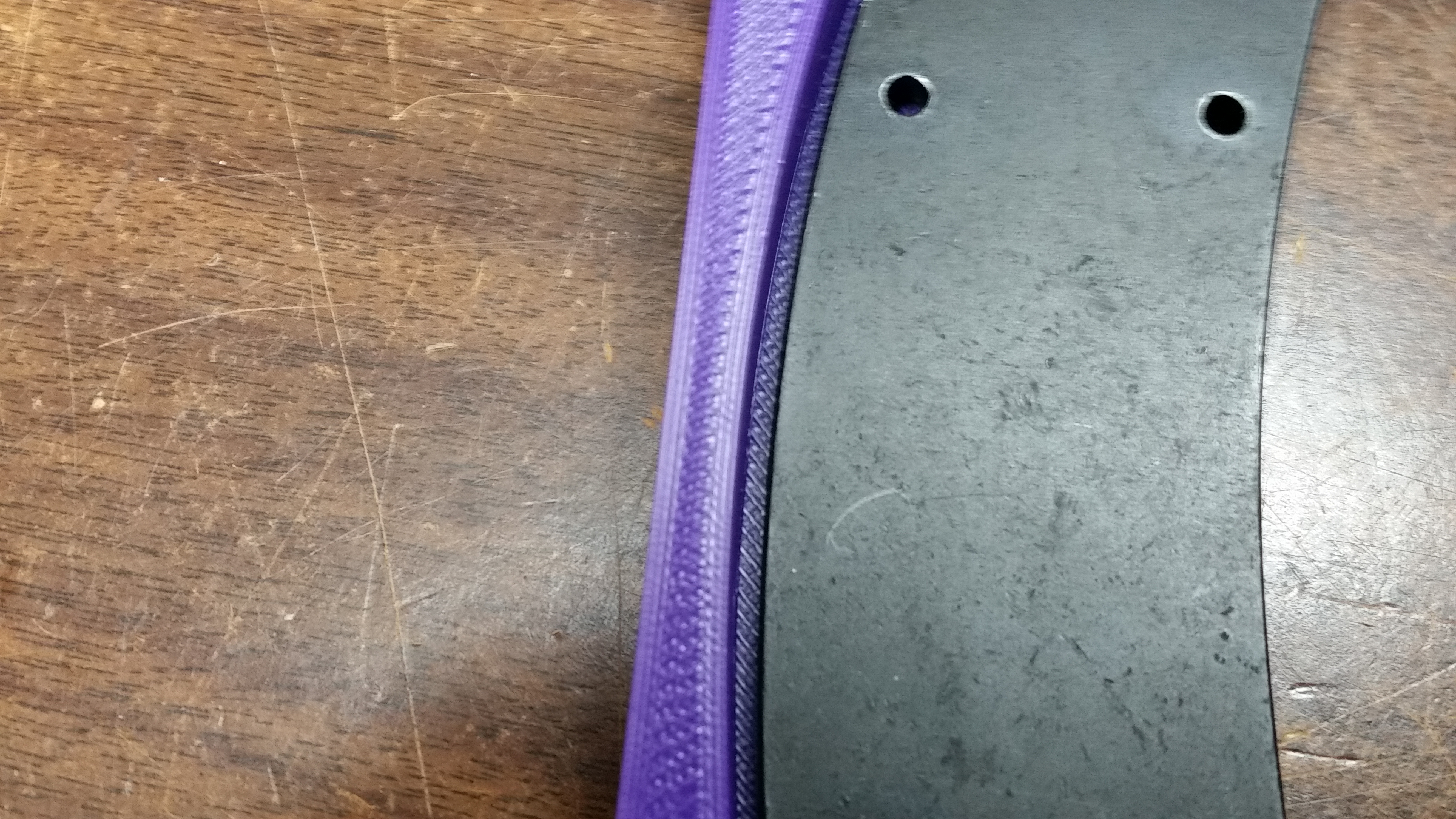

**Post date:** [February 3, 2016, 2:20pm UTC](https://forum.lulzbot.com/t/adding-an-openbuilds-openrail-y-axis-to-a-taz-3-4-5/2019/62 "2016-02-03T14:20:59Z")
Might be due to this gap. It is hitting on both ends but the center is not. I can push the brace down to line up with the holes on the metal plate by bending the plastic brace piece down.
 ![20160203_070029.jpg](https://us1.discourse-cdn.com/flex020/uploads/lulzbot/original/2X/2/2be1e413446cc3afd4198e2b91fae2004dd6fc62.jpeg)
**Post date:** [February 3, 2016, 2:55pm UTC](https://forum.lulzbot.com/t/adding-an-openbuilds-openrail-y-axis-to-a-taz-3-4-5/2019/63 "2016-02-03T14:55:11Z")
Ok, I’ll take a look at it tonight and tweak it a bit. Thanks.
