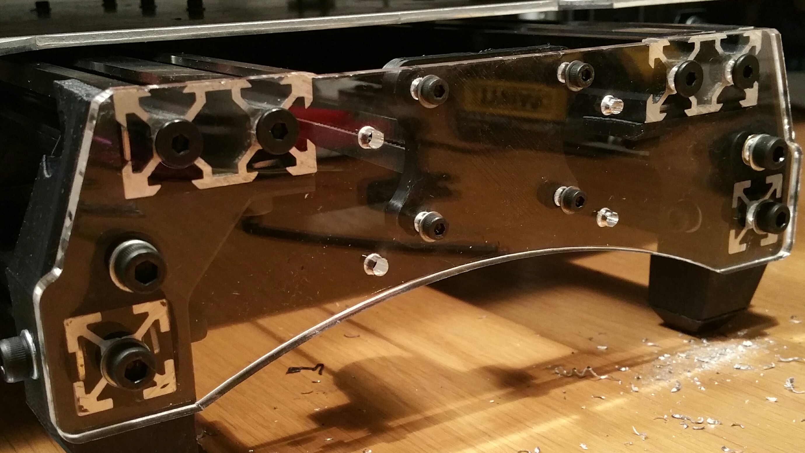

I’m going to attempt to take this and draw it so I can use it. The plan is to cut the endplates out of 1/4 inch acrylic as a flat piece. The ends of the Y rails will need to be tapped M5x1.5 (is that right) I’ll post my progress later.
**Post date:** [February 29, 2016, 11:51pm UTC](https://forum.lulzbot.com/t/adding-an-openbuilds-openrail-y-axis-to-a-taz-3-4-5/2019/117 "2016-02-29T23:51:10Z")
So here is the prototype acrylic y axis combined motor plate. My laser apparently has a tough time with .25" clear acrylic so the edges aren’t great. Once I get my computer back that runs the cnc router I’ll make one on it. This seems as though it will work though.
 ![1456789738200-172640515.jpg](https://us1.discourse-cdn.com/flex020/uploads/lulzbot/original/2X/8/81b9527cb9fec671d335db419e2ca386a1759c05.jpeg)
