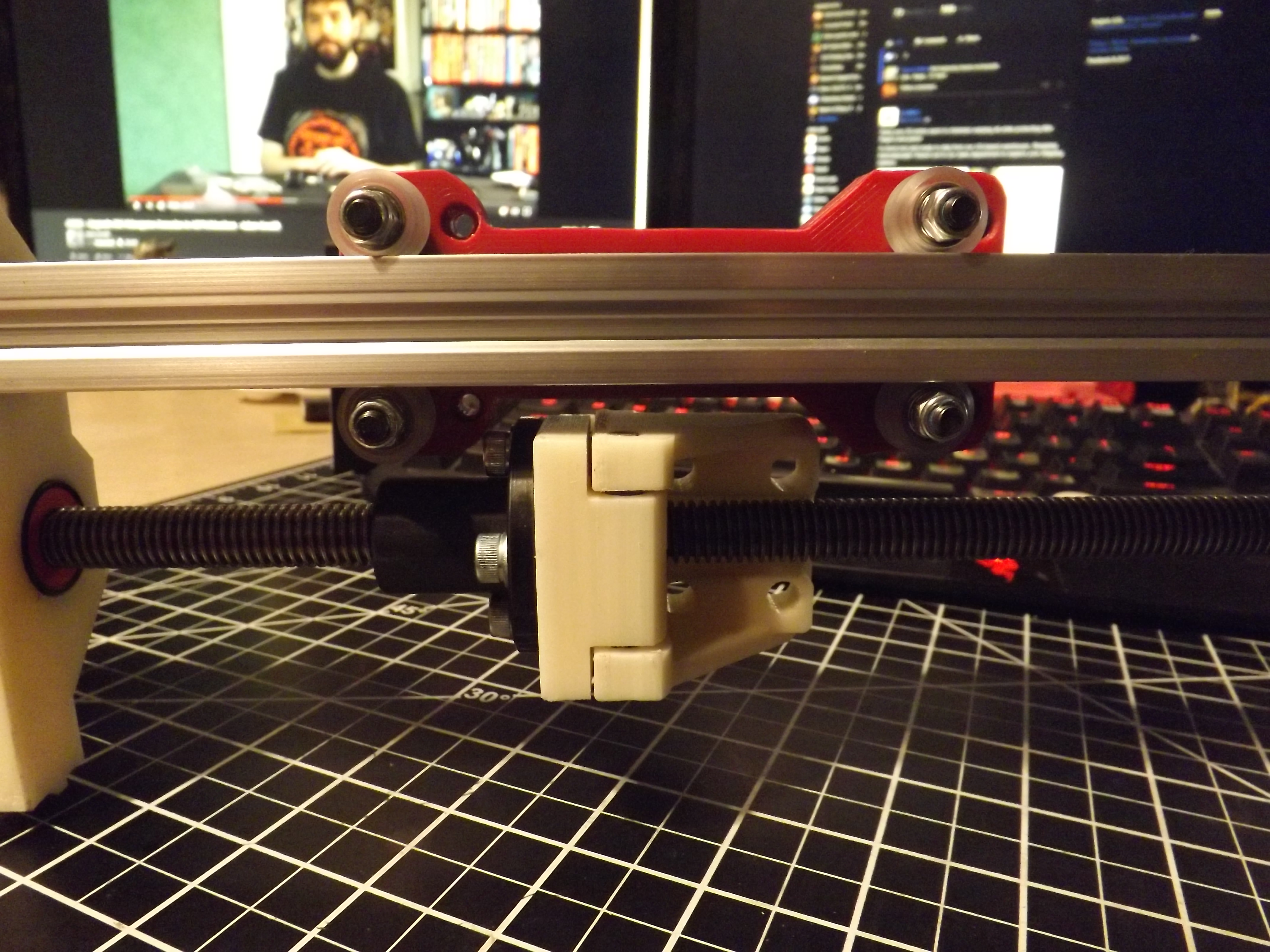

thought I’d post some pics of my progress everything looks to be ready to go on.
 ![DSCF1384.JPG](https://us1.discourse-cdn.com/flex020/uploads/lulzbot/original/2X/3/39853c0ecbfa3c019280c25770cda9281e03e741.jpeg)
 ![DSCF1383.JPG](https://us1.discourse-cdn.com/flex020/uploads/lulzbot/original/2X/4/4ec82a15750201a7315a8f63beaf75471eaa22b3.jpeg)
 ![DSCF1382.JPG](https://us1.discourse-cdn.com/flex020/uploads/lulzbot/original/2X/3/3a92cea8c2f67f472d620db128ce48b78a51d017.jpeg)
 ![DSCF1381.JPG](https://us1.discourse-cdn.com/flex020/uploads/lulzbot/original/2X/a/a76feb8bb352ad8c930ca54d4feff96288754da9.jpeg)
 ![DSCF1380.JPG](https://us1.discourse-cdn.com/flex020/uploads/lulzbot/original/2X/8/8ac476d431c38c6e504dfab493e3da1ef4ddb30f.jpeg)
 ![DSCF1379.JPG](https://us1.discourse-cdn.com/flex020/uploads/lulzbot/original/2X/d/dd5a9739f85cff1955bd7005b48f2752b9e5cbed.jpeg)
**Post date:** [February 12, 2017, 10:29am UTC](https://forum.lulzbot.com/t/adding-openrail-z-axis-to-a-lulzbot-taz-4-5/2108/46 "2017-02-12T10:29:12Z")
Nice! which micrometer body did you end up using there? I’m looking for a model number I can add to the bill of materials for that project.
Also, what kind of Taz is this going on? if you’ll be installing this on one with a Taz 3 control box, you may find the cable path covers project also of interest [http://www.thingiverse.com/thing:1708977](http://www.thingiverse.com/thing:1708977) It’s still somewhat useful with a Taz 4/5, but less so as the control box inputs are in different spots.
**Author:** ![Darth\_Novan](https://avatars.discourse-cdn.com/v4/letter/d/ba8739/32.png) [@Darth\_Novan](https://forum.lulzbot.com/u/Darth_Novan)\
**Post date:** [February 12, 2017, 11:22am UTC](https://forum.lulzbot.com/t/adding-openrail-z-axis-to-a-lulzbot-taz-4-5/2108/47 "2017-02-12T11:22:24Z")
This is going on a Taz 5 and I have those printed out and ready to go on as well. The micrometer i use is a Mitutoyo 148-507 Micrometer Head that I got off ebay here is the link.
[http://www.ebay.com/itm/Mitutoyo-148-507-Micrometer-Head-/272545647656?hash=item3f74fc8c28](http://www.ebay.com/itm/Mitutoyo-148-507-Micrometer-Head-/272545647656?hash=item3f74fc8c28)
