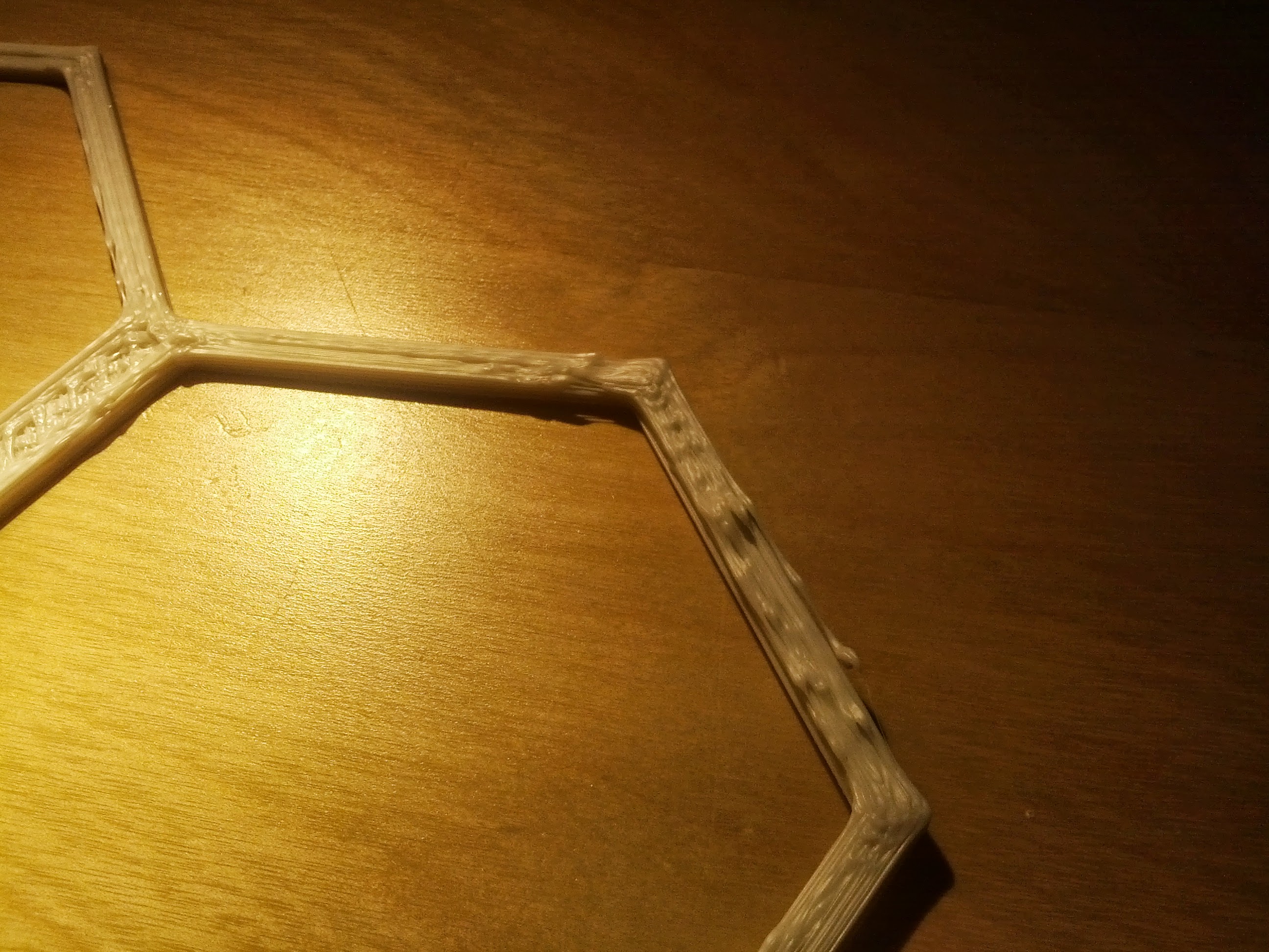

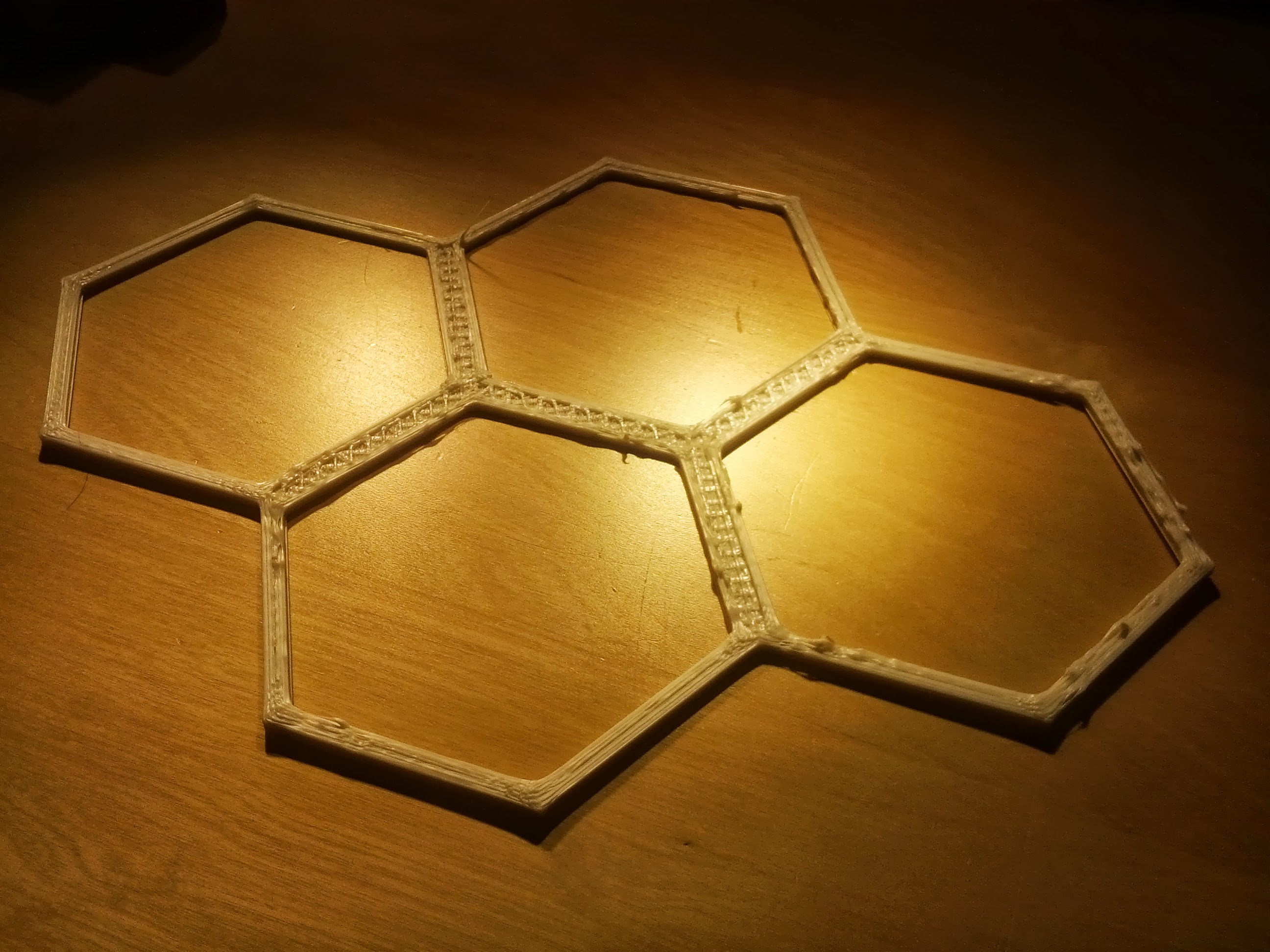

I started with the Taz “high\_speed.ini” - after all, the whole point of this was to quickly print something big, with no care for fine details. I looked at ([http://nathan7.eu/stuff/RepRapCalculator/RepRapCalculator.html](http://nathan7.eu/stuff/RepRapCalculator/RepRapCalculator.html)) which led me to also adjust the layer height (0.4 at first) and fired it up. My first prints looked like this:
 ![IMG_20130731_084419.jpg](https://us1.discourse-cdn.com/flex020/uploads/lulzbot/original/1X/ec275fe0284987440684b3026ed5c7e1585b40a4.jpeg)
 ![IMG_20130731_084424.jpg](https://us1.discourse-cdn.com/flex020/uploads/lulzbot/original/1X/f876c53e7ae1d9b2eeb4aefa9f14a832cab99d6b.jpeg)
Promising at the start, but with way too much solid infill, and after a layer or two, things started getting really ugly: uneven, poorly adhering strands of ABS that were full of beads and gaps. I might have already recognized what was going on, but it didn’t dawn on me immediately. Google didn’t turn up a lot of people printing at 0.75mm, but the folks at Aleph have always been incredibly patient and helpful, and also good at teaching me to fish. They sent me to [http://richrap.blogspot.com/2012/01/slic3r-is-nicer-part-3-how-low-can-you.html](http://richrap.blogspot.com/2012/01/slic3r-is-nicer-part-3-how-low-can-you.html) and [http://reprap.org/wiki/Print\_Troubleshooting\_Pictorial\_Guide](http://reprap.org/wiki/Print_Troubleshooting_Pictorial_Guide) - the extensive discussion of speed finally getting me to notice my extruder temperatures in pronterface, which looked something like this, but worse:

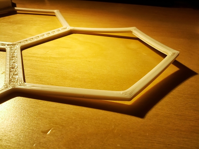

I was simultaneously trying to up my nozzle temperature. At 250C, I got immediate errors out of the printer. It obviously did not like getting that hot. OK, I only tried it because the manual claims there’s a 215-250C range for printing ABS (page 46)… OK, let’s try 245. At that temperature, what I found was that I could print for a while, but was liable to see a temperature-related shutdown in mid-print, since the temperature fluctuations based on speed could swing me up to 250C again. So, 240C. Now I was getting far enough to see my prints failing because of warping. Even with ABS/acetone solution, I’m coming off the bed something awful:
 ![IMG_20130803_112240.jpg](https://us1.discourse-cdn.com/flex020/uploads/lulzbot/original/1X/e85d11c93a156211a33d1ca8a7f36fe75df88b37.jpeg)

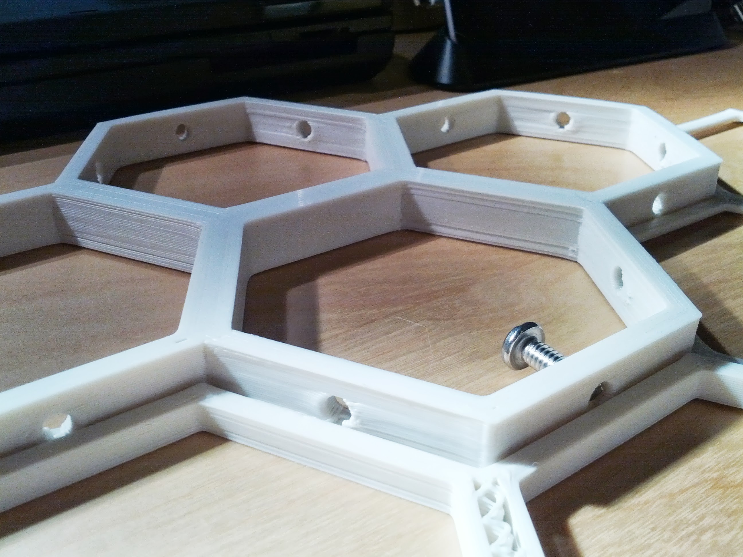

I bump the bed temperature from 85C to 110C (this has helped with warping in the past), and, checkmate. I’m knocking these out.
 ![IMG_20130803_112300.jpg](https://us1.discourse-cdn.com/flex020/uploads/lulzbot/original/1X/b24de11832f881f802cb62903857ee295db15dde.jpeg)
It’s very big, and yet it prints in about an hour. As many of these as you like can be held together with 0.25" x .75" stove bolts for whatever purpose.
