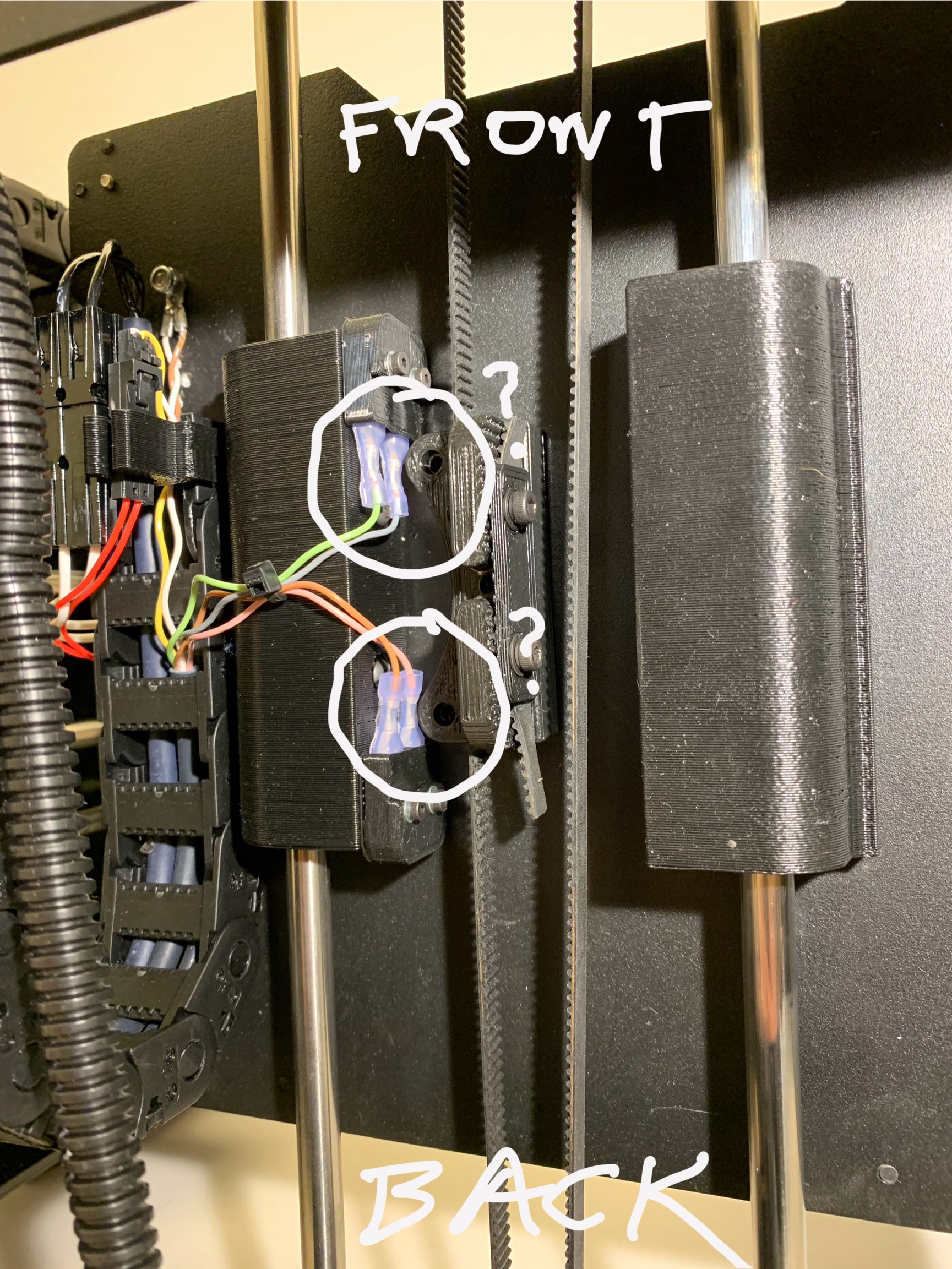

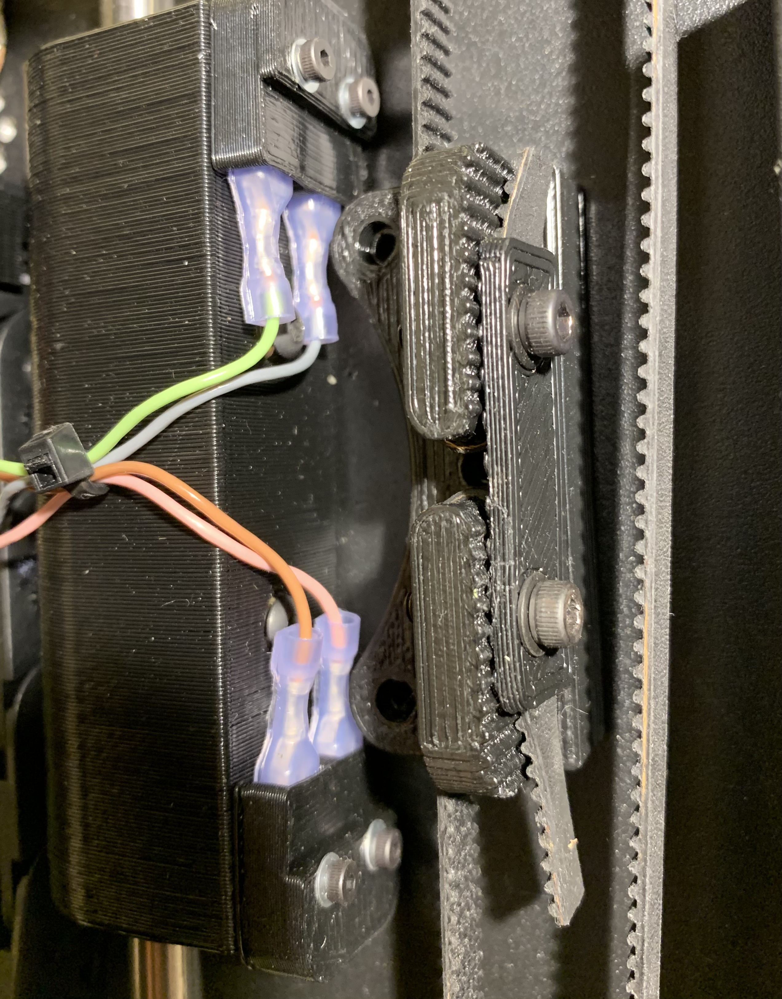

I’ve looked back through the OHAI Bed Plate Assembly Workflow and can find nothing that is wrong with my reassembly unless… I’ve mounted the Y bumpers (front/back) incorrectly or messed up the electrical connections (positive/negative). Not finding pictorial or wiring documentation online to help figure this out.

The Mini2 uses sensorless homing, so those vestigial wires don’t connect to anything.
Can you confirm that the bumpers are contacting when homing, or is something else catching and causing it to stop?

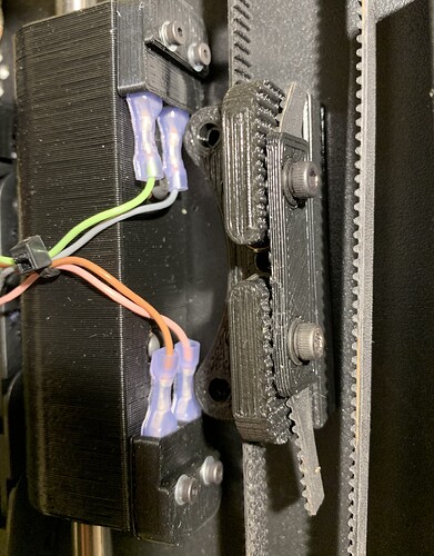

Can’t find an obstruction. Have disassembled again. When a couple of parts arrive I will carefully follow the Ohai assembly instructions.
My bearing holders house 2 each side. At what point did they move to a single bearing one side?
