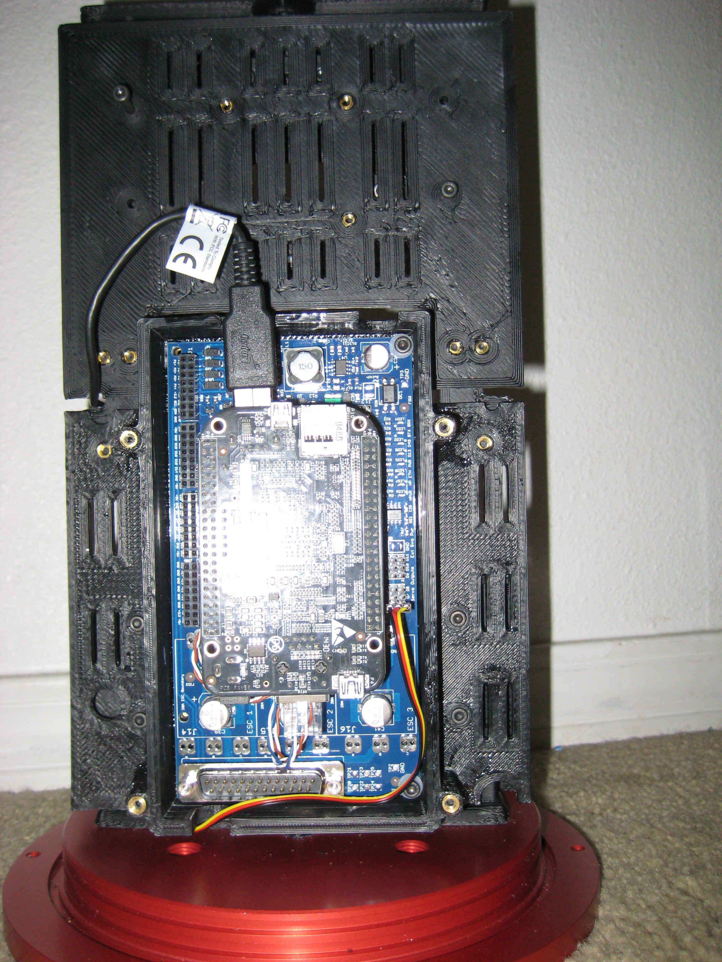

The Brain is mostly done! It’s basically a 3d printer controller with a beaglebone black attached on top. All the black plastic bits were made on my TAZ. 40 heat set inserts, about 2 and a half pounds plastic, one servo and all of the M3 bolts in Washington.
