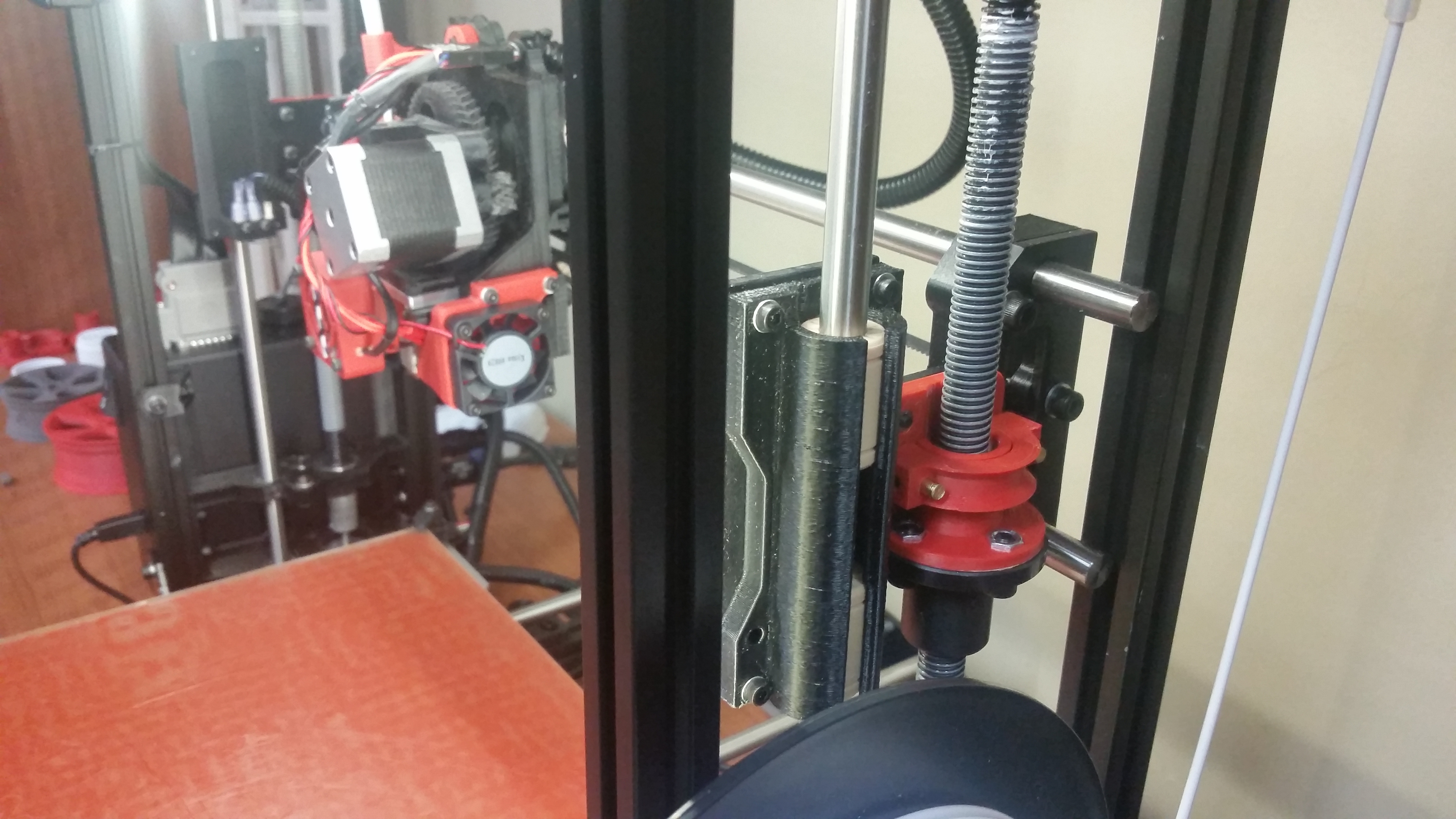

Like piercet, I have some Z-wobble in my parts and I want to have a solution for this. You can find his solution [here](https://forum.lulzbot.com/t/show-off-your-printer-and-printing-station/48/1). First, I wanted to use his version, but I run into some problems: He uses additional hardware in Inches which is not available in Europe and other things like the bushes I can’t order here.
So I started thinking how such a device can be built in a more easy way, and maybe also smaller… And I got it!
My first attempt was something like a cardanic joint with the possibility of side movement (same principle as piercet, but all axes in “one” part). A great device, but not enough space on the TAZ…
Now I’m using a spiral to allow the z-nut to flex a little bit. All hardware necessary is 6x M5 nuts and 8 M3 nuts. Not perfect, but a hughe improvement and simple solution 🙂 See pics attachet for comparison. I think I can make it even better in the future, but as for now am satisfied.
Of course there is a small drawback. With original mounts, I measured 0.01mm Z backlash. Now, I have 0.02mm. But thats only important if you use Z-hop on retract which is always a bad idea (in my opinion) so no real problem…

Neat solution! I like the compactness of it

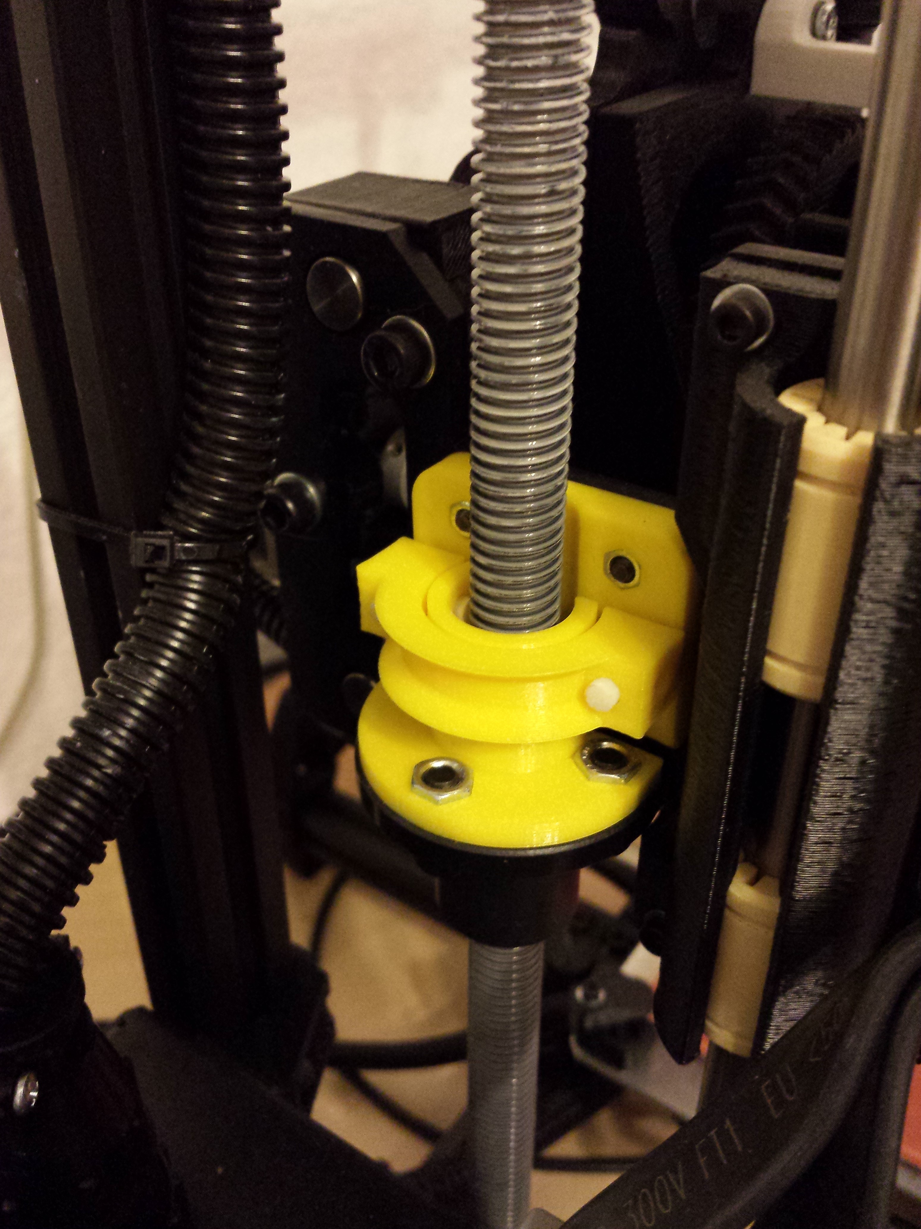

I replaced my spring-type parts with a slider version. It’s a kind of merged together Z-Nut bracket and the cardanic joint I wanted to use in the beginning. Still not perfect, I’m thinking about version 7…
But at least it looks cool 😆

You need 6 M5 nuts, 8 M3 nuts and a rod of 4mm diameter (thats what you see white in my pictures). I used a GRP rod because it slides quite well, normal steel should be also OK.
But I think you also have to exchange the bearing at last on the Z axis. The best anti wobble device can’t do anything if you bearings have play as the originals have due to bad bearing holders.
I’m using my yellow version with Igus RJUM-01-10 bearings with good results 🙂

Nothing should have contact to the z screw. The 4mm rod is only a sliding connection. You have to bore out the holes carefully: the two rod pointing along the x axis should stick inside the holes of the bracket mounted on the x axis but slide in the holes of the slider part.
The two rods pointing along the y axis should stick inside the holes of the slider part and move nicely inside the bracket mounted to the z nut.
