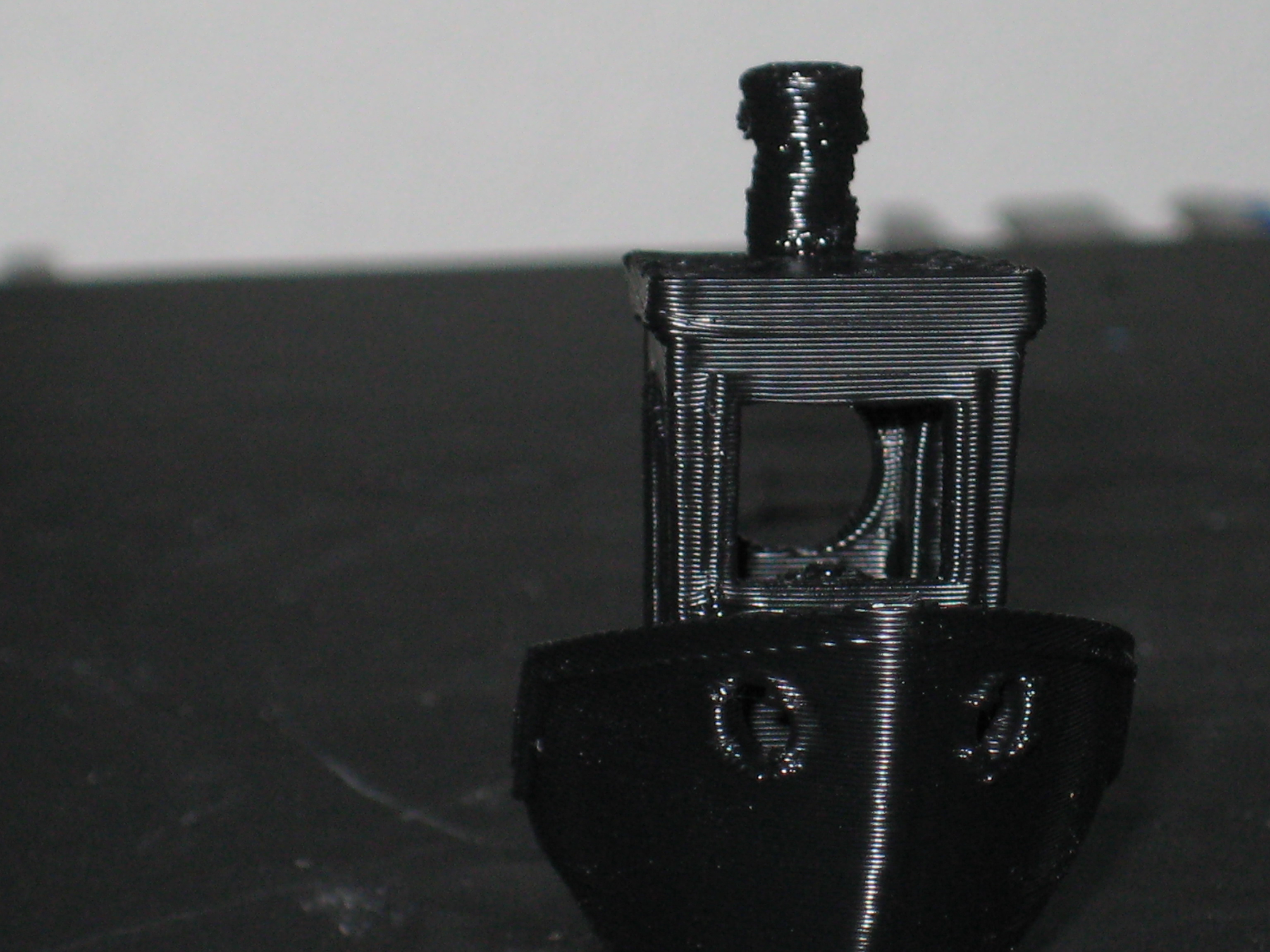

Is this picture an example of what the anti z wobble z nut is meant to eliminate?
edit: In response to piercet. The z-banding does line up with the threads on the lead screws.

**Post date:** [November 24, 2015, 6:56pm UTC](https://forum.lulzbot.com/t/anti-z-wobble-z-nut/2064/24 "2015-11-24T18:56:40Z")
Yes. If you hold the boat up against your leadscrews next to the cabin pillar, you will notice that the wavy pattern lines up fairly close to the threads of the leadscrew itself. If they don’t line up, it’s a different issue, usually related to layer height or periodic extruder slipping.

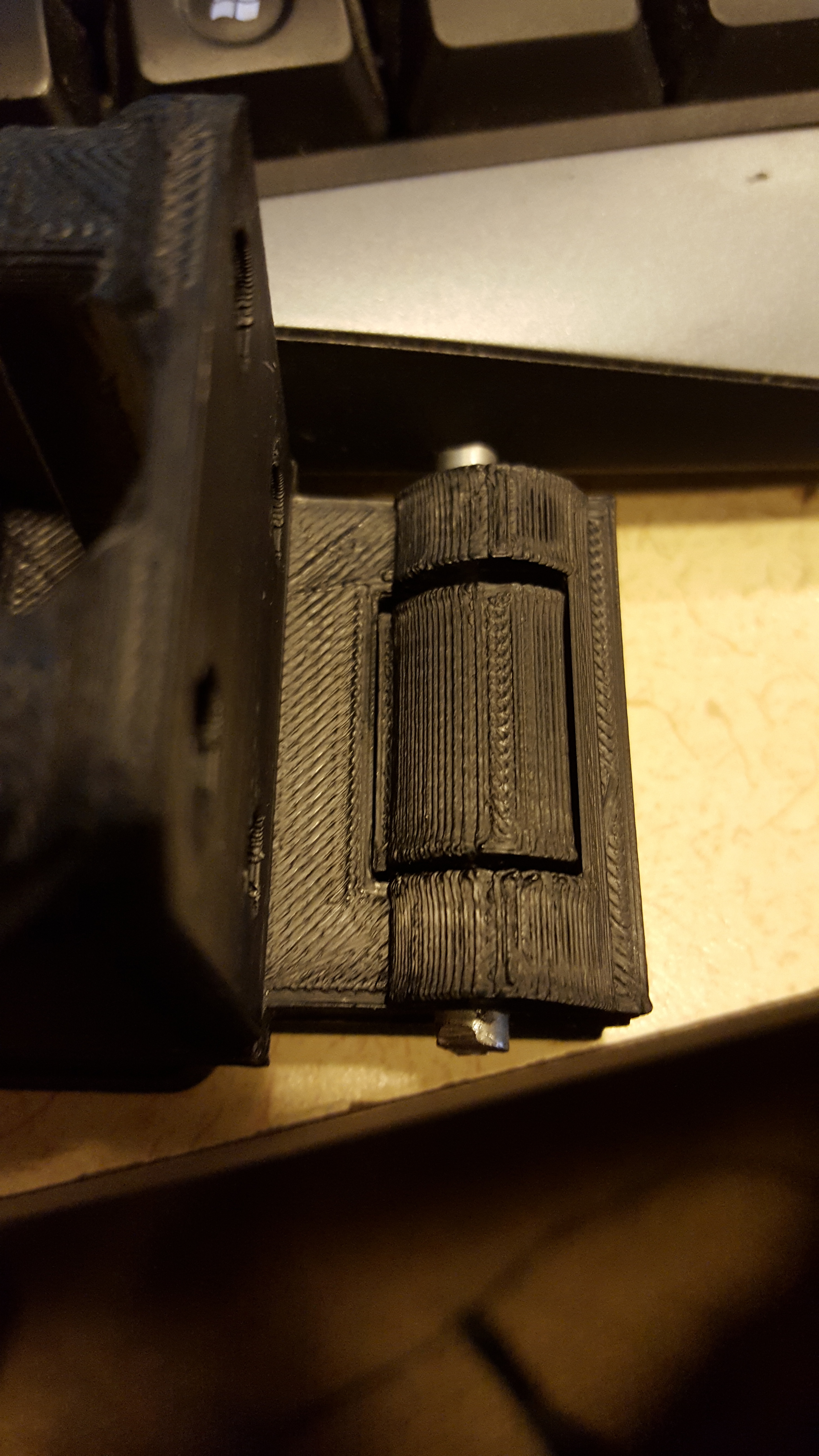

**Post date:** [June 9, 2016, 1:23am UTC](https://forum.lulzbot.com/t/anti-z-wobble-z-nut/2064/40 "2016-06-09T01:23:23Z")
I’ve printed out the parts for this and have started piecing them together. When testing the steel pins in the bearings in the lower assembly, they moved back and forth with little effort. However, once I put the upper assembly piece on and stuck the pins through, the parts take a bit more force to move and don’t seem to float very freely. Is this normal? My assumption is that the upper and lower assemblies are rubbing together and that’s causing this issue because this is the only area where the 2 parts are in direct contact. If it’s not intended, I’ll likely just pull the 2 halves apart and do some light sanding.
Edit: Attaching picture
