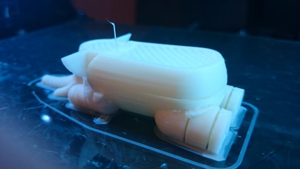

Hi all,
just got my Taz 4 and i dont know why i get wierd craks in my print… is it that i have not calibrated the bed right or
why does it crack like this, the octypus was really nice print.
i have no clue how to fix the problem.
using the slic3r (using the fast settings from lulzbot page )
![](http://imagizer.imageshack.us/v2/150x100q90/537/TwKNzH.jpg)
//bre
**Post date:** [August 27, 2014, 3:32pm UTC](https://forum.lulzbot.com/t/any-one-know-why-this-happens-using-abs/796/2 "2014-08-27T15:32:46Z")
It’s room temperature and air movement most likely. ABS tends to cool unevenly, which can cause cracks along the layers. This is especially a problem if you have your printer located in an unheated garage. You can print things inside of an enclosure (even a large cardboard box will work for this). and that will help. Other options include moving the printer into a heated area if it isn’t already.
Post some pictures of the prints here and we can see if there is anything else going on there.

thank you for the fast replay 🙂 , i had my window open its quite close to the printer, ill try to print it again but with the window closed this time,ill let you know when its printed again 😃

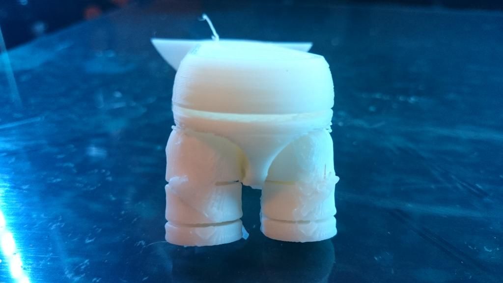

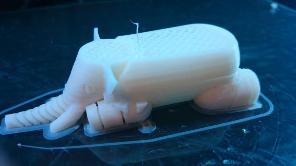

tryed again now with the window closed, same result… halfway up it start cracking
is it advisable to print with out the fan on, so it dont cool to fast seems it cracking from the “fan” side ?

For ABS you definitly want the fan off unless you are printing a very small part, an overhang, or bridging.

ty, was much better print without the fan, looks much better now 😃
