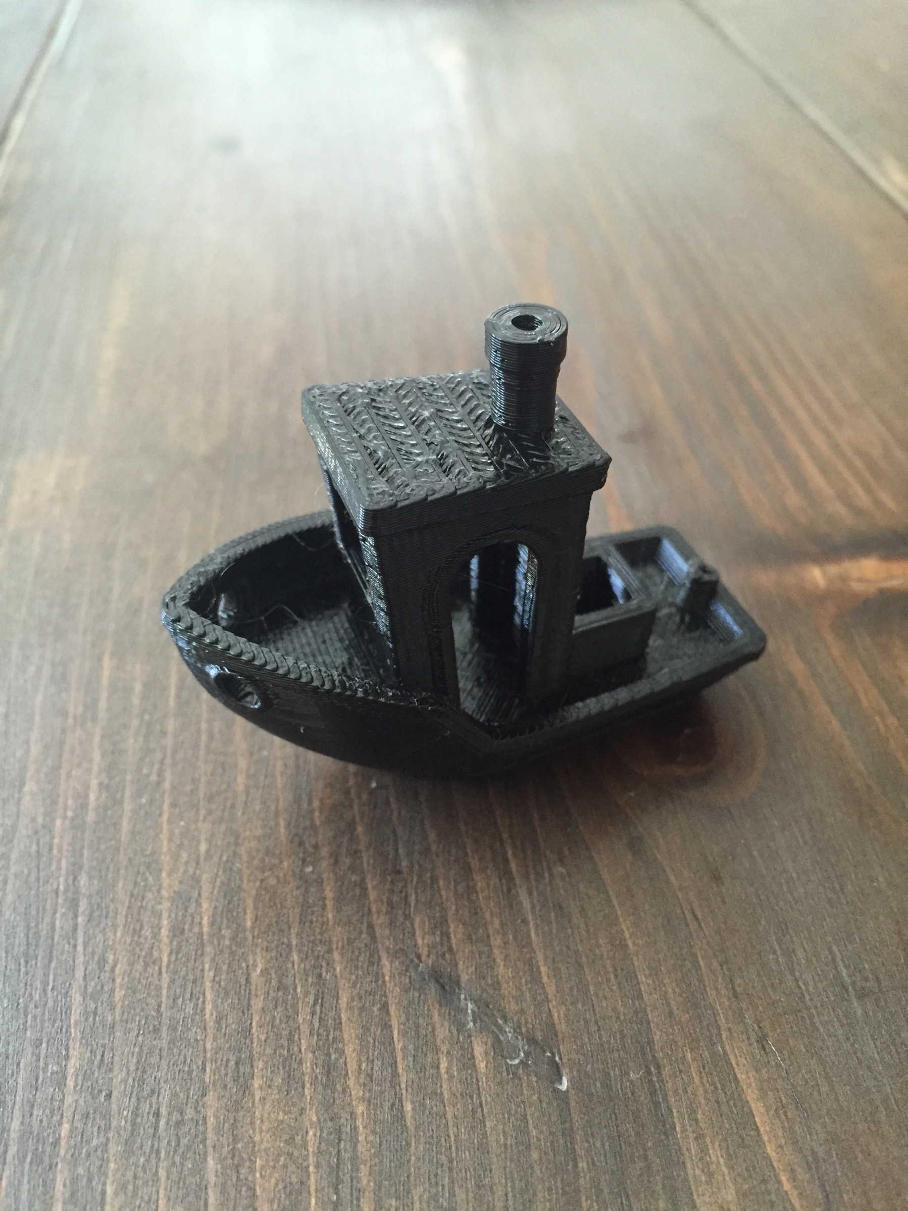

Having issues with spotting initial layer using nGen as you can see in the photos. The top looks perfect but the side that was on the build plate looks as if it is not filled in well. Any tweaks?
Thanks,
Chris

**Post date:** [April 9, 2016, 3:21am UTC](https://forum.lulzbot.com/t/any-taz-5-ngen-users-out-there/3264/2 "2016-04-09T03:21:48Z")
Increase initial layer line width? Lowering the nozzle by .1 should increase squash, and fill the gap between lines… but this could increase adhesion to the bed.

A likely cause for narrow first-layer extrusion is that the z endstop is set too high. Another possibility is that the filament was slipping in the extruder, potentially because it was too cool when the print started. The first layer prints OK if your printer is set-up correctly.
