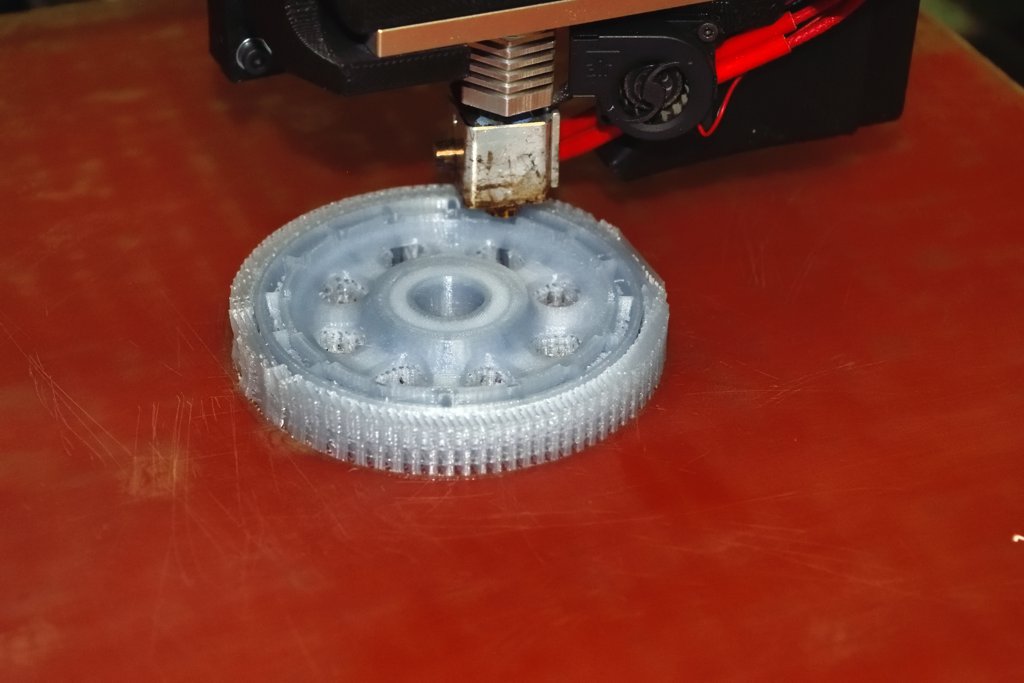

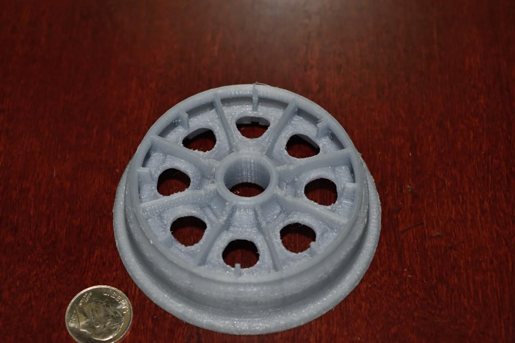

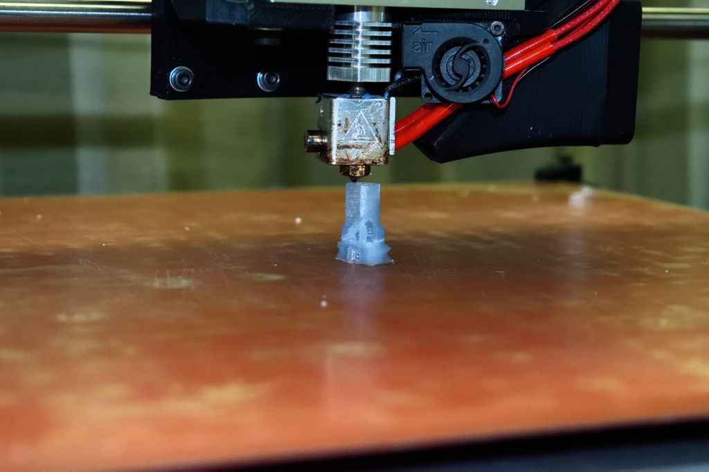

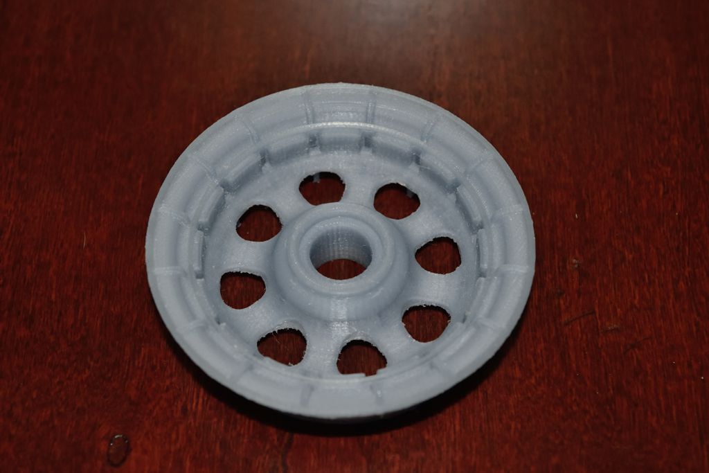

Here’s my first prints with Moldlay. I used a .08mm layer height with a .25mm nozzle.
The first is a print of the rook used by formlabs as their test print.
The second is a print of a half wheel in progress, the third is the finished top, and the fourth is the bottom with the support material removed and the part cleaned with a very small chisel and the rougher edges cleaned with a small diamond file.
It seems to be pretty good at these high resolutions, but certainly not as clean as ABS. The plastic feels tougher and more elastic compared to ABS. It’s heavier too. It is very prone to fine strings. I was able to print directly on the PEI with a nozzle temp at about 179c and the bed heat turned off. When I printed the rook, I noticed a little lifting. When I printed the wheel, I used a brim. With this particular part, the brim was attached to the support material.
Once done, the part removed easily from the bed. I restarted the print if I had any adhesion problems, cleaning the bed with alcohol.
Removal of the support was easier than with ABS, but final cleaning of the surface is harder and not as smooth of a final surface finish.
I should also note that I had switched from ABS and had done a purge of the tip with the Moldlay at 240c with no problems.
