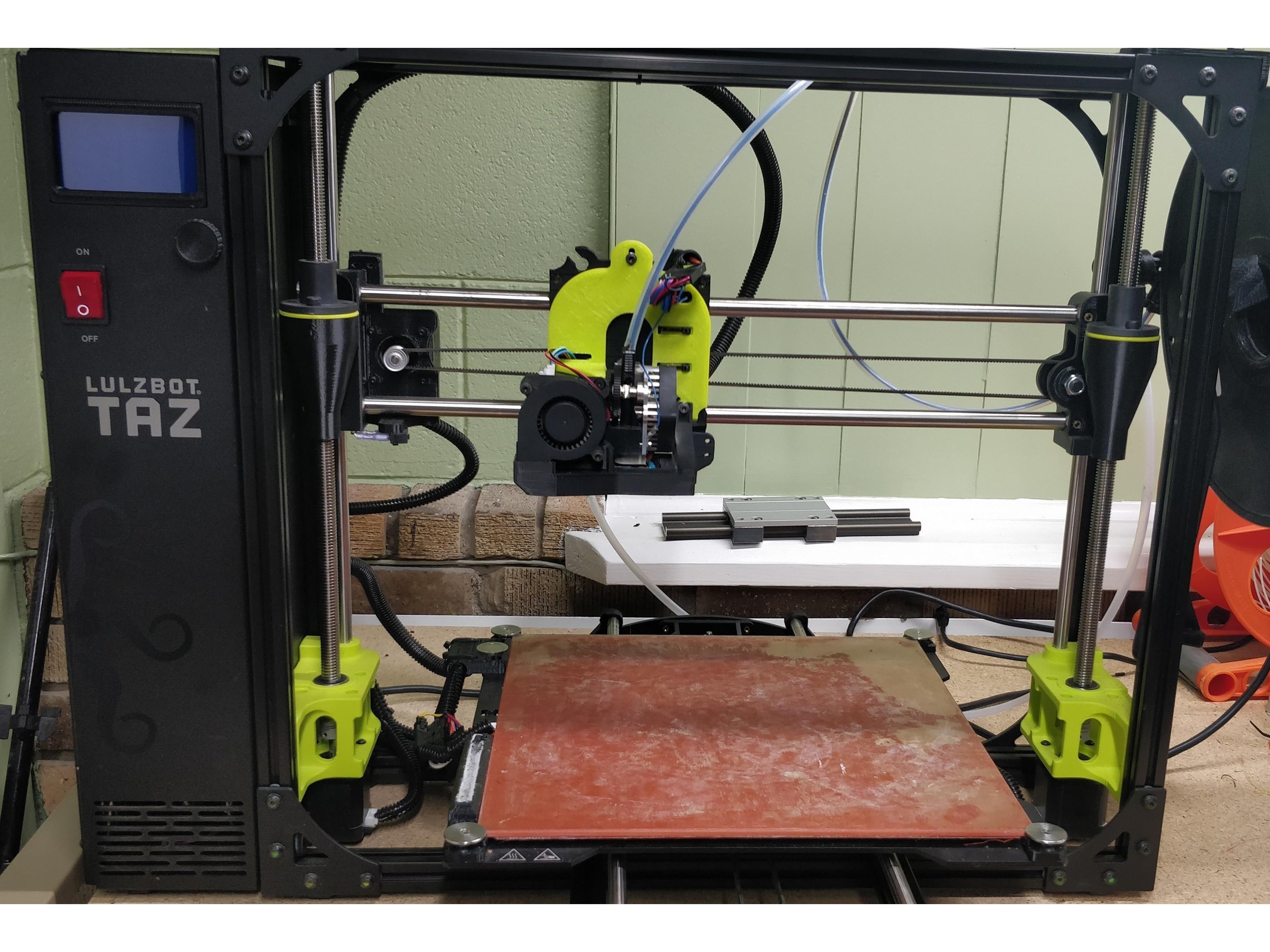

With the onset of the new E3D Hemera anyone thought of mounting one on Taz 6 im about to buy one and share some thoughts on fitting it…
**Post date:** [December 12, 2019, 1:55pm UTC](https://forum.lulzbot.com/t/anyone-thought-of-installing-e3d-hemera/7068/2 "2019-12-12T13:55:44Z")
E3D has a Taz 6 mount ready to go.
> **[LulzBot Taz6 Hemera Upgrade](https://e3d-online.dozuki.com/Guide/LulzBot+Taz6+Hemera+Upgrade/123)**
> Add a Hemera extruder to your LulzBot Taz6
**Author:** ![B-Hep-Spring](https://avatars.discourse-cdn.com/v4/letter/b/c77e96/32.png) [@B-Hep-Spring](https://forum.lulzbot.com/u/B-Hep-Spring)\
**Post date:** [December 30, 2019, 6:58pm UTC](https://forum.lulzbot.com/t/anyone-thought-of-installing-e3d-hemera/7068/3 "2019-12-30T18:58:00Z")
in the process of doing said bracket the wiring is not strait forward got all the connectors and the hemera (24v) ordered that because I thought the Taz was 24 v Heat sink fan for Taz 5v (e3d supplied 24v) and the blower fan is 24v (lulzbot) so now I have to source a new heatsink fan and a new Blower fan
**Author:** ![tanoshi](https://avatars.discourse-cdn.com/v4/letter/t/bb73d2/32.png) [@tanoshi](https://forum.lulzbot.com/u/tanoshi)\
**Post date:** [January 1, 2020, 7:17am UTC](https://forum.lulzbot.com/t/anyone-thought-of-installing-e3d-hemera/7068/4 "2020-01-01T07:17:26Z")
I’m on a TAZ 5 but I got mine working. Not sure which version of the RAMBo board TAZ 6 comes with but on mine the blower was connected to the pins labeled PWM so I simply pulled it out and plugged it into the X30 pin which is 24v (aux power out).
**Author:** ![ajrobertsx](https://avatars.discourse-cdn.com/v4/letter/a/f4b2a3/32.png) [@ajrobertsx](https://forum.lulzbot.com/u/ajrobertsx)\
**Post date:** [May 22, 2020, 12:31pm UTC](https://forum.lulzbot.com/t/anyone-thought-of-installing-e3d-hemera/7068/5 "2020-05-22T12:31:18Z")
Sorry if this is a redundant post. Anyone have reaction to this? Easier to use? Works better?
**Post date:** [May 22, 2020, 12:51pm UTC](https://forum.lulzbot.com/t/anyone-thought-of-installing-e3d-hemera/7068/6 "2020-05-22T12:51:08Z")
already done it working well
**Post date:** [May 26, 2020, 12:39pm UTC](https://forum.lulzbot.com/t/anyone-thought-of-installing-e3d-hemera/7068/7 "2020-05-26T12:39:16Z")
I have one running on a Taz 2. It has been working flawlessly. As soon as it comes back in stock, I will be replacing several more toolheads with Hemera.
