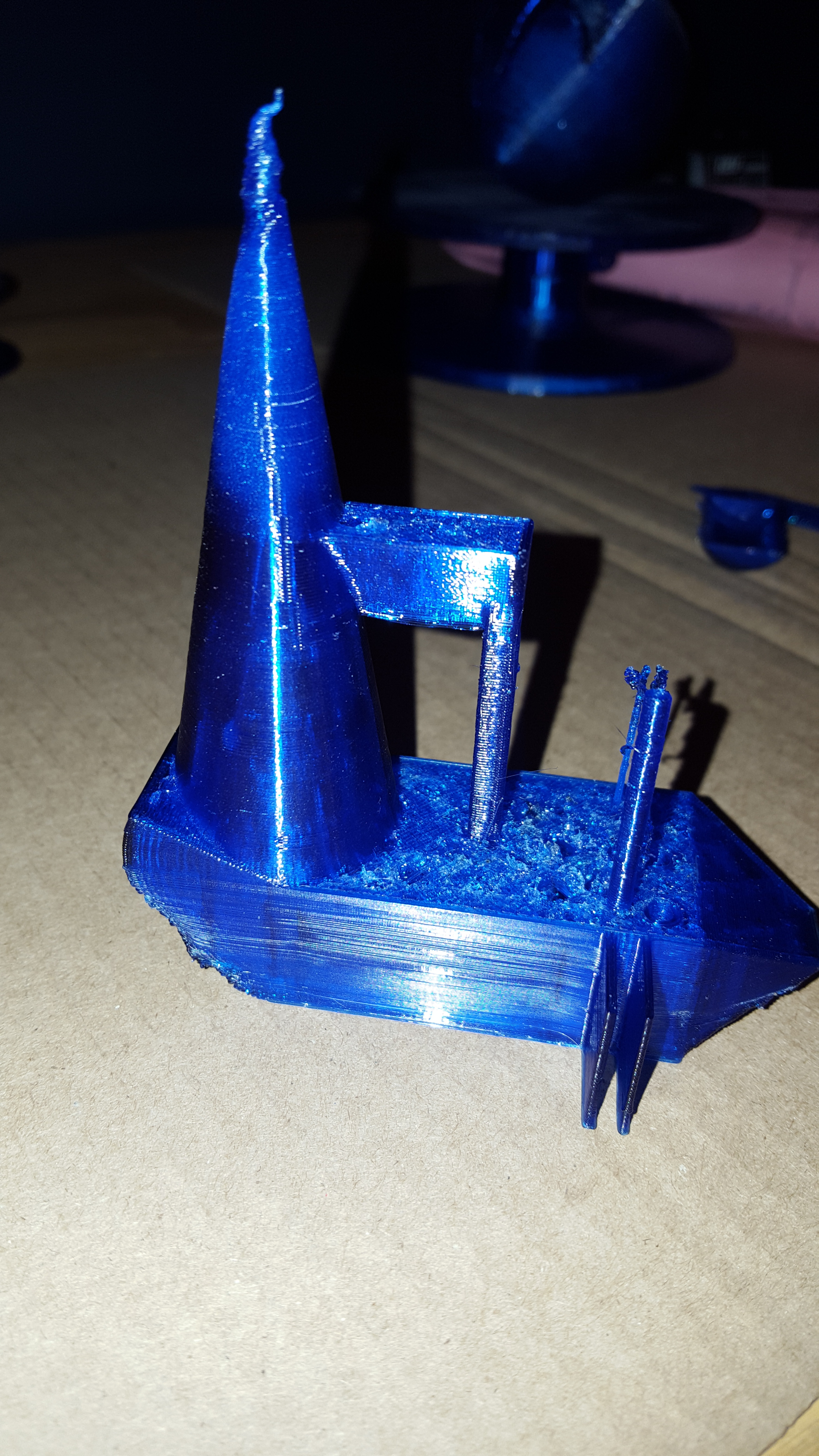

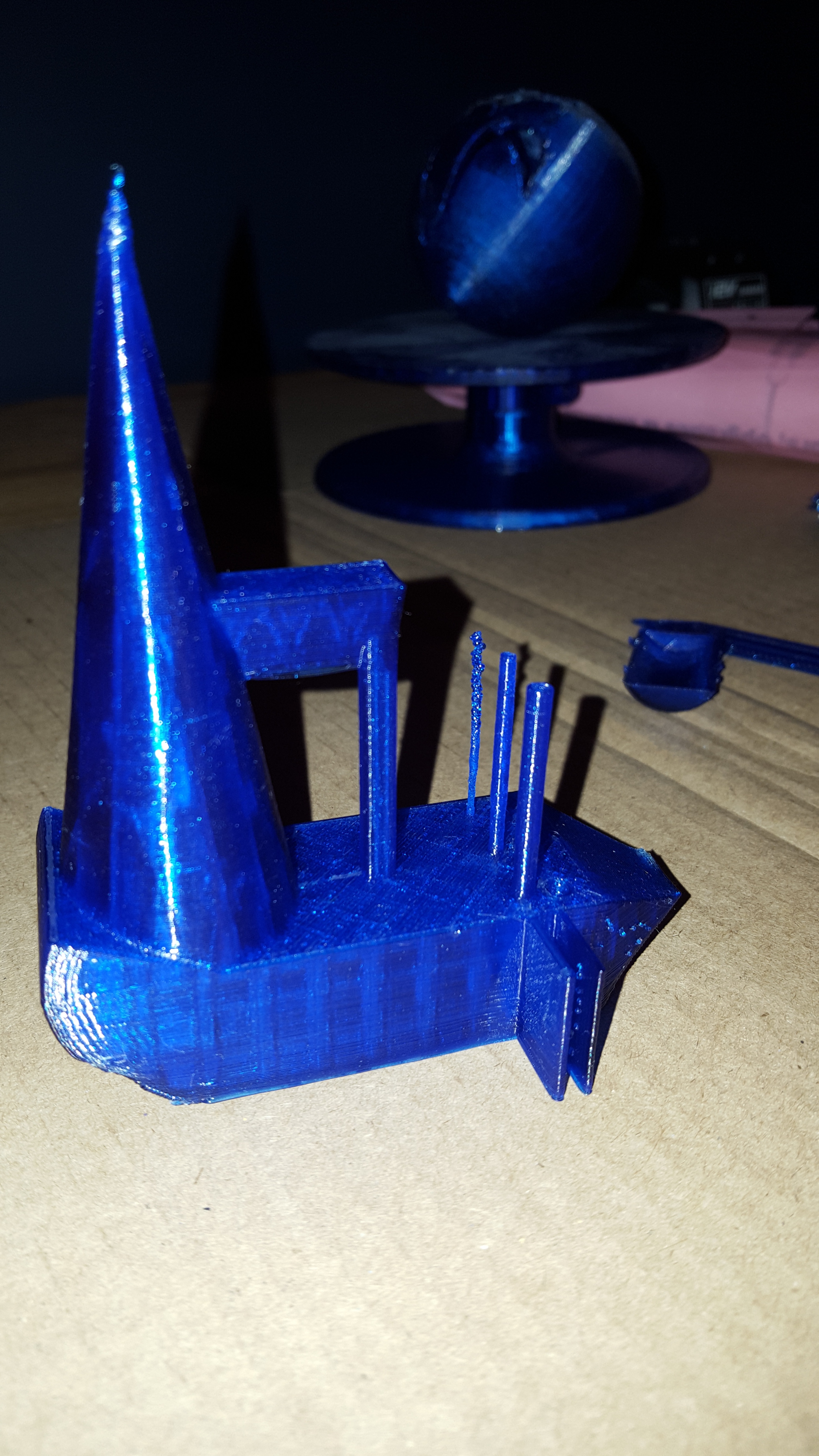

Ok i did 2 prints of makers muse test print. the first was simplify3d set to middle quality, lulzbot mini, abs. there was no hips setting and i did not want to monkey around with it. extruder 230, bed 90. 2hr 37m. Second set was with cura 21.02 set to standard quality, lulzbot mini, hips, extruder 250, bed 110, 2hr 43m. both missed the small third strut on the right side. still trying to get something on craftware. totally new to this so trying to gcode things is out of the question for now. i am including the photos.
