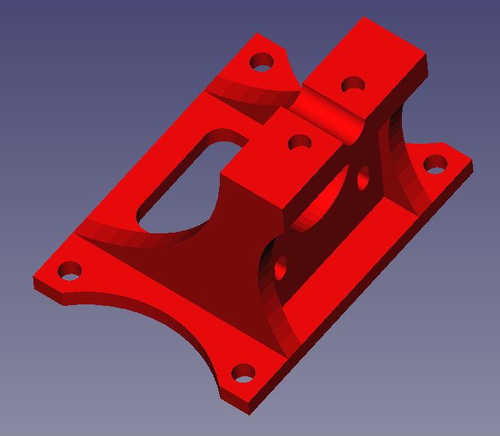

Hello,
This forum is a great idea, thanks for setting it up. 🙂
This is quoted from the [Getting control of layer variations on smaller prints](https://forum.lulzbot.com/t/getting-control-of-layer-variations-on-smaller-prints/50/1) topic.
> [@BotLord](#):
> We actually switched over to the x-end 2.0 clamps to alleviate this exact problem
I saw the AO-100 Upgrade blog post and printed a pair of x-end 2.0 clamps this weekend. I used the **AO-x-end-clamp\_acme\_2.0\_2.gcode** file from [http://downloads.lulzbot.com/lulzbot/AO-101/parts/](http://downloads.lulzbot.com/lulzbot/AO-101/parts/)
Problem is, the parts are not dimensionally accurate on some important details:
- Center to center distance between the half-hexagonal grooves to sit under the smooth rods is about 1mm shorter than it should (see picture - at the bottom of the picture you can see the rod does not sit on the groove).
- Center to center distance of holes on the bottom plate to attach to the upper x-end-idle is 31mm instead of 32mm
- The rounded cutout on the smooth rod side is 13mm wide instead of 14mm.
It baffles me that all other dimensions seem correct, outer dimensions and the pillow block bushings holes.
Dimensioning an STL is a PITA in any CAD program and OpenSCAD code is gibberish to me. I opened the original scad file in FreeCAD, even though the import process is still not perfect it recreated most primitives which parameters can be read easily.
Any idea why something like this would happen? I have yet to generate new gcode from the original STL and print it to see if I have the same problem.
P.S. I’m NormandC on the FreeCAD forum, I’m the one who converted the TK-0 part models from SketchUp to FreeCAD. 🙂

**Post date:** [April 17, 2013, 6:24pm UTC](https://forum.lulzbot.com/t/ao-100-upgrade-printed-x-end-2-0-clamp-have-wrong-dims/53/2 "2013-04-17T18:24:35Z")
You’ll want to grab the model from [http://downloads.lulzbot.com/lulzbot/AO-101/hardware/printed\_parts/stl/](http://downloads.lulzbot.com/lulzbot/AO-101/hardware/printed_parts/stl/) and re-slice it. The rod grooves are going to be a little tighter, but they shouldn’t be as tight as what you are seeing. The G-code file you used may have been based off a changed model.

**Post date:** [April 19, 2013, 1:01am UTC](https://forum.lulzbot.com/t/ao-100-upgrade-printed-x-end-2-0-clamp-have-wrong-dims/53/3 "2013-04-19T01:01:42Z")
Thanks for the info. I also found that the OpenSCAD file [here](http://downloads.lulzbot.com/lulzbot/AO-101/hardware/printed_parts/source/AO-x-end-clamp_acme_2.0.scad) is missing some important geometry.
Last night I decided to remodel the x-end clamp in FreeCAD. It puts out nicer STLs than OpenSCAD IMHO, and they’re often half the file size. Based on the holes on the [x-carriage\_pillow.sldprt](http://downloads.lulzbot.com/lulzbot/AO-101/hardware/printed_parts/source/x-carriage_pillow.SLDPRT) original SolidWorks file for the extruder mounting plate, I determined that the smooth rods on the X axis should be 50mm center to center and modeled my grooves accordingly.
I printed it tonight but had to cancel the print because I had bad drooping on the hexagon hole bridging. This is why I used the existing gcode in the first place, I’m really a complete noob at slicing and 3D printing.
As for the distance between the grooves, it’s not easy to measure, depending on where I take the measurement it seems to be between 49.5 and 49.9mm which is not too bad. But the part still won’t sit correctly on the smooth rods!
I researched further and found the problem is not where I thought it was. The problem is with the center to center distance of the X axis smooth rods. On the motor side they are 50.18mm apart, but on the opposite side (the one I pictured) they are 50.92mm apart.
I’m wondering if the grooves shouldn’t be made wider so to allow for such tolerance (which may cause other problems?), or maybe I should print a complete set with x-end-idle and x-end-motor and make sure the center to center of the grooves are as identical as possible between parts.
I have to admit that the idea of disassembling the whole X and Z axes to do the upgrade intimidates me. I have never assembled a 3D printer. I’m a designer and CAD guy, usually other people build the things for me!

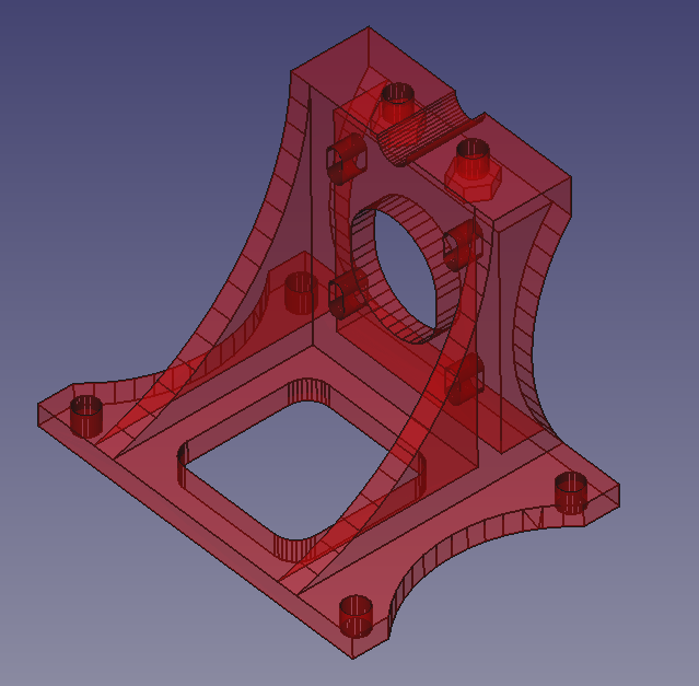

I’ve been modeling the AO-101 in FreeCAD partly to practice my FreeCAD skills, and partly to understand its construction better and its differences with the AO-100. Tonight I modeled the lower Z motor mount as per the AO-101 latest STL and in fact, it’s been redesigned to lower the motor.
 ![AO-101_lower_z_motor_mount.png](https://us1.discourse-cdn.com/flex020/uploads/lulzbot/original/1X/0b5a886f7f6898f7aefeeceb3bea13e14a1c7f5f.png)
So the AO-100 lower z motor mounts need to be replaced with the AO-101 ones for this upgrade as well.

> [@Gemini64](#):
I completely forgot to mention that the **Lower\_Z\_Mount\_Motor\_V2.4.stl** file available at [http://downloads.lulzbot.com/lulzbot/AO-101/hardware/printed\_parts/stl/](http://downloads.lulzbot.com/lulzbot/AO-101/hardware/printed_parts/stl/) does not seem complete. The holes for the M5 screws fastening the z clamp are not drilled through. I wonder if that’s intended, maybe they are drilled through after printing. There is no recess for the hex nuts either. And that region has a massive overhang of 12.5mm x 44mm. Maybe that one needs support.

> [@Gemini64](#):
> I completely forgot to mention that the Lower\_Z\_Mount\_Motor\_V2.4.stl file available at [http://downloads.lulzbot.com/lulzbot/AO](http://downloads.lulzbot.com/lulzbot/AO) … parts/stl/ does not seem complete. The holes for the M5 screws fastening the z clamp are not drilled through. I wonder if that’s intended, maybe they are drilled through after printing.
OK so I was completely wrong. I just had a quick look at the STL in FreeCAD:
 ![AO-101_lower_z_motor_mount_01.png](https://us1.discourse-cdn.com/flex020/uploads/lulzbot/original/1X/8d7609ff98227aeba6999fe40038ffd2f3e09d0b.png)
At first look it seems like the holes for the smooth rod clamp don’t go through.
 ![AO-101_lower_z_motor_mount_02.png](https://us1.discourse-cdn.com/flex020/uploads/lulzbot/original/1X/11d5917516394ba1e83af6e772f8af24f1a1f7a8.png)
But tonight I checked the gcode file preview in Pronterface and saw that bridging is done in one layer then the hexagon cutout is printed. So I opened the file back in FreeCAD, converted the stl to solid and set the part’s transparency to 70% and here it is:
 ![AO-101_lower_z_motor_mount_03.png](https://us1.discourse-cdn.com/flex020/uploads/lulzbot/original/1X/689c7b607eec03d312654d684f4b6c754089c9f8.png)
So the holes and the hex cutouts need to be cut afterward with a knife.
That’s some big overhang surface and no support is used in Lulzbot’s gcode file. Even if I may not do the upgrade before some time I think I’ll attempt to print this and see if I can achieve this kind of bridging.

Sorry but… we do. There is not enough clearance with the old AO-100 Z motor mounts. It’s no coincidence the AO-101 Z motor mount was redesigned with a lowered top surface! The step motor is lower on the AO-101 than on the AO-100.
Compare this picture with the FreeCAD screen capture of the Lower\_Z\_Mount\_Motor\_V2.4.stl file I showed earlier ([here](https://forum.lulzbot.com/t/ao-100-upgrade-printed-x-end-2-0-clamp-have-wrong-dims/53/1)).
 ![AO-100-Z-upgrade-clearance-1280px.jpg](https://us1.discourse-cdn.com/flex020/uploads/lulzbot/original/1X/6bc939aeb9c7f4196f5ed7e26fe469cd7df1102f.jpeg)
I homed the Z axis prior to taking this picture. As I said earlier
> [@Gemini64](#):
> I just checked on my printer. I’m clear by a mere 2mm on the X-axis pulley side, but I need about 1.5mm on the motor side. I can see that the motor side coupler is installed higher than on the opposite side. At these small values there’s no room for error.
By “I need about 1.5mm” I meant I’m short 1.5mm.

Hey guys, this is Seth from Lulzbot.
I wanted to jump in and state that you indeed do not need to upgrade your lower z motor mount.
We’ve upgraded our fleet of 40x AO-100s with these clamps without a single motor mount.
If you do run out of space, you’re hitting the clamp on the top of the coupler. All you need to do is lower your coupler a little and you should be good to go.
I updated the motor mount for the AO-101 just to give us some extra space, but it’s not needed for the upgrade.
