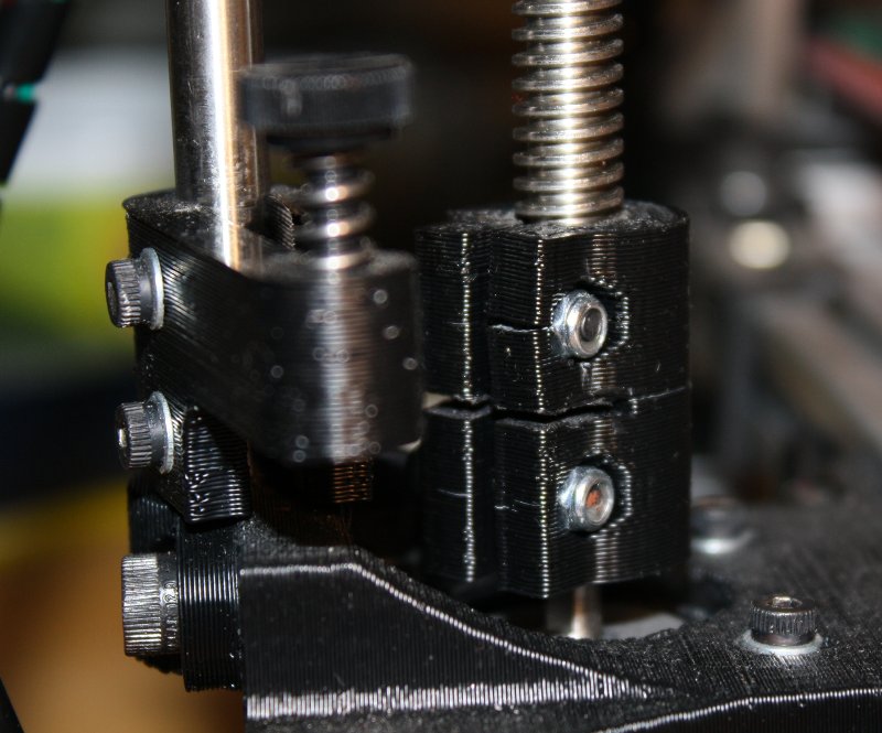

**Author:** ![Gemini64](https://sea2.discourse-cdn.com/flex020/user_avatar/forum.lulzbot.com/gemini64/32/8_2.png) [@Gemini64](https://forum.lulzbot.com/u/Gemini64)\
**Post date:** [October 23, 2013, 4:58am UTC](https://forum.lulzbot.com/t/ao-100-x-end-motor-catching-on-the-leadscrew/301/2 "2013-10-23T04:58:42Z")
Update: I decided to disassemble the x-end-motor to see what was happening with the captive nut. I removed the x-endstop bracket, the z endstop switch, then the motor, then the lower pillow block bushing, and finally the 4 screws holding the x clamp to the x-end-motor bracket. Everything looked like it should…
That’s when I noticed that the left leadscrew was quite higher than the right one. It was overshooting the top of the upper Z mount by at least 6mm if not 10mm… I looked at the ACME clamp (Z axis coupler)… The lead screw was almost out of it! Also, the clamp is split right at the upper screw hole.
I wish I had found that _before_ I disassembled the x motor bracket assembly! 😠
It’s too late to continue, I’ll put everything back together tomorrow, I hope that’s the source of the problem… And then I hope I can use the broken coupler until I can print a replacement.

Tonight I assembled everything back together and the left leadscrew is now fully seated in the Z coupling. In Printrun I clicked on the Z+10 button a few times, then Z-10, home and repeat. Travel seems to be doing OK, although I sometimes hear a brief sound like there is some resistance to the movement.
I also noticed that the z coupling is not only split at the upper hole, it also seems to be delaminated at the middle. It’s got no more rigidity anymore. First thing to print is a replacement, but which one? I don’t want to use the stock one, I feel that printing it bottom up makes it too fragile. Maybe I can adapt the one 1013 did (in 2 plates) for his TAZ…

There is a replacement z-coupler here: [http://download.lulzbot.com/AO-101/parts/ss\_coupler\_4.gcode](http://download.lulzbot.com/AO-101/parts/ss_coupler_4.gcode) or here: [http://download.lulzbot.com/AO-101/hardware/printed\_parts/stl/beefey\_coupler\_acme.stl](http://download.lulzbot.com/AO-101/hardware/printed_parts/stl/beefey_coupler_acme.stl) that is much more rigid in design

Good thing I printed two couplers, because the right one was broken too!
The AO-101 coupler are indeed “beefier” than my AO-100’s.

We saw that happen in the bot farm relatively frequently(24/5 printing pushes the machines pretty hard) and swapped every machine to the new couplers.
No need to cut the slots open, it is part of what makes the parts stronger
