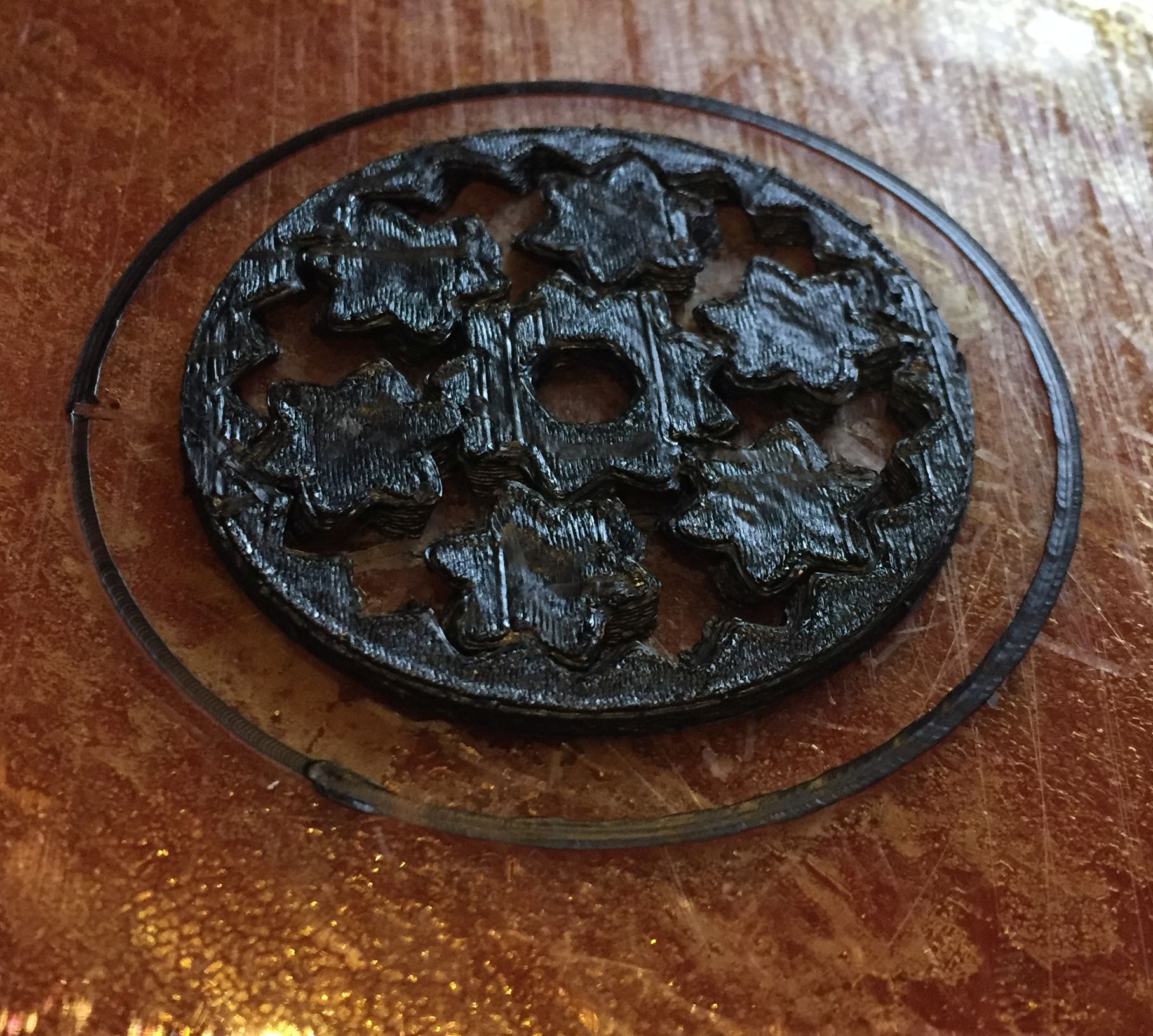

So I dialed in my esteps. I thought I would start with that.
I measured my filament (Hatchbox black @ 2.99)
I’m printing from Slic3r using (mostly) default Lulzbot settings @ a layer height of .22 (same for first layer)
Temps: head 240
Bed: 110
Speed: 80
Infill: 30%
My first layer measured comes in @ ~ .17 - .19, but if I raise my z stop anymore, the layer doesn’t stick.
So here are the images. I printed a subset of the planetary gears from Thingaverse ([http://www.thingiverse.com/thing:53451](http://www.thingiverse.com/thing:53451)). The difference between the prints is that I raised my Z stop a bit.
Any help appreciated!

**Post date:** [February 20, 2016, 7:19pm UTC](https://forum.lulzbot.com/t/bad-abs-prints/2986/2 "2016-02-20T19:19:57Z")
You are overextruding some. For Slic3r you also want to make sure to enable the auto cooling features for small layers.
**Post date:** [February 20, 2016, 8:08pm UTC](https://forum.lulzbot.com/t/bad-abs-prints/2986/3 "2016-02-20T20:08:36Z")
So given that my esteps are dialed, should I tweak the filament diameter or the flow rate?
**Post date:** [February 20, 2016, 8:17pm UTC](https://forum.lulzbot.com/t/bad-abs-prints/2986/4 "2016-02-20T20:17:30Z")
Either one will work. are you getting similar issues with other filliaments? Also, do you have the fan off?

**Post date:** [February 20, 2016, 8:18pm UTC](https://forum.lulzbot.com/t/bad-abs-prints/2986/5 "2016-02-20T20:18:43Z")
At which speed do you have calibrated your esteps? The 100mm/min recomended by Lulzbot are too fast, if you used this redo at about 40mm/min and you will get a lower, better number.
Due to the bug in Slic3r (see your other thread), don’t adjust your esteps or flow rate based on this print! ❗

**Post date:** [February 20, 2016, 10:16pm UTC](https://forum.lulzbot.com/t/bad-abs-prints/2986/8 "2016-02-20T22:16:44Z")
So I got the top do print. But now getting crappy results on sides ☹
Help…
In every print, the sides are beat up, pulled in, .
I lowered the temp on the material from 240 to 215, 220. The Hatchbox states 210 - 240, so shot for the lower end.
On one cube, I change flow rate from 100 to 95. I don’t see much difference.

**Post date:** [February 22, 2016, 1:17am UTC](https://forum.lulzbot.com/t/bad-abs-prints/2986/12 "2016-02-22T01:17:03Z")
Well, I moved back to Cura, and the results are MUCH better. Not sure what’s going on, but my little 20mm square cubes are STUNNING out of Cura.
Sigh.
I think I’ll stick there for awhile until I get a better sense of what’s going on. Too many variables in Slic3r. I think I’m just getting into trouble there.

**Post date:** [February 22, 2016, 7:41pm UTC](https://forum.lulzbot.com/t/bad-abs-prints/2986/14 "2016-02-22T19:41:56Z")
OK, figured out the magic ingredient: in Cura “Minimal Layer Time”. Seems on small parts (such as my 20x20x20 cube, I wasn’t allowing enough cooling from layer to layer, therefore, the massive warping.
Is there a similar override in Slic3r?
**Post date:** [February 22, 2016, 7:48pm UTC](https://forum.lulzbot.com/t/bad-abs-prints/2986/15 "2016-02-22T19:48:20Z")
> [@PeterT](#):
Of course. Have a look into Filament → Cooling. Slic3r has the best cooling logic I know, it’s worth playing with it.
