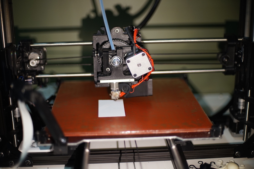

- Slide a business card between the nozzle and bed
 ![DSC02534.JPG](https://us1.discourse-cdn.com/flex020/uploads/lulzbot/original/2X/9/9d59b869f0533cea2dc5114875e6b7423862f159.jpeg)
- Should be slight resistance from the nozzle. Adjust z-endstop as necessary.

Test print a 20x20x3mm calibration cube. **Wait until 50C to remove** the cube… it should pop off the bed pretty easily. If you’re sitting next to the print as the bed cools… you’ll hear a crackling at about 70 down to 55C. If it’s stuck to the bed and sliding the oyster knife under the print doesn’t do it, then you need to incerease the nozzle distance to the bed… quarter turn on the endstop knob.
Once the calibration cube comes off the way you like it, then go back with the dial gauge, zero above the bed, then home Z to get the distance for your nozzle to bed. Next time you level the bed, shoot for this number.
