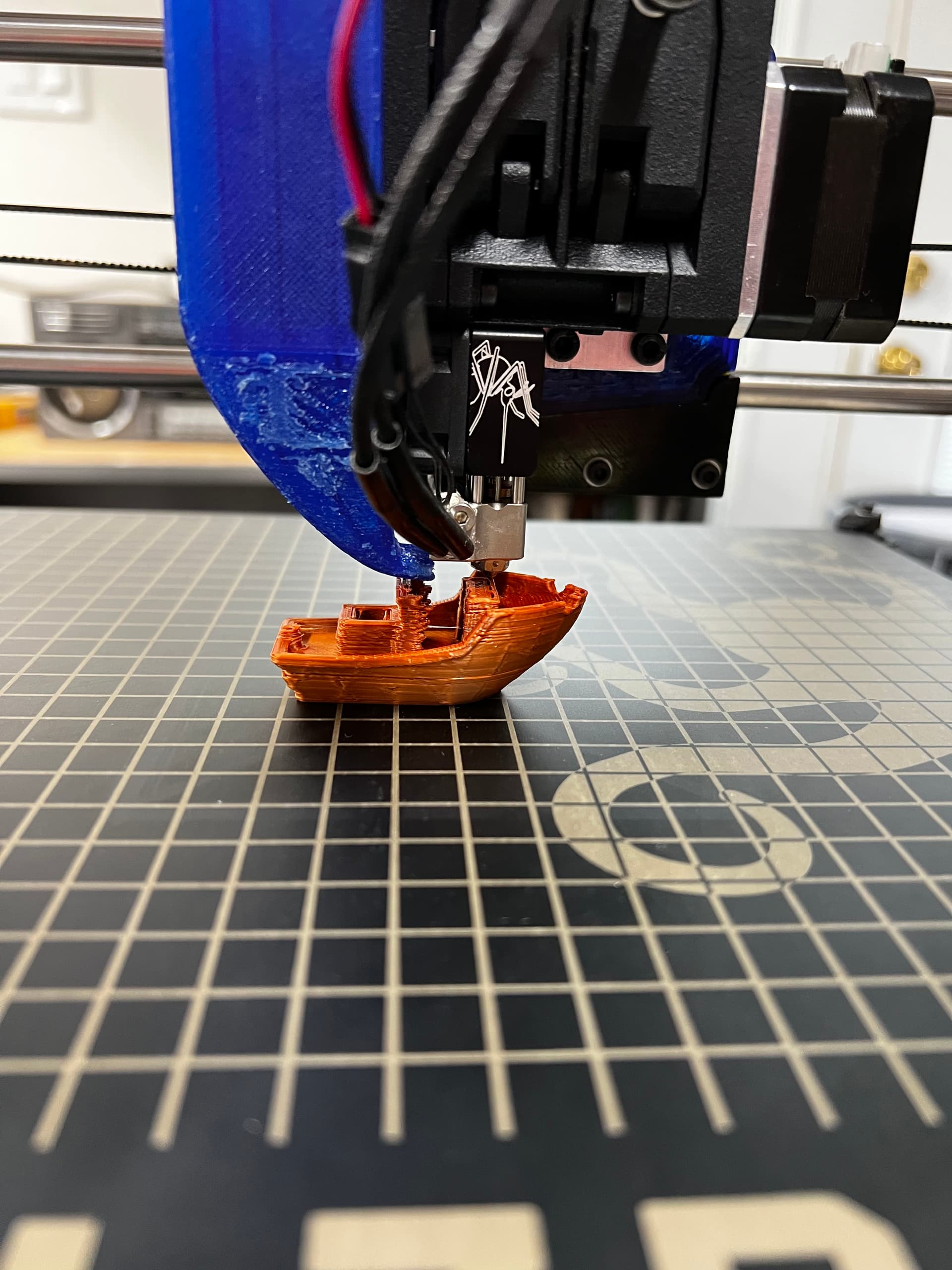

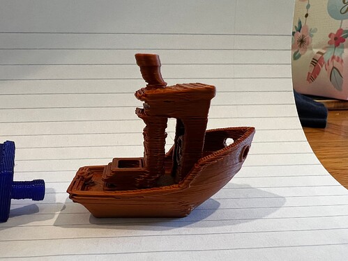

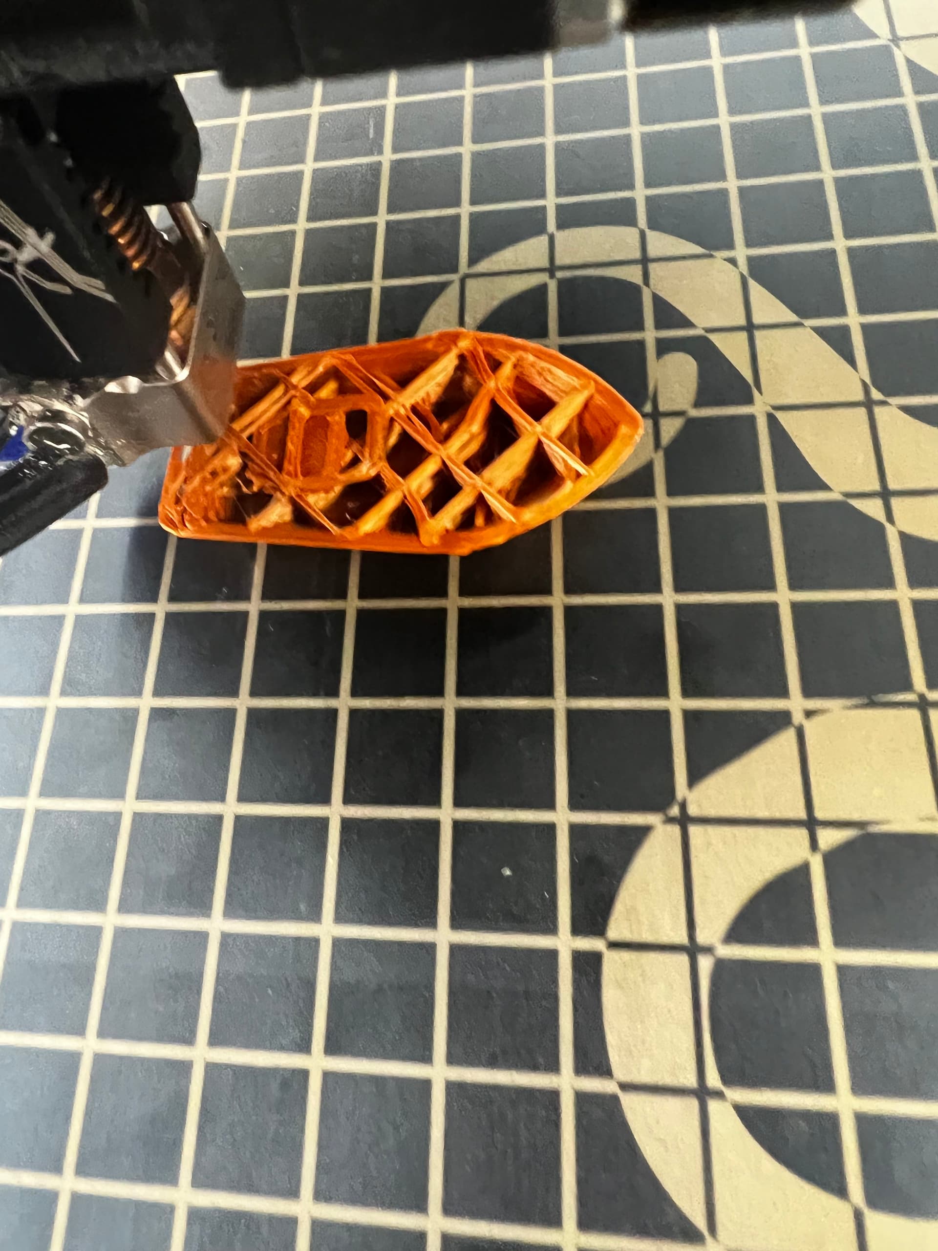

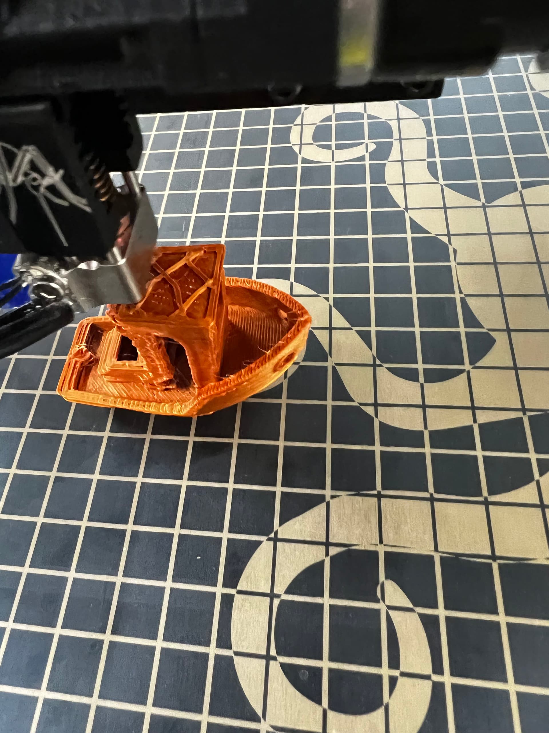

I have a TAZ 4 that I upgraded with a BMG-X2-M (only one hotend on it at the moment), auto bed leveling using a limit switch, and Marlin 2.1.1. This benchy is the first print I let the printer complete just to showcase the problem I’m having. It seems like there are layer shifts but only on part of a layer. Also, thee infill ( just a grid pattern) has parts of it that are curved and others like normal
If I print from an SD card instead of a USB cable to the computer I get the first layer to print normally, and then the rest are the same as the photos. The layer preview on Cura 5.1 shows everything normally, so my theory at the moment is that Marlin 2 is just a bit much for the 8bit Rambo board. I’m going to configure version 1.1.9 and see if that works.
If anyone is experiencing anything similar or knows how to solve this, please let me know.

All the layer shifts appear to be in one axis. That motor (or its driver on the board) could be on its way out. If you’re handy with recompiling the firmware, you could swap drivers with that axis and the second extruder’s, and see if that corrects it.

Alright, I tested the stepper driver by just swapping the pin assignments between the x-axis and e1 steppers in the firmware and swapping the cables on the mainboard. This produced the same results, which tells me that the driver is not the issue, so I swapped everything back to normal.
The next thing I tried was going back to Cura LE and making a profile for my printer. At first, it seemed like everything was going normally, but about 15mm in, it started doing the same exact thing. (weird partial layer shifts)

It was partially right, turns out the belt pulley was a bit loose. I deleted the post because it was stupid of me not to check that in the first place.
