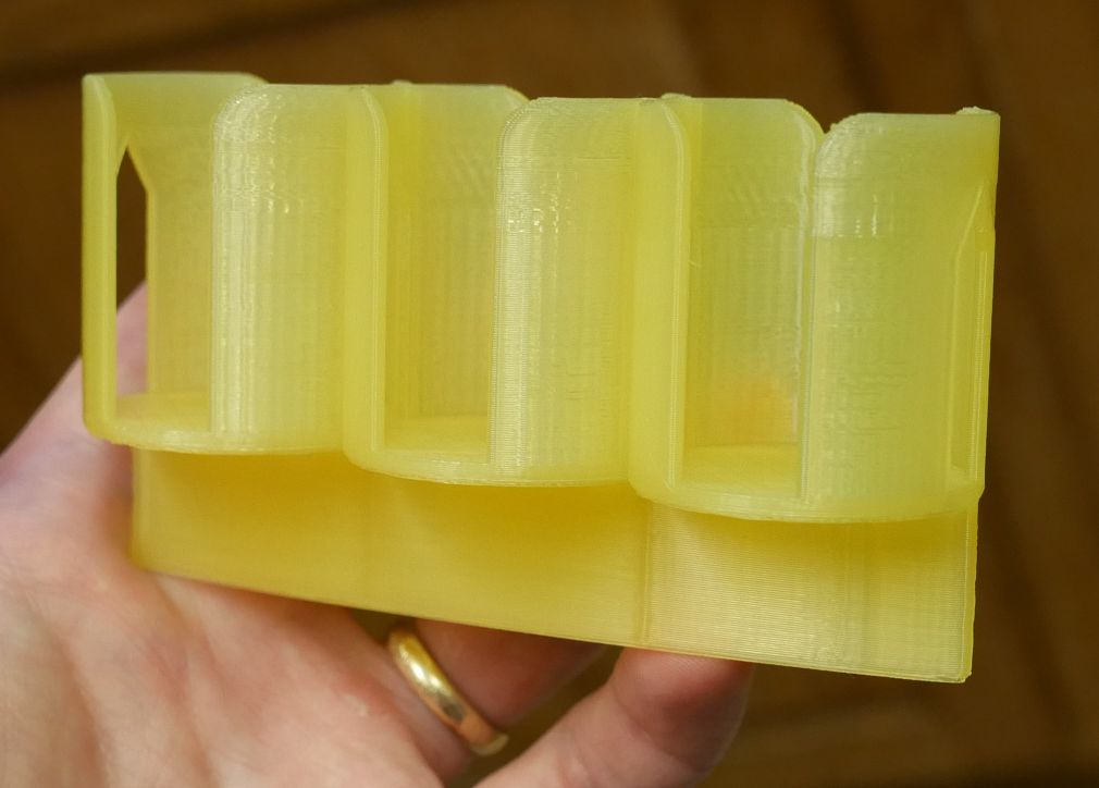

It occurred to me that there’s no reason for there to be any seam in this model. The model is made from 6 semi-circles. Each one can be completed by starting at one end and finishing at the other one. Is there some way to force this behavior? Maybe “hide seams” would do it.
Regarding support, the support looked to me like it would work. I think I don’t really know what to look for. I suppose a potential issue with the concentric support is that it will work OK if the extrusion is perpendicular to the support lines, but it’s possible to get extrusion that runs parallel to the support. It looks like maybe the failed extrusions were actually curving along the edge of the model, so they would have missed the support. Is it possible to get support that extends a bit beyond the model?

In terms of forcing Cura to start each layer at a certain point there is an option in the travel settings for “Layer Start X” and “Layer Start Y” that say they will set a coordinate that your print will try to start each new layer near. That could theoretically help with that but it isn’t a setting I have personally used so I can’t offer much for assistance past that in terms of what you would want to set those numbers to, it would be kind of trial and error I think.
I might try a grid pattern for your support. I find this to be the most reliable in terms of a good solid surface to support more difficult to print items. In regards to having the support extend out past the model I haven’t found a settings that automatically cause the support to extend past the model. You may be able to find a way but it would involve adjusting support settings and seeing how things came out in layer view until you got something that looked like what you wanted.

I did another trial of the print. This one was slightly different as I also iterated the design a bit. The grid support was fantastic at producing a clean underside. But it was quite difficult to remove. I guess that’s a trade-off. The pictures of this color of PLA are harder to see:

Here’s the picture from the front. The finish is nice all around the outside and there seem to be seams on the inside on each cylinder. (In addition to being hard to see in photos it’s hard to see in person.) I saw the option for specifying the seam position, but there was no obvious way to figure out the X and Y positions of a location in the model, so I just put it back to the default (shortest distance, I think). I couldn’t find “Seam Corner Preference” in the menus anywhere. Where is it?
 ![side.jpg](https://us1.discourse-cdn.com/flex020/uploads/lulzbot/original/2X/8/8eba62a68bf24c61b69ea5dc1cceea853d35dabd.jpeg)
Overall I’d say this is a pretty successful result.
I have to say that one thing definitely bugs me about this: if you have to use the sdcard to print successfully then if you have the Lulzbot Mini you’re screwed—no sdcard slot. I have been pondering buying a printer for home use and my budget wouldn’t go beyond the Mini. (Maybe not even that far.)

The Seam Corner Preference setting is directly below Z Seam Alignment in Cura 3.2.21.
