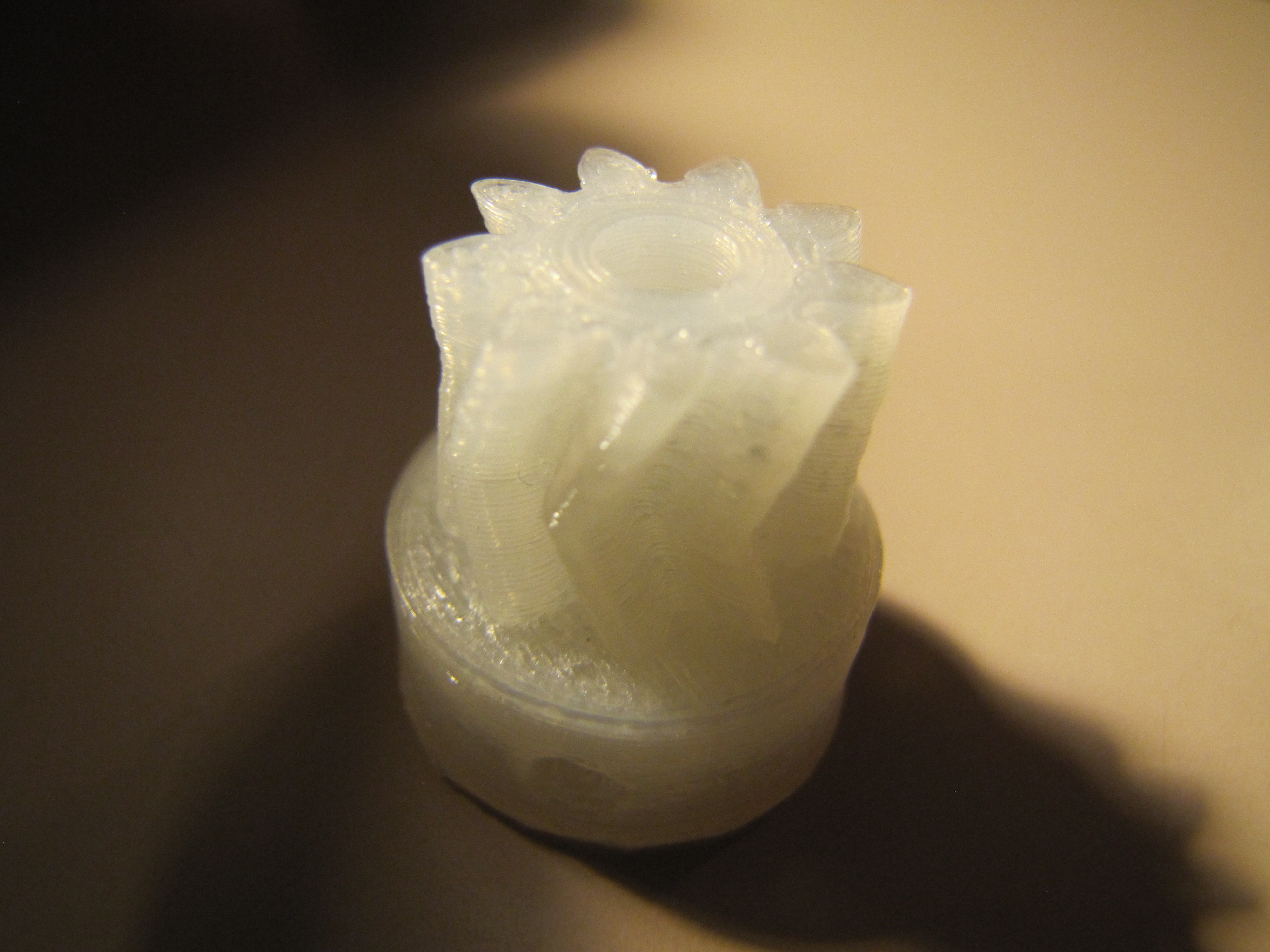

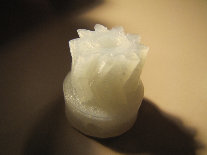

Ok here are some new photos of a nylon part I printed, I figured I needed a backup for the other Nylon herringbone gear I made, and I wanted to check my new settings using MatterSlice. Just click on the pictures to see the expanded versions.

 ![top gear 1.jpg](https://us1.discourse-cdn.com/flex020/uploads/lulzbot/original/2X/7/7f8a403ff62c369b133933a665781ca6451dbf97.jpeg)
When you do it right it looks kinda like this

 ![herringbone wallpaper.jpg](https://us1.discourse-cdn.com/flex020/uploads/lulzbot/original/2X/c/c49e4c9701774f51496ceea8699ddeeccb145c53.jpeg)
and finally when the day’s done and you need some inspiration to print use my current best print as wallpaper.
