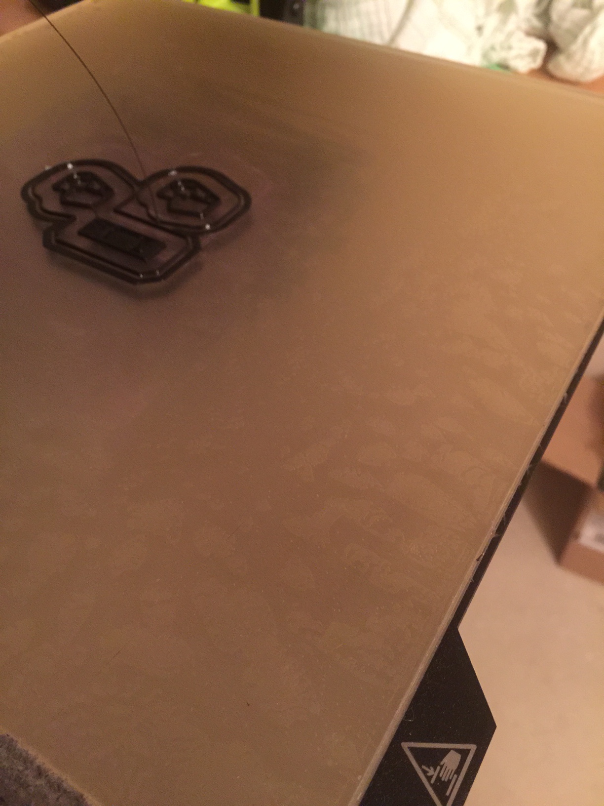

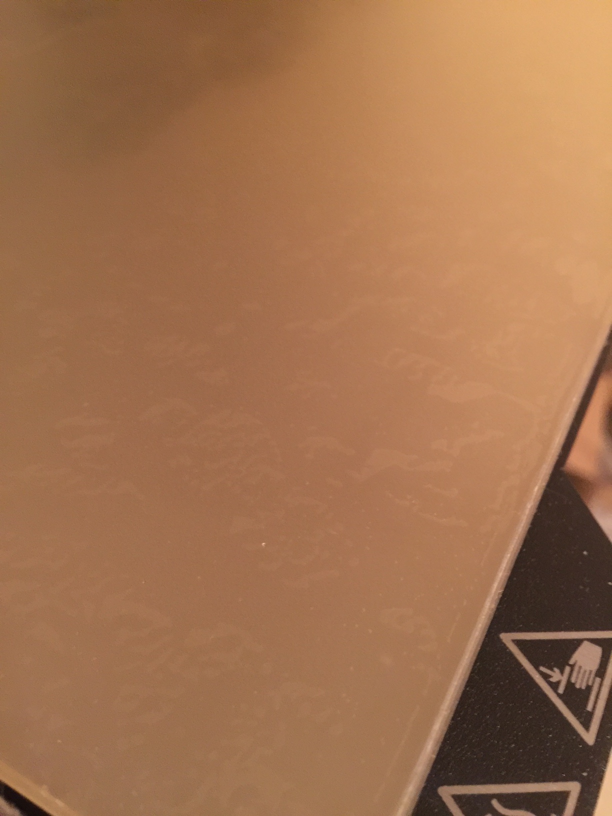

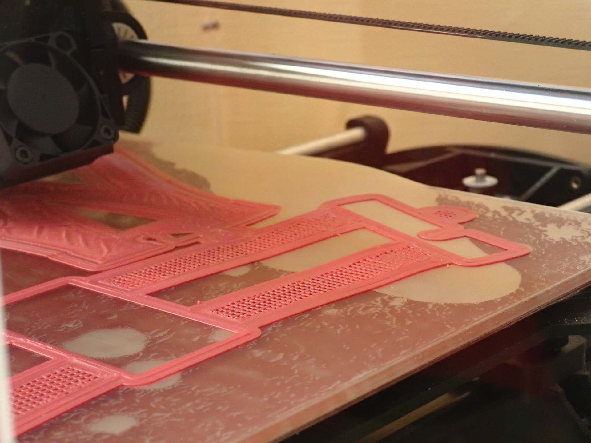

I had replaced my bed three times due to bubbling and was very hopeful Lulzbot was going to have the problem fixed on the modular bed. I emailed Lulzbot prior to buying it and they assured me that the adhesive would not have bubbling problems and is good for the temperature.
The bed arrived looking pristine… then… I had small bubbles on the modular bed after one 30 minute print. Picture attached below.
So I emailed Lulzbot- I told them there is a problem with the adhesive and it’s bubbling as soon as you turn the heat on. They replied that they think the bubbling is NORMAL! I strongly disagree- an appropriate adhesive should have no bubbling whatsoever… I was directed to the 3M datasheet for the adhesive, which does say it is good for high temperature (for short time periods), though it doesn’t say at what air pressure, which is also quite important. It’s probably showing the temperature the adhesive is good for at sea level- and bubbles are more likely to form at higher altitudes and higher bed temperatures. Or maybe it’s water or alcohol trapped under there and vaporizing with heat, from an improper installation. After seeing it happen a number of times, I believe it’s some light hydrocarbon residue in the adhesive which is vaporizing.
I have also attached images after 10 prints and 20 prints. The bubbles grow every print. When I asked Lulzbot how they would like to address this issue they told me it’s really no problem, but if I wanted to I could only return it within 30 days and I would be left without a bed… so much for the renowned service.
The bubbles normally take more than a month to become a problem under what I would consider normal hobby use (and they seem to become a real bad problem every time if you’re printing ABS or PETG!), and then Lulzbot will not help you once they grow larger and you have a bubbled bed problem after a couple months. Replacing the bed is a pain- start to finish its a couple hours with a razorblade and I just can’t bring myself to do it again knowing it will just bubble AGAIN. You can pierce them with a razorblade, but the bubbled area doesn’t really stick properly anymore once it has bubbled.
Lulzbot seems to have no plans to address the problem or make it right with customers that have spent hundreds of dollars on beds which are garbage after very little print time. Once the bubbles are large enough, they cause major adhesion problems due to thermally insulating the print from the bed, and they cause physical deformity of the print. Once large enough the bubbles literally move around during the print and pop your print off.

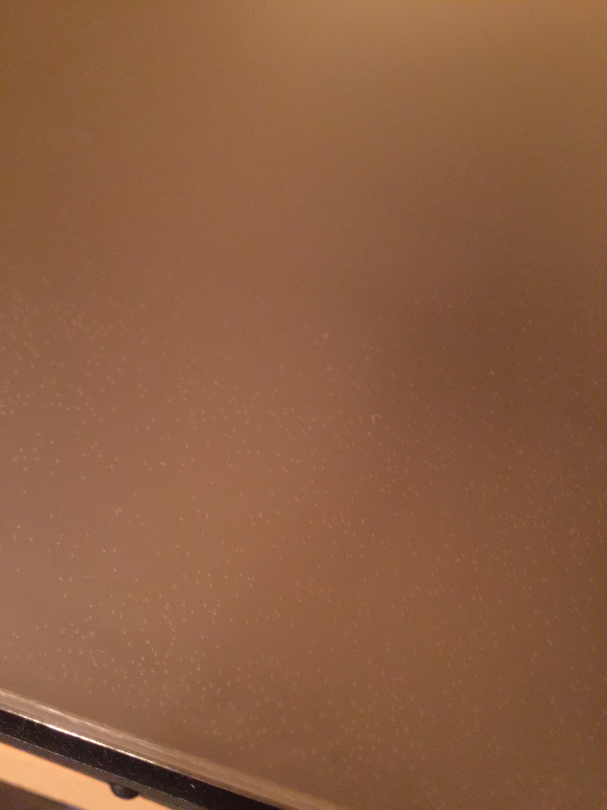

Yeah mine has done the same! huge bubble at he back that distorts the print- at first I thought it could be a problem with the surface being dirty, so I cleaned it thoroughly and so this morning I saw a massive bubble at the back- and thought “oh s\*\*\*!” sounds like everyone is having a similar problem? definitely keep an eye on this issue- however some of the products mentioned here are not available in the UK. Has had a result of me rethinking about buying another Taz 6 if this is a major problem- don’t want to be replacing the PEI every 20 to 30 prints?
Sorry the second picture is upside down! but if you look closer there is a definite gap between the surface and the bed- seems to go away when the bed is cold.
