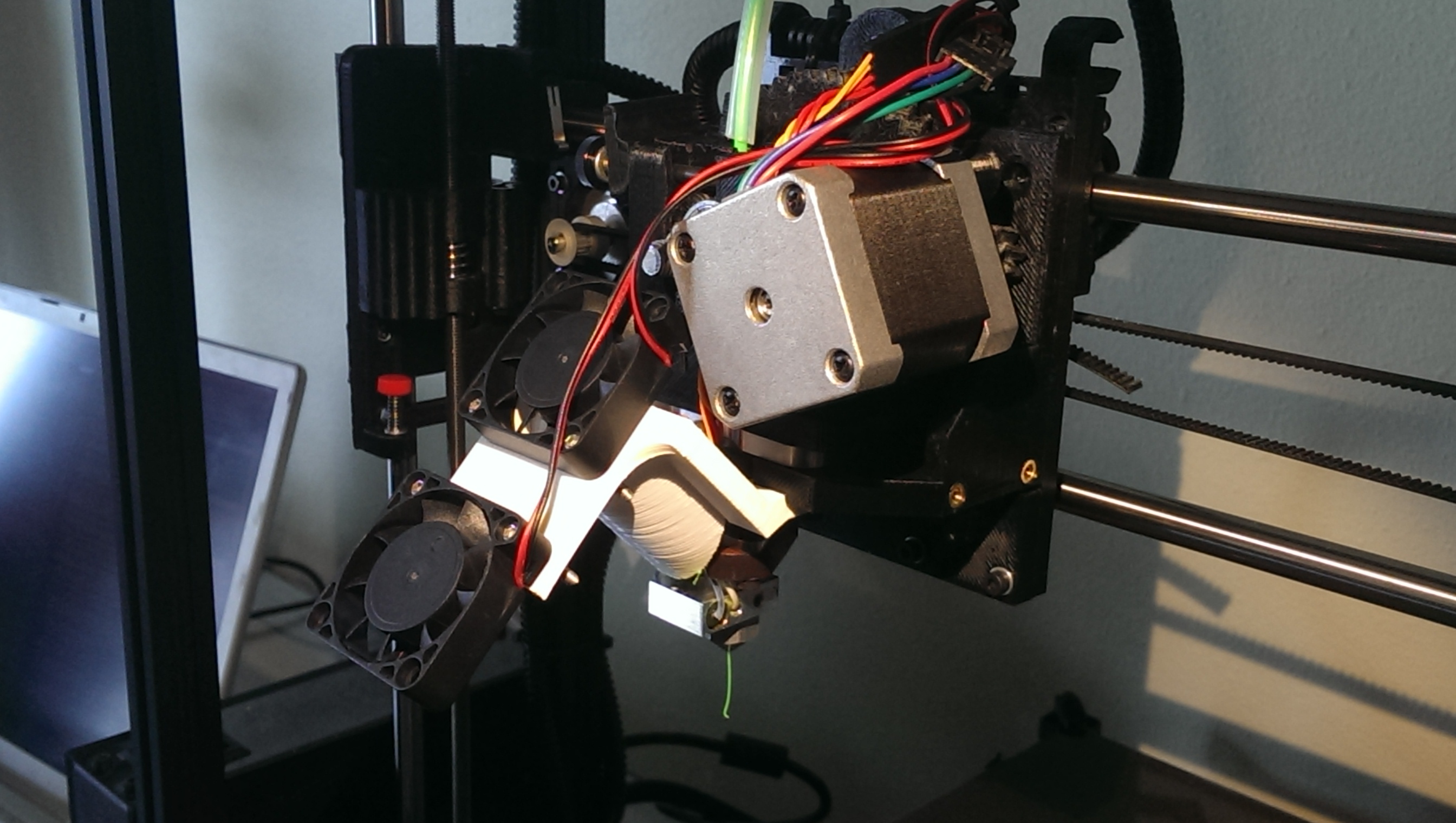

**Author:** ![scott](https://avatars.discourse-cdn.com/v4/letter/s/3e96dc/32.png) [@scott](https://forum.lulzbot.com/u/scott)\
**Post date:** [August 29, 2013, 7:29pm UTC](https://forum.lulzbot.com/t/budaschnozzle-2-0-pla-fix/154/13 "2013-08-29T19:29:53Z")
Agreed, the hot end should not be allowing heat creep, but it does.
Yes, in fact I installed two fans; one always on directed at the heat sink, and another directed at the print controlled by slicer. With this setup I completed a seven hour print without jamming. Without the fans the extruder would jam around hour two or three.
I see nothing to stop the entire length of all thread from heating to extrusion temp and leaking where it connects to the heat sink. I will try Teflon tape, then liquid thread sealant to stop the leaking.
update: Teflon applied to allthread ABOVE the heater block stopped the leaking.
 ![1377804413988.jpg](https://us1.discourse-cdn.com/flex020/uploads/lulzbot/original/1X/6c6aadf57e6feb8bb0af152e29e4736307727f2d.jpeg)
**Post date:** [September 4, 2013, 12:46pm UTC](https://forum.lulzbot.com/t/budaschnozzle-2-0-pla-fix/154/14 "2013-09-04T12:46:34Z")
Which fan mount did you end up using? Would you mind sharing the model?
**Post date:** [September 4, 2013, 9:13pm UTC](https://forum.lulzbot.com/t/budaschnozzle-2-0-pla-fix/154/15 "2013-09-04T21:13:04Z")
Sure, the fan mount I designed is attached, notes:
-The 45 degree orientation of the heat sink fan (top) is not ideal; some air blows onto the heater block.
-The print fan (bottom) could probably benefit from a duct, the hot end gradually loses heat and can’t maintain temp.
-The chicken and egg irony of printing a pla cooling fan mount in pla. Because the mount contains a long 45 degree overhang my prints repeatedly failed until I wired and hand held the fan with support turned on.
-All my holes required reaming to fit the hardware
EDIT: improved mount design with duct “FANmount2\_wDuct.stl” fixes the above problems
[FANmount2\_wDuct.stl](https://forum.lulzbot.com/uploads/short-url/agjzuObTDlBe5yCfmByzVZQaHh7.stl) (1.1 MB)
[FANmount2.stl](https://forum.lulzbot.com/uploads/short-url/tX3kQvVfYIseHr8VRRsuTwwee4z.stl) (814 KB)
