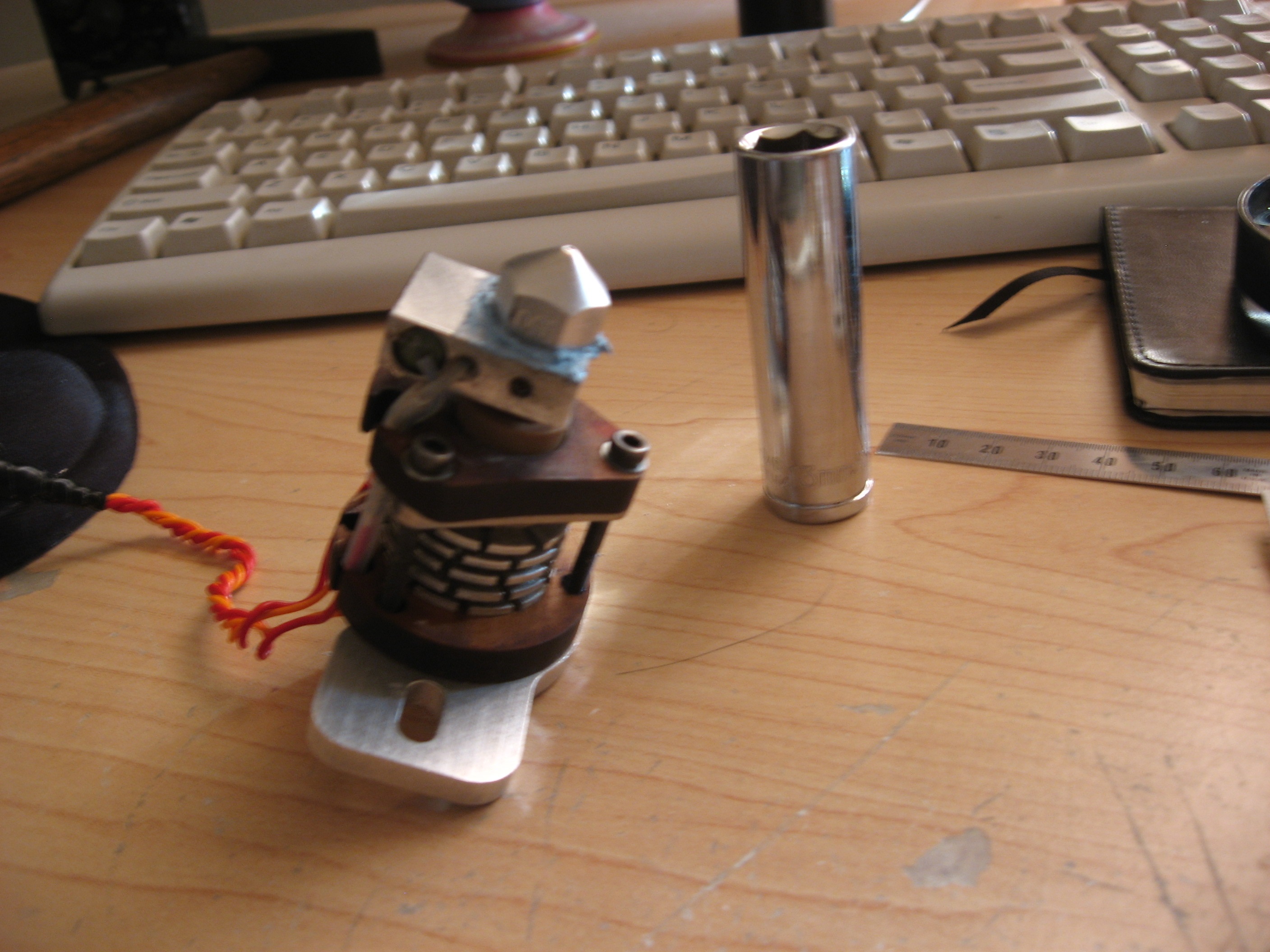

(((FIGHTING OOZE BETWEEN HEATBLOCK AND NOZZLE)))
I been fighting this ooze problem for some time. But, I also wanted to find something in my local store and not have to order online and wait for how ever long it was going to be delivered. I have came across some stuff called Megaloc.
Its a Multi-Purpose thread sealant. You can pick this up at a local Menards Hardware Store. I also use threading tape from Walmart. It feels like its more thicker than what you would get from Menards, Lowes, or Home depot.
Since I have used this product with threading tape I purchased from Walmart I have not even had a dribble of PLA from between heat block and nozzle. The threading tape also feels a little more thicker than blue eagle threading tape from Home Depot.
Now, I have not yet tried to just adding the Megaloc to the threads and run a print. I will give it a shot just adding Megaloc with no tape and see what kind of result occurs.
I also came across a tube of Harvey’s TFE Paste. Not yet gave this stuff a shot, but I will later on in time.
Here are links to these products with info. I hope these help. I know I can walk away from a running printer with out having to get up and keeping cleaning ooze from between heat block and nozzle. Thank God.
[http://www.walmart.com/ip/Oatey-Thread-Seal-Tape-White-1-2-x-260-2pc/17126516](http://www.walmart.com/ip/Oatey-Thread-Seal-Tape-White-1-2-x-260-2pc/17126516)
[http://www.menards.com/main/plumbing/rough-plumbing/installation-repair/thread-tape-sealant/megaloc-plastic-tube-display/p-1450058-c-8534.htm](http://www.menards.com/main/plumbing/rough-plumbing/installation-repair/thread-tape-sealant/megaloc-plastic-tube-display/p-1450058-c-8534.htm)
[http://www.menards.com/main/plumbing/rough-plumbing/installation-repair/thread-tape-sealant/1-fl-oz-teflon-paste/p-1340060-c-8534.htm](http://www.menards.com/main/plumbing/rough-plumbing/installation-repair/thread-tape-sealant/1-fl-oz-teflon-paste/p-1340060-c-8534.htm)
Also here are some images on how I go about ooze prevention. Some steps are the same as what was given at the beginning of this post, but I don’t think they add thread sealant to threading tape. I do that because of so many different ways of trying to stop it has stretched the nozzles just a bit, but not overly stretched. I have been able to let printer run for 48 hrs with out ooze and no strain on taking the nozzle back off the thread extension. 😛
I hope this helps.

Well, I finally was able to have the time to try just adding the Megaloc sealant to the Extension threads and nozzle. But due to the nozzle being stretched from adding PTFE tape so many times before, that it failed to hold back any of the PLA. Maybe when I get some new nozzles I will give a shot, but I am really considering on buying an all metal nozzle for different types of filaments. Maker Geeks has one I’m interested in buying. Not unless we can buy one off Lulzbot, if they ever get around on designing one or what ever.
