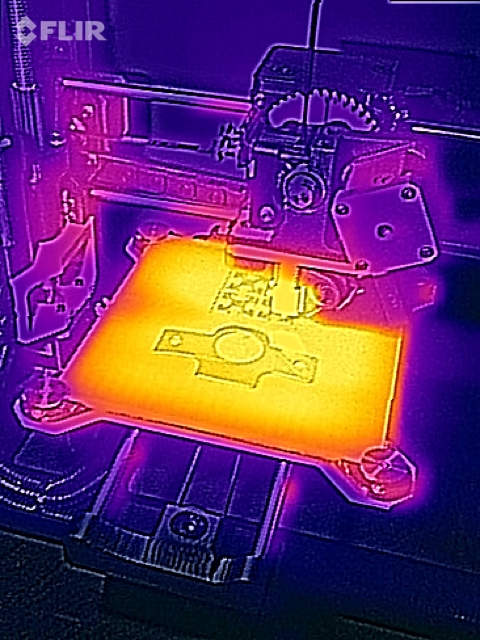

I have a similar issue with my AC in that a vent blows cold air on the front of the Mini from across the room. Thus I’ve noticed issues with warping at the front when the AC is on. I designed/built an enclosure “set” for the front, back, and sides with 1/4" (0.236") acrylic sheets (cut to size) and custom designed/printed corners that hold it all together with friction fit. I’ll post pics soon for anyone interested.
For anyone curious here’s a thermal image of my Mini’s build plate while printing HIPS:

### Author: ![pjones](https://sea2.discourse-cdn.com/flex020/user_avatar/forum.lulzbot.com/pjones/32/9465_2.png) [@pjones](https://forum.lulzbot.com/u/pjones)
#### Post date: [July 15, 2016, 12:27am UTC](https://forum.lulzbot.com/t/calibrating-adjusting-the-mini-cant-print-hollow-pyramid/3688/11 "2016-07-15T00:27:56Z")
Okay, I’m back 😉
I fixed my endstop switches, put the printer back together, and leveled/aligned the bed to the z-axis bars.
But I’m still getting terrible prints, especially on one side of the bed. Here are two videos (timelapses) from two different object prints that seem to have problems on the same side of the bed. In this video the horizontal view is flipped so the left side of the video is the right side of the bed.
