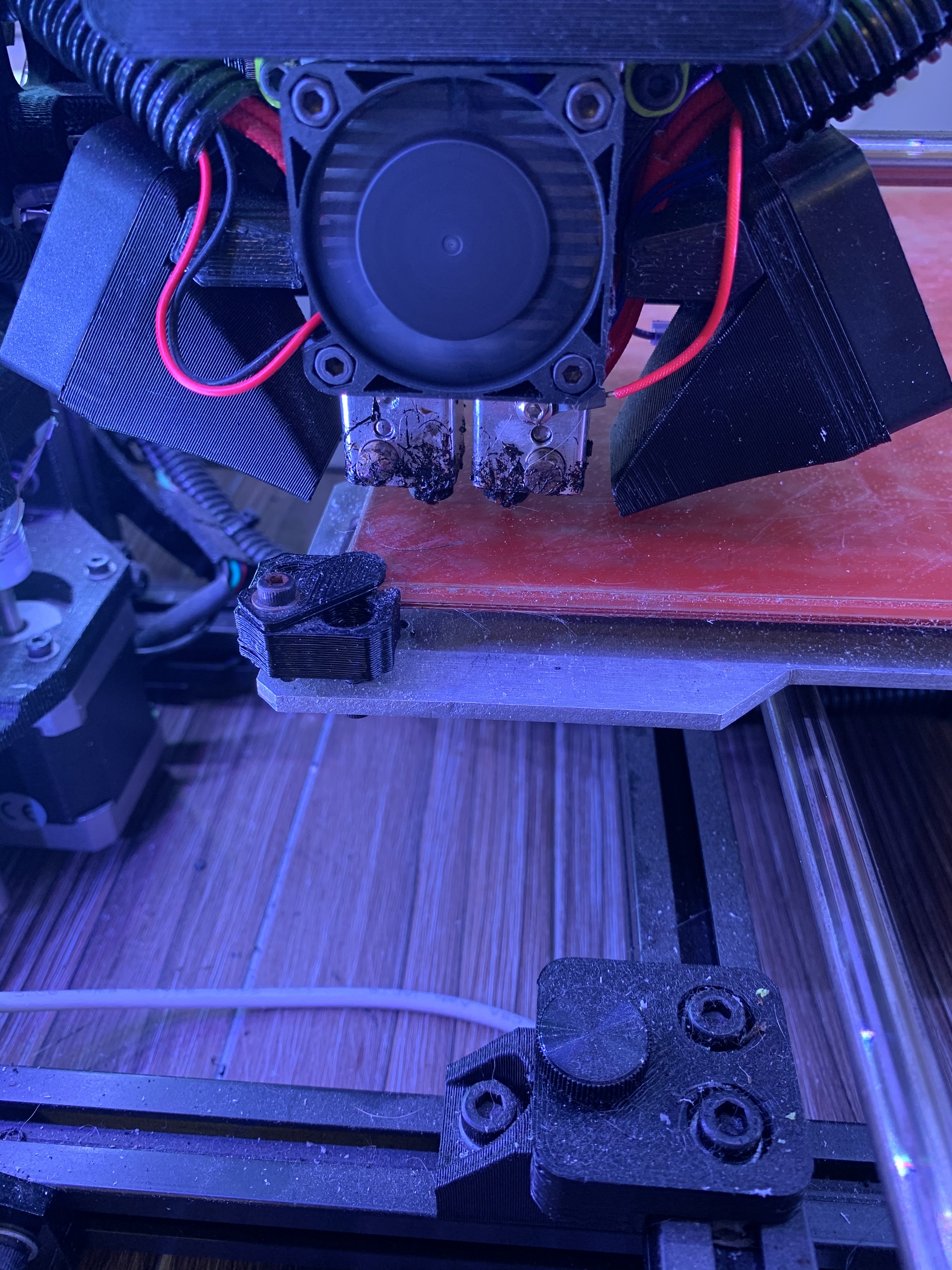

So i added the code lines and the head didn’t change its home position not sure what I can do differently to achieve the goal.
 ![Machine setings1](https://us1.discourse-cdn.com/flex020/uploads/lulzbot/original/2X/9/90bc8a3de30e7b3e5693dd933c650ed1dd378b2a.jpeg) ![Machine settings](https://us1.discourse-cdn.com/flex020/uploads/lulzbot/original/2X/0/04b350e2477e5982a28869db092afa3c5bb92721.jpeg) ![home position on bed](https://us1.discourse-cdn.com/flex020/uploads/lulzbot/original/2X/d/d4cedb683be43e2ba79fa0f212630aa41e746a97.jpeg)
**Post date:** [June 16, 2020, 10:08pm UTC](https://forum.lulzbot.com/t/centering-bed-for-calibration/21683/22 "2020-06-16T22:08:35Z")
These are the results on my LulzBot TAZ 6. I entered the commands on the Terminal Tab:
```auto
Send: G28 X Y ; Determine origins based on the endstops
Recv: X:-19.00 Y:258.00 Z:10.00 E:0.00 Count X:-1910 Y:25929 Z:16000
Recv: ok P15 B4
Send: G0 X0 Y0 ; Goto 0,0
Recv: ok P14 B4
Send: M114 ; Where are we?
Recv: X:0.00 Y:0.00 Z:10.00 E:0.00 Count X:0 Y:0 Z:16000
Recv: ok P15 B4
Send: M206 X-50 Y-50 ; Change the offset. Nozzle doesn't move.
Recv: X:-50.00 Y:-50.00 Z:10.00 E:0.00 Count X:0 Y:0 Z:16000
Recv: ok P15 B4
Send: G0 X0 Y0 ; Nozzle now moves to the "new" 0,0
Recv: ok P14 B4
Send: M114
Recv: X:0.00 Y:0.00 Z:10.00 E:0.00 Count X:5025 Y:5025 Z:16000
Recv: ok P15 B4
I originally tried `M206 X50 Y50` but the subsequent `G0 X0 Y0` Hit the endstop and failed. BTW, the `[...]` are suppressed temperature reports.
