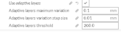

In that regard, does anyone have a better/faster PETG profile for the TAZ6/Single Extruder. Or have an educated opinion on what would be the settings to change besides “print speed”?
stay safe
**Post date:** [March 27, 2020, 1:57am UTC](https://forum.lulzbot.com/t/covid-19-crisis-assistance/21103/14 "2020-03-27T01:57:58Z")
1.) Print at a larger layer height
2.) Increase your _ **Initial** _ layer height
3.) Change your nozzle with a larger diameter nozzle
4.) Lower your infill percentage if its high. (You may gain a _little_ time)
5.) Try this adaptive layers (these will take in account the values you have in 1 & 2 above)
You can try enabling the _ **Adaptive Layers** _ feature (under the Experimental section at the bottom) and play around with those 3 values in the adaptive layers section. I’ve had mixed results with this settings. Sometimes it speeds things up other times it gave me a longer print time for reasons unknown to me. I think this setting works best when there’s vertical curves in your model.
![image](https://us1.discourse-cdn.com/flex020/uploads/lulzbot/original/2X/3/3e220b1f8acc4599484230fc64ec87b5ba1aabf8.png)

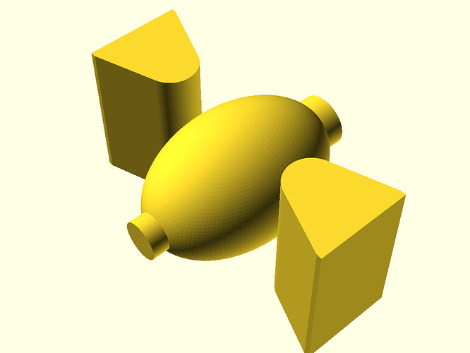

P.S. I’ve attached a brief discussion of the next steps and a few models I mocked up, for our local group to work on, your thougts would be appreciated.
Now next steps are to start modeling up a good pusher plate and reaction plate and a reliable way to mount them on the printer. I am going to go out on a limb and predict that reprap style printers with the moving gantry, and moving bed are going to work the best for this application.
My reasoning is this.
1. Most have two motors on the z to lift the heavy gantry and print head. In this application, the weight of the gantry and print head act as a counter weight when we want to push down with the z axis. In fact we can even add additional weight to the gantry, as needed to balance the load. This makes most effective use of the z axis. The X and Y axis might be need to get sufficient velocity to achieve higher respiratory rates. Typically, in those conditions the Tidal Volume (air moved) is small, so the amount of force required will be similarly small. So, here is a great opportunity for some bored mechanical engineer to develop a model to help us plan a path for the X,Y, and Z movement to generate a given tidal volume and respitory rate. This will then need to programed into the firmware, so that a given requested Tidal Volume and respiratory rate will then translate into a cyclical movement in X, Y, and Z axis, such that we keep the loads on each axis below the maximum where the steppers start to lose steps. It might look like this:
Initial movement; diagonal X, Y, Z engaged to move quickly, when the bag applies the least resistence. Move the head to a point on the bag where continued motion in Z will minimize the load on the X and Y axis. Then continue the motion straight down in Z, when the resistance from the bag is at it’s maximum, because the Z axis can handle the additional load.
Anyways, that is just the general idea for the motion planning.
Next we need some of you great designers out there to start modeling the pusher block (to be mounted to the print head), and the reaction block (to be mounted to the print bed.
My thoughts on this: First, after playing with the Ambu bag for a bit, I believe the most efficient (least effort to move the most air) will be to have a circular or parabolic pusher plate profile and a circular or parabolic reaction plate profile
(see picture). Note: these profiles will be mounted perpendicular to the line motion of the actuator, so that if we are moving all three axis in a down-back-right direction, the pusher block will be mounted at angle on the print head that is orthogonal to this line, as will the reaction block. So, lets get to work designing those pieces.

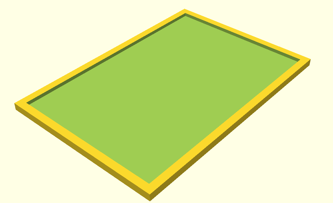

How to mount them? It would be nice for testing if we didn’t need to modify the printer, so something that goes over the print head and fastens securely would be nice. As for the reaction block, something that is secure on the print bed but easily removed would be nice. My initial idea for this is to make a cover plate (or frame) that sits on top of the print bed and hangs over each edge and can be held on with binder clips.
For example see picture. Of course, if if is larger than the print bed, it would need to be broken up and puzzled together. It would not need to be a monolithic part, as long as it held securely, and was sufficient to resist the pusher plate forces.
Finally, we will need a simple secure way to attach the Ambu bag to the bed. This could be Velcro straps thru printed lugs on the base plate, or clips. Most likely we will want to attach around the cylindrical vent tubes at each end, but others might have a better idea. Ideally, the bag should be easily accessible for hand squeezing in an emergency. .
I can send you a stl for the ambu bag, and scad files for the other bits. Please have fun and share what you come up with. The sooner we have a printed design, the sooner we can start stress testing it, measuring the air flow, and evaluating it for long term use. It’d be nice to run these designs for days to see what failure modes pop up. I’ll ask if there is a supply of old used (not on Covid patients) Ambu bags we could get to test with.
 ![AmbuBagView1](https://us1.discourse-cdn.com/flex020/uploads/lulzbot/original/2X/3/36cd44a49663935c4efca340e233138411913590.png) ![BedCover](https://us1.discourse-cdn.com/flex020/uploads/lulzbot/original/2X/0/077695181cbd860ba2ecde9588cf7a6c2abc0884.png) ![BedCoverPuzzled](https://us1.discourse-cdn.com/flex020/uploads/lulzbot/original/2X/2/2e1b6613084e3391db2e588e6b3bab64f4e5f1f6.png)
