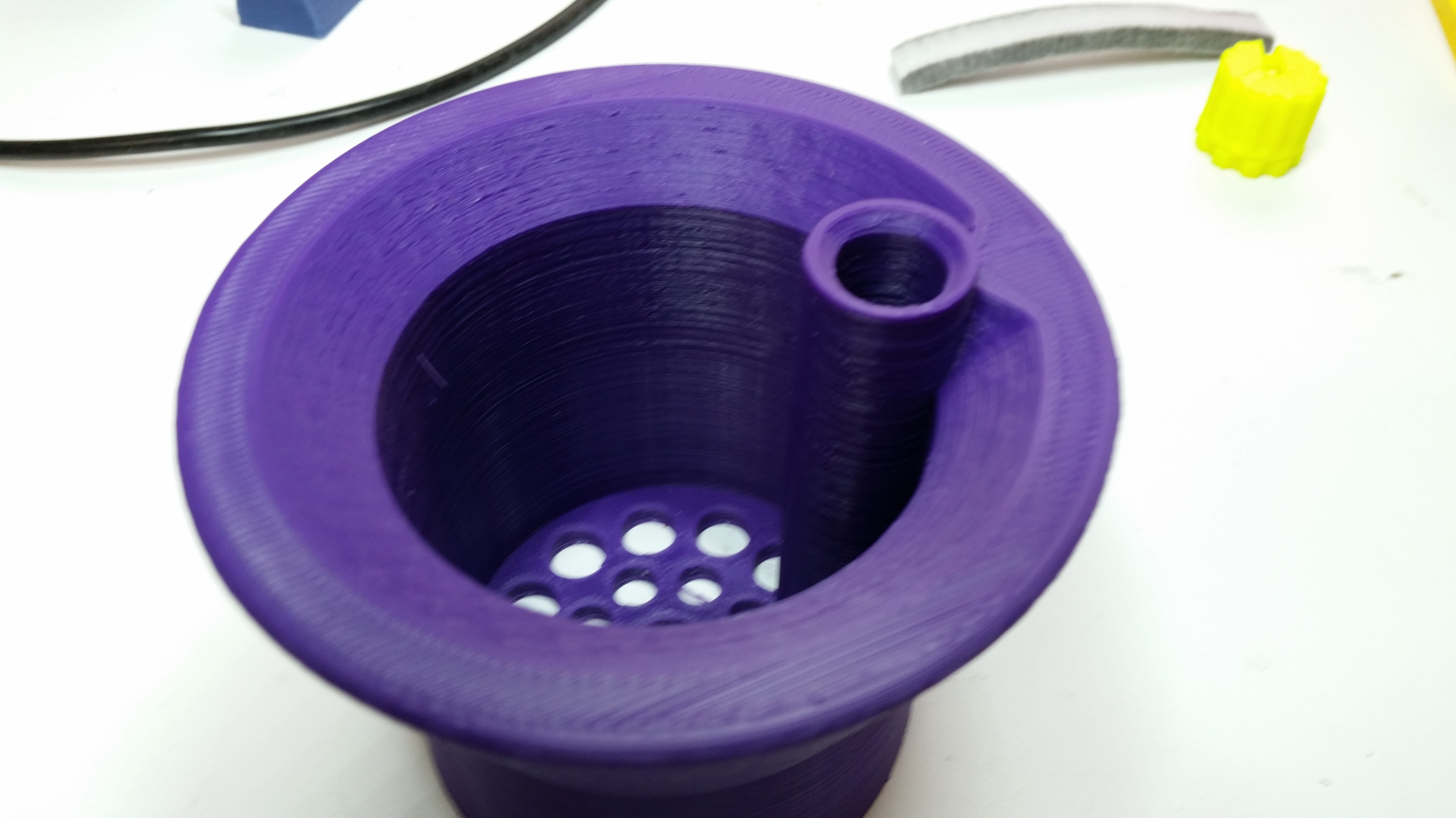

**Post date:** [August 3, 2016, 9:30pm UTC](https://forum.lulzbot.com/t/cura-2-1-2-beta-and-the-taz-6/3799/6 "2016-08-03T21:30:50Z")
I tried it.
Here is what I have as my Taz6.json file at home. 😊
Trying it and it seems currently to be printing fine.
[lulzbot\_taz6.zip](https://forum.lulzbot.com/uploads/short-url/c2cui3nl9QnAP0PKooYcG5yMob3.zip) (1.99 KB)
 ![20160810_134239.jpg](https://us1.discourse-cdn.com/flex020/uploads/lulzbot/original/2X/2/2ba1528ed2ec6285a4e22dab2aff9872428785f0.jpeg)
