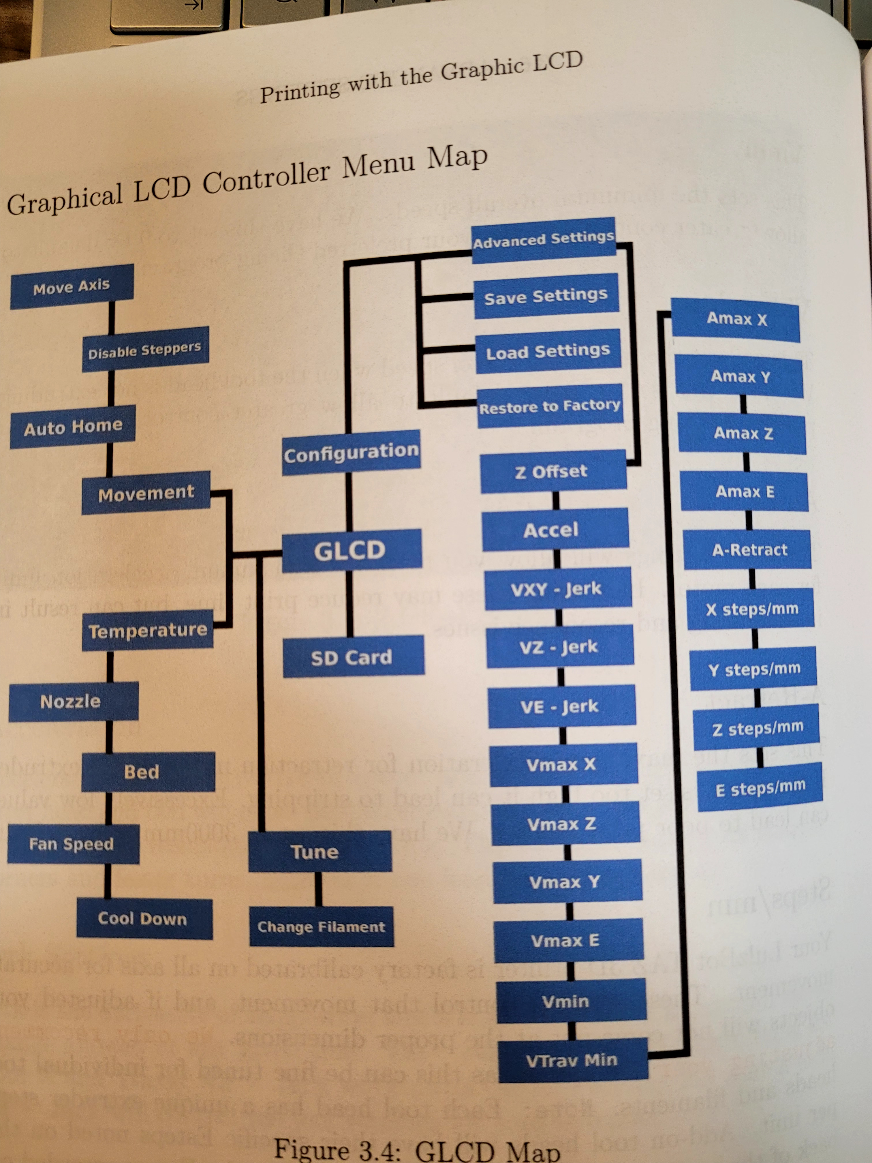

Thank you for help. On my LCD menu, I do not have a tool head option
here is the map of my LCD
thanks you for any additional assistance you can provide
Bonita

v1+1+9+16 this is what shows when I turn on the printer
and, here is my LCD map
Right now, my printer is working better, but I would like to verify the tool head.
thank you

1.1.9.16 is pretty old and I can understand why CuraLE 3.6.37 doesn’t work. You need to either go back to the original CuraLE that came with the printer or you need to update the firmware in the printer using CuraLE 3.6.37.
Also, posting a page from a manual of the LCD menu map doesn’t tell us much unless you have manually verified that the actual LCD menu exactly matches the manual. It might match 1.1.9.16 but it certainly will not match if you upgrade the firmware to the version supplied with CuraLE 3.6.37.
