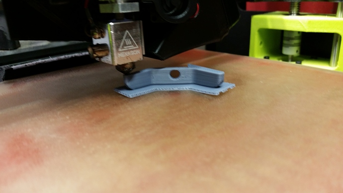

Although I did see my bed go somewhat clear again… It did go away, so far it’s looking good and prints are now sticking… 😃
 ![HotSpot.jpg](https://us1.discourse-cdn.com/flex020/uploads/lulzbot/original/2X/c/ca08aa40e66e017d7750c429b92e9aa9ce9a75d6.jpeg)

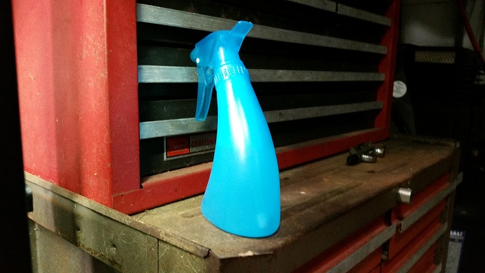

I used a brand new micro-fiber rag instead of blue shop paper towels… and instead of using my spray bottle, I used alcohol from main bottle… The difference, is that the main bottle is stored on a wooden shelf, whereas the spray bottle I’ve been using has been sitting on my metal toolbox… \<-- Perhaps our high humidity here(Louisiana), and metal and alcohol’s love for moisture has caused my spray bottle to accumulate some water?
