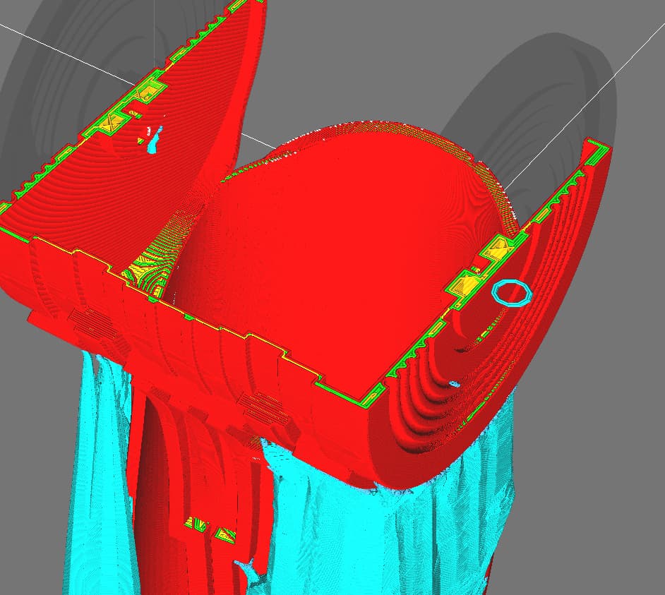

I’m having a ton of issues with tree supports not working on this model. Supports are in mid air
 ![image](https://us1.discourse-cdn.com/flex020/uploads/lulzbot/original/2X/3/38e9b0bf73aa86e041f79a1746c0f7967302787a.jpeg)
**Post date:** [July 3, 2023, 11:47am UTC](https://forum.lulzbot.com/t/cura-lulzbot-edition-4-13-v2-4-beta-testing-now-with-more-mac-in-every-download/25086/72 "2023-07-03T11:47:24Z")
There isn’t much we can do to help with just a screenshot. Can you provide the .stl file?
**Post date:** [July 3, 2023, 9:44pm UTC](https://forum.lulzbot.com/t/cura-lulzbot-edition-4-13-v2-4-beta-testing-now-with-more-mac-in-every-download/25086/73 "2023-07-03T21:44:58Z")
I’m guessing the STL has a bunch of errors in the mesh to cause this. A b Morgan said, the STL would be helpful in figuring this behavior out

I believe I’m using the correct part. I didn’t find any mesh errors.
CuraLE 4.13.0 beta v1.5, Ultimaker Cura 5.3.1, Ultimaker Cura 5.4.0-beta.1, and PrusaSlicer 2.6.0 all generated what appears to be valid tree supports. We probably need to know more about what settings and manipulations were done to the model. I scaled it to 35% and then placed it on the bed. Changed supports to “Tree” and “Touching Buildplate”.
 ![Shin-CuraLE-4.13](https://us1.discourse-cdn.com/flex020/uploads/lulzbot/original/2X/0/0f05914811d5f3e5fecf4034299711e78343bc67.jpeg)
**Post date:** [July 4, 2023, 9:09pm UTC](https://forum.lulzbot.com/t/cura-lulzbot-edition-4-13-v2-4-beta-testing-now-with-more-mac-in-every-download/25086/76 "2023-07-04T21:09:57Z")
No issues with tree supports with default settings. I just changed my zmax so no scaling was required.
 ![image](https://us1.discourse-cdn.com/flex020/uploads/lulzbot/original/2X/d/d3aef50eba422d7764f40f21c2e4ebe50a78902f.png)
**Post date:** [July 5, 2023, 5:24pm UTC](https://forum.lulzbot.com/t/cura-lulzbot-edition-4-13-v2-4-beta-testing-now-with-more-mac-in-every-download/25086/77 "2023-07-05T17:24:01Z")
I wonder if it was a processing issue.
I got something like that the first time, made a few edits and then got the partially completed renders you guys saw in my screen shot. Across two computers (Intel i9’s), I had the same issue.
I finally got a successful render the 6th time around and its now printing for 2 days (one to go)
Also, screen shot had settings on the right side. I sent support density to 2% and enable support interface. Most of the other settings I leave alone - they work!
**Post date:** [July 7, 2023, 12:13am UTC](https://forum.lulzbot.com/t/cura-lulzbot-edition-4-13-v2-4-beta-testing-now-with-more-mac-in-every-download/25086/78 "2023-07-07T00:13:58Z")
Well I got 60 hours in and then it failed. Reviewing the video footage and reexamining the slice (glad I always save the 3MF/project file), I see Cura created a support in mid air
 ![image](https://us1.discourse-cdn.com/flex020/uploads/lulzbot/original/2X/7/757150e7cda5d49a0886010cc9bbe465f4e0da2e.jpeg)
**Post date:** [July 7, 2023, 1:15am UTC](https://forum.lulzbot.com/t/cura-lulzbot-edition-4-13-v2-4-beta-testing-now-with-more-mac-in-every-download/25086/79 "2023-07-07T01:15:52Z")
I’ve rotated the part around hoping to cut down on print times
But again, I am having an issue with supports that hang out of now where.
What’s disappointing is Cura 5.4 offers some nice enhancements to Tree Supports
FWIW Cura 4.13 came out in January of 2022. Why is the Lulzbot version so far behind?
Is it possible to add the Lulzbot Taz machine into the newer Cura builds?
