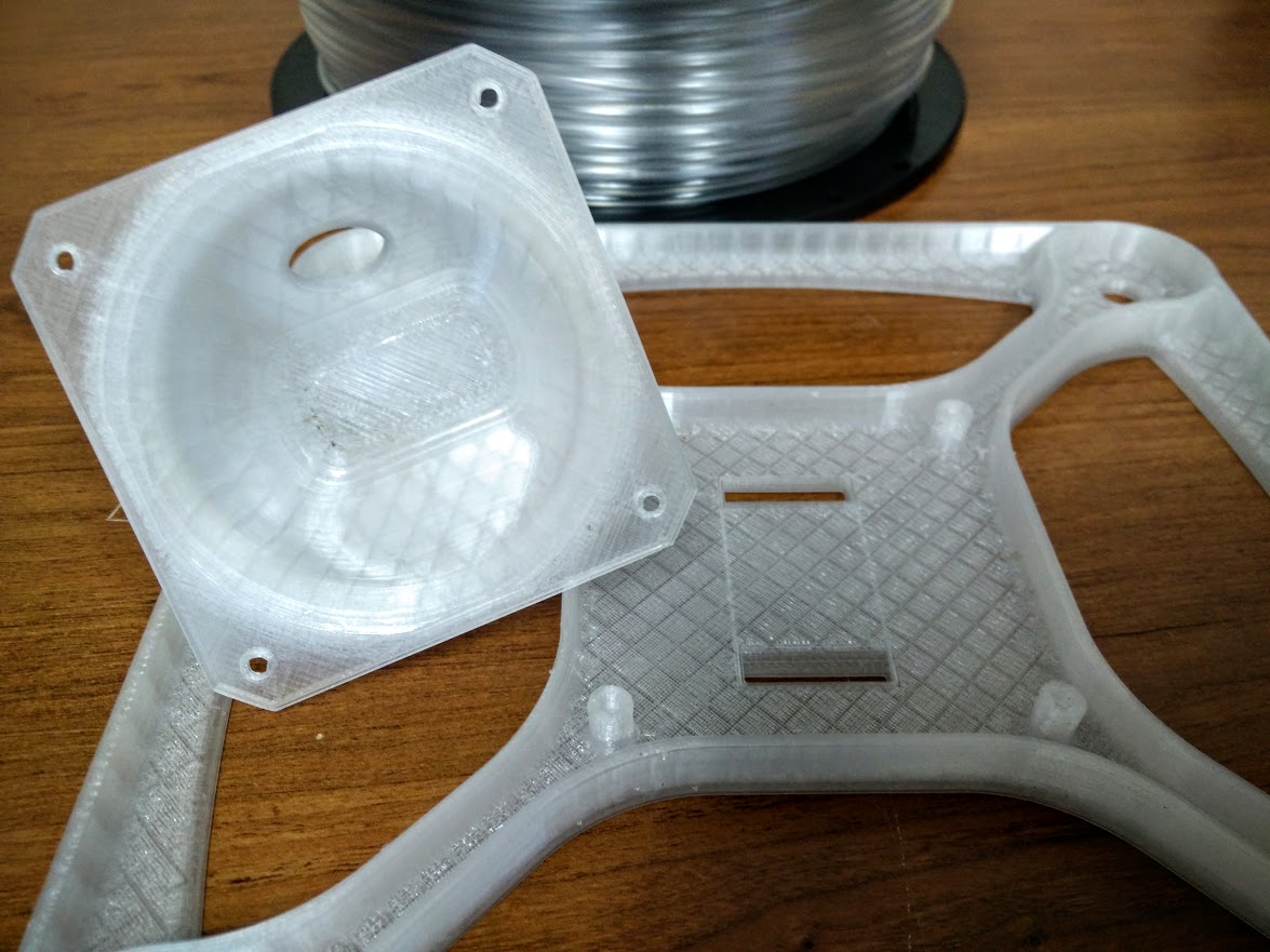

### Author: ![i-t-w.com](https://sea2.discourse-cdn.com/flex020/user_avatar/forum.lulzbot.com/i-t-w.com/32/65_2.png) [@i-t-w.com](https://forum.lulzbot.com/u/i-t-w.com)
#### Post date: [November 24, 2015, 5:52pm UTC](https://forum.lulzbot.com/t/cura-lulzbot-edition-v18-beta/2518/6 "2015-11-24T17:52:41Z")
> [@nbmoretto](#):
> -ChromaStrand: INOVA-1800
Yes Please!
 ![chroma inova quadcopter 2.jpg](https://us1.discourse-cdn.com/flex020/uploads/lulzbot/original/2X/d/daf78099fe75ae27bc4271d32c19a24f0219009d.jpeg)
 ![chroma inova quadcopter 1.jpg](https://us1.discourse-cdn.com/flex020/uploads/lulzbot/original/2X/3/35988680d43f53c75ee1f3d42d9e7d944fe2aab5.jpeg)
