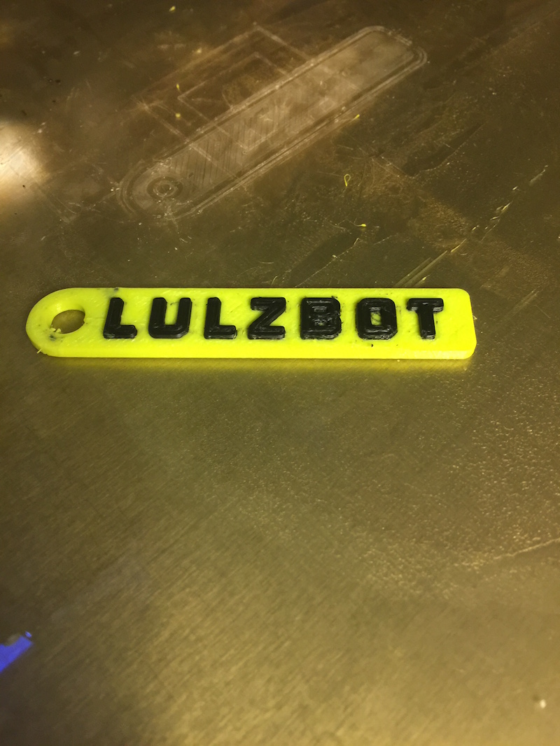

### Author: ![Rp1030](https://avatars.discourse-cdn.com/v4/letter/r/e99b99/32.png) [@Rp1030](https://forum.lulzbot.com/u/Rp1030)
#### Post date: [May 9, 2016, 4:14am UTC](https://forum.lulzbot.com/t/cura-not-merging-for-dual-extrusion/3412/4 "2016-05-09T04:14:53Z")
I am having a problem as well. Something odd with my merge.
It only prints a one sided keychain, the keychain appears as it should in view mode, but Layers and the actual print are one sided.
edit: I just realized that this will only happen when ABS / Ninjaflex profile is selected.
edit after edit: I found out that Cutoff From Bottom is set to 2 in the ABS / Ninjaflex profile. Setting it to 0 like the rest of the profiles will fix this.

### Author: ![nickthetait](https://avatars.discourse-cdn.com/v4/letter/n/ac8455/32.png) [@nickthetait](https://forum.lulzbot.com/u/nickthetait)
#### Post date: [May 12, 2016, 7:00pm UTC](https://forum.lulzbot.com/t/cura-not-merging-for-dual-extrusion/3412/5 "2016-05-12T19:00:50Z")
Thanks for reporting back your findings Rp1030, I’ve fixed that profile. Next release of Cura LE should not have that problem.
