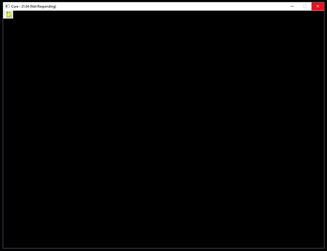

I’m having a similar issue on Windows 10.
Right now I’m about 18 hours into a 28 hour print and Cura has become unresponsive.
The application was minimized and running fine in the background. It’s still running now but I had a hard time getting the window to appear, and when it did appear it was mostly black and says Cura - 21.04 (Not Responding). What’s really weird is there seems to be a tiny version of the UI in the upper-left corner of the window. Image attached.
The Print Control window is nowhere to be found. Somehow the print continues though… for now anyway.
I have to do a filament change in about 5 minutes so this is really a bummer.
 ![CuraNotResponsiveCapture.JPG](https://us1.discourse-cdn.com/flex020/uploads/lulzbot/original/2X/d/d9ec1663bb89ce16336714cdb69f6bc7f9878fbb.jpeg)

I know that you’re having problems with Cura on your windows machine but the picture you posted with the tiny UI is adorable. Kinda makes all the aggravation of 3D printing issues fade away for a second or two when odd little stuff like that happens.
i have to ask did the print turn out? You said you were 18 hours in to a 28 hour job when Cura became unresponsive, just curious about what became of your print. I hope it turned out!
