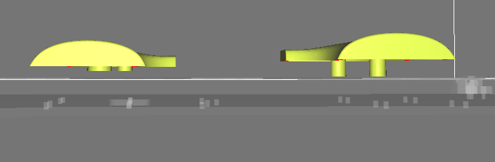

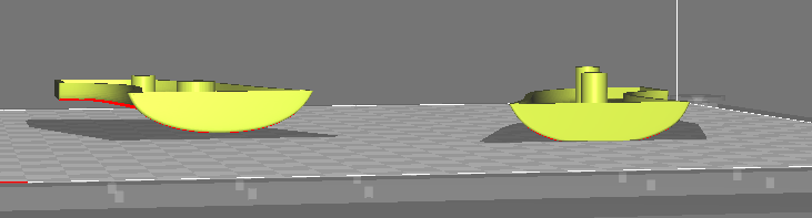

here are screenshots of two shells showing you them
either floating or intersecting with the print platform.
both make no sense - Cura should perfectly be able to see that the two tube ends are flush and level
providing a normal to use to orientate the STL model well.
I wast so much support material it is not funny
 ![Screen Shot 2018-05-24 at 10.24.49 AM.png](https://us1.discourse-cdn.com/flex020/uploads/lulzbot/original/2X/e/ef7f199f247ee08f57bd5bc75dbddbdb02f8bd12.png)
 ![Screen Shot 2018-05-24 at 10.24.22 AM.png](https://us1.discourse-cdn.com/flex020/uploads/lulzbot/original/2X/0/07bbea02f2e09ad439c423c7fe6a37f06ccef4c2.png)
**Post date:** [May 29, 2018, 1:40pm UTC](https://forum.lulzbot.com/t/cura-stl-model-floating-or-intersecting-with-print-bed/5919/2 "2018-05-29T13:40:50Z")
Because Cura supports dual extrusion, it has to allow models to be positioned above the bed because there may be another model that will provide the support. It also allows models to be positioned below the bed surface and that portion below the bed will be ignored when sliced. I have used this to position an animal model whose feet were not “flat” on the surface. Moving it down a couple of layers worth until all four feet were “flat” on the bed.
Cura also has a preferences setting for “Automatically drop models to the build plate” which may not be set on your version. You can also right-click on a model and select “Arrange all models”. Cura also has a “Lay flat” option when you select a model and choose rotation.
An .stl model can be defined using any portion of the Cartesian coordinate space. Slicers will attempt to move them into the correct position in relation to the printer’s coordinate space, but they may need a little human help sometimes. The tools are there, you just have to use them.
