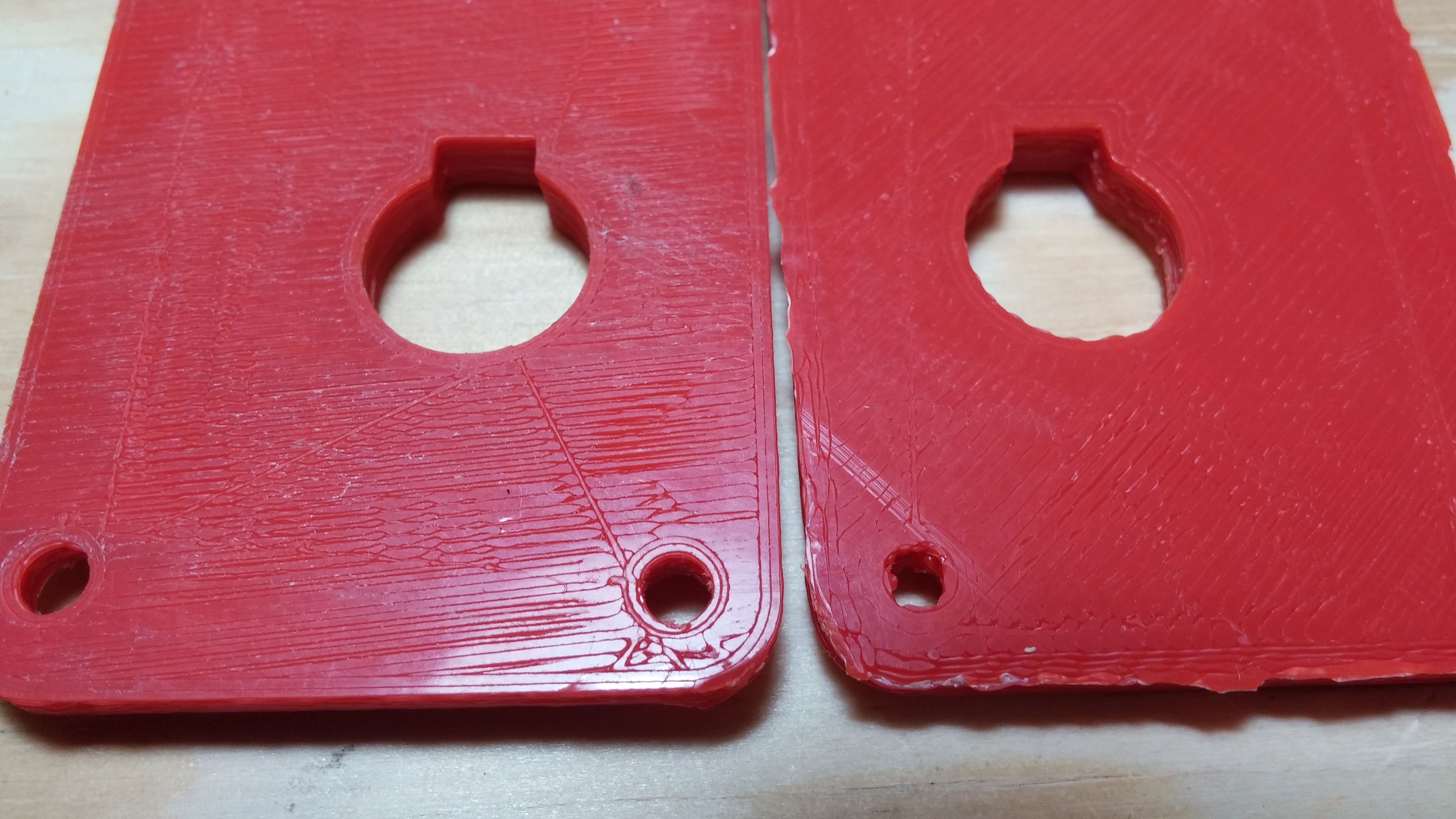

I loaded up Cura 14.01 this weekend. I have to say, my Taz has never produced nicer parts. If you are fighting with Slic3r, give Cura a shot.
 ![0302141916.jpg](https://us1.discourse-cdn.com/flex020/uploads/lulzbot/original/1X/a724b5aaf0e2e0d51087f321a94e3d4710730d87.jpeg)
 ![0302141607.jpg](https://us1.discourse-cdn.com/flex020/uploads/lulzbot/original/1X/19d2b2e8e87bae272f948fe608e15a667d9515ed.jpeg)
It is also doing a good job with holes.
I have attached my current Cura setup file.
[cura.ini](https://forum.lulzbot.com/uploads/short-url/flq4JqkWvftLANfu2BBRwtldVVl.ini) (4.25 KB)

Thank you for sharing your g code settings. I successfully printed this front end of a Cadillac RC car model with yellow HIPS filament. The dimensions were 7 inches long x 2 inches high. The temperatures had to be adjusted as follows:
1. Hot End Temp: 235 C
2. Print Bed Temp: 115 C
It turned out great, and Cura is easy enough to figure out. Thanks again.

I printed a couple small parts last night sliced with Slic3r v1.0 and the new medium profile from Lulzbot. The results were pretty good. I was even able to remove the support structure!

I just tried Cura with your configurations. The print was looking fantastic until I hit an area of bridging. There is a “lid” on the part and as it tried to close in the lid it kept the speed up at the same “infill” speed which is I think 100. The ABS just fell apart trying to bridge the supports with such high speed. I went back and looked through the advanced settings and don’t see where I can manually set the bridging speed. Is that not an option?
**Post date:** [July 30, 2014, 4:56pm UTC](https://forum.lulzbot.com/t/cura/496/13 "2014-07-30T16:56:08Z")
It looks like they lost that setting when the moved away from Skeinforge.
[http://umforum.ultimaker.com/index.php?/topic/4686-plug-in-bridging-settings/](http://umforum.ultimaker.com/index.php?/topic/4686-plug-in-bridging-settings/)
**Author:** ![bhicks22](https://avatars.discourse-cdn.com/v4/letter/b/bb73d2/32.png) [@bhicks22](https://forum.lulzbot.com/u/bhicks22)\
**Post date:** [July 30, 2014, 9:55pm UTC](https://forum.lulzbot.com/t/cura/496/14 "2014-07-30T21:55:17Z")
If I can’t set the bridging speed manually then I would have to print the entire part much sLower which would make An eight or nine hour print take 20 plus hours. it seems like cura is really good for certain parts but not so good for other parts. I have been using matterslice with pretty good results on all parts. It’s more advanced than cura but not as complicated as slicer. It seems to be the middle ground between the two softwares. Its a free software you can download from [matterhackers.Com](http://matterhackers.Com)
**Author:** ![unxetas](https://avatars.discourse-cdn.com/v4/letter/u/67e7ee/32.png) [@unxetas](https://forum.lulzbot.com/u/unxetas)\
**Post date:** [July 31, 2014, 6:01am UTC](https://forum.lulzbot.com/t/cura/496/15 "2014-07-31T06:01:59Z")
Yeah, I really like Cura but hate that they haven’t brought in any bridging settings. I understand that they’re focusing on other stuff first, but it seems like such a crucial part of slicing… :\
Thanks for the tips about matterslice, I’ll check that out.
