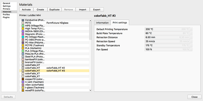

I installed Cura2 today (2.6.52) on Mac OS 10.12.6, and ran into a problem where I can’t remove or change settings on duplicated materials (greyed out).
 ![Skærmbillede 2017-11-28 kl. 22.31.31.png](https://us1.discourse-cdn.com/flex020/uploads/lulzbot/original/2X/2/2f5a7c855162b3065ef086501c2f1d12bc82c61f.png)
1. I installed 3 printers TAZ6, TAZ6 flexydually, and Lulzbot Mini.
2. I selected the printer menu next to the box -\> mange printers -\> Materials and duplicated the ColorFabb XT profile 4 times and made a temperature change, removed one and renamed one of them FormFutura HDGlass
3. I added two items to the start G-code for the lulzbot mini (M92 and M851):
… snip
M117 Heating… ; progress indicator message on LCD
M92 E885
M851 Z0.15
M109 R{material\_print\_temperature} ; wait for extruder to reach printing temp
… snip
4. I saved gcode file for a test print
5. I added printer Lulzbot mini flexystruder
6. I selected the printer menu next to the box -\> mange printers -\> Materials
Now I can not change any of the 3 duplicated profiles or remove them as “remove” and “settings” are greyed out.
I tried restarting Cura2 without any change. Any ideas before I wipe and re-installe Cura2?
**Post date:** [November 28, 2017, 10:02pm UTC](https://forum.lulzbot.com/t/cura2-materials-locked-settings-grayed-out/5370/2 "2017-11-28T22:02:23Z")
Hello jlund,
Thank you for the report, we truly appreciate the feedback. This one was reported to us earlier today here:[Cura 2.6 - Materials Management?](https://forum.lulzbot.com/t/cura-2-6-materials-management/5362/1) and is currently being worked on here: [LulzBot 3D · GitLab](https://code.alephobjects.com/T1380)
Feel free to sign up as a follower and get the latest update!

**Post date:** [November 29, 2017, 2:22pm UTC](https://forum.lulzbot.com/t/cura2-materials-locked-settings-grayed-out/5370/4 "2017-11-29T14:22:06Z")
> Cura2 material handling being solved
If you are interested, there is a workaround at the moment while we solve the root issue.
In materials manger Duplicate a material, this will now show up at the bottom of your list.
You can edit, rename, and change all aspects of this material **until** you restart the Cura program.
Once the program is restarted, you will not be able to edit that material profile (for now.)
So if you have your parameters ready, you should be able to push forward for now 😉
