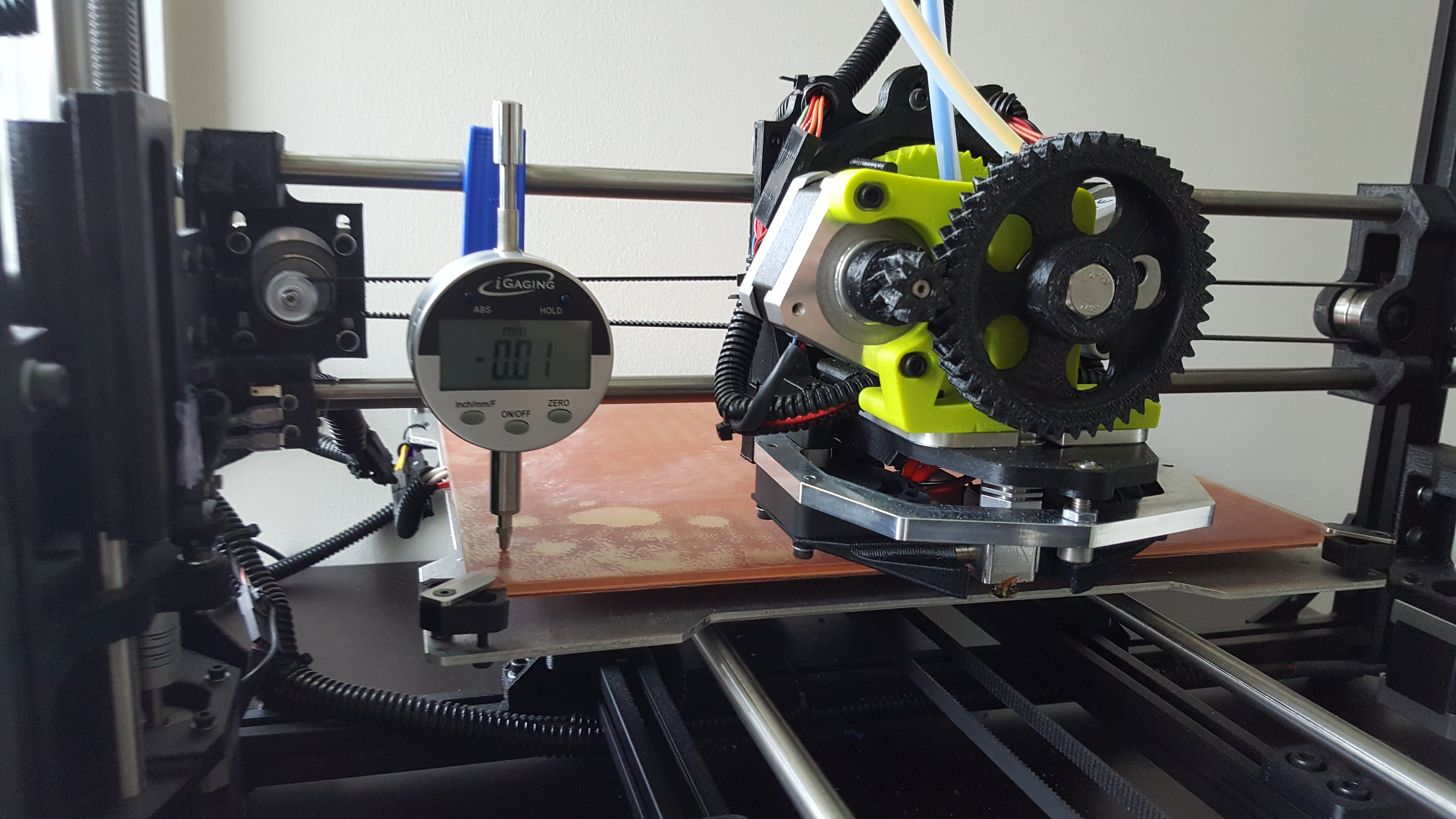

**Author:** ![mike.stanley](https://sea2.discourse-cdn.com/flex020/user_avatar/forum.lulzbot.com/mike.stanley/32/9425_2.png) [@mike.stanley](https://forum.lulzbot.com/u/mike.stanley)\
**Post date:** [May 25, 2016, 8:26pm UTC](https://forum.lulzbot.com/t/dial-gauges/3480/8 "2016-05-25T20:26:18Z")
Success. Level within 0.01mm on all corners. Center does sag a little (0.06-0.08), but haven’t seen it affect anything. The paper method before had me within 0.13. So the dial is solid improvement.
Moving the indicator around wasnt too bad. I still may invest in a second though.
Thanks again!
