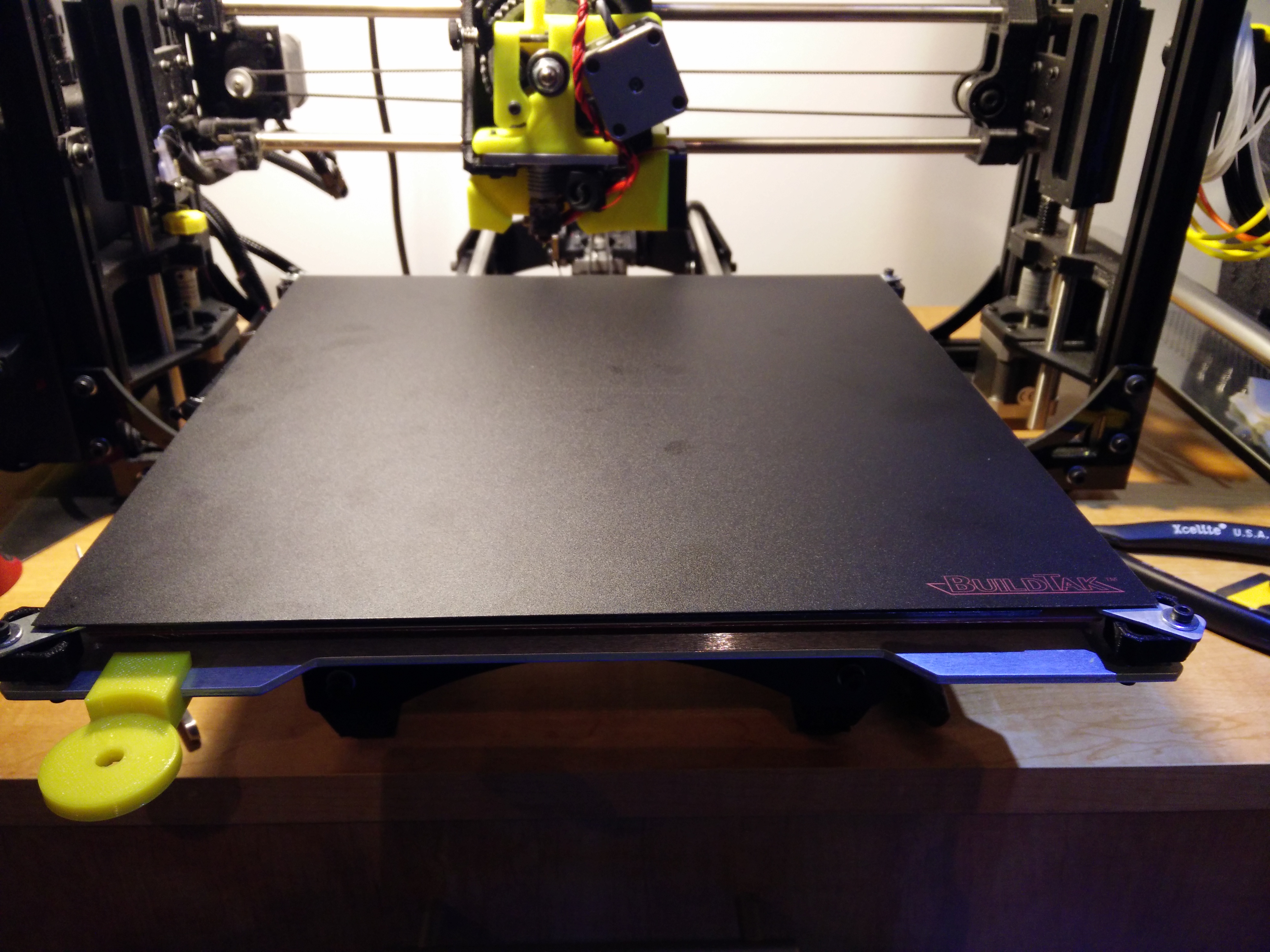

So… I just installed the system, very happy for now !
The base is a little bigger that the TAZ bed, put it’s not a problem at all :

The flexible plate is the same size of the base, so it doesn’t fit with TAZ bed fingers, lucky me I found 4 metal pieces that fit perfectly to replace fingers (it must be a maximum of 1,5mm thickness) :

Finally, the complete system installed :
 ![IMG_20161213_232553.jpg](https://us1.discourse-cdn.com/flex020/uploads/lulzbot/original/2X/d/d90578617c7b96fa8bd2d792490f50defaa95c2e.jpeg)
I made a first print in PLA, without heating the bed, it works like a charm and was easy to remove.

I have tested the heat loss too, that’s not so bad, Set to 50°C, and measured 45/46°C everywhere, I will try with higher temp soon.
I’ll test ABS an PEI soon.

I have tested with the PEI sheet, so far so good ! I don’t know yet if I prefer BuildTak or PEI, but both works very great with the FlexPlate system. The PEI seems stronger than the BuildTak.

With build tak, it’s a bit thinner so abs in particular can stick a bit better, but it’s a consumable item, experience the to pay $30 every 3 to 4 more than with heavy printing to replace the sheet. Pei works about 99% as well, but is essentially indestructible aside from needing to re adhere it every so often

Hi, I prefer PEI sheets, buildtak stick very well, but they are not strong enough in my opinion, the sheet quickly moves and let appear previous print shapes. I ran with both since few months, I used 4 buildtak sheets, and I’m still on the same PEI sheet. I replace my last buildtak sheet with a PEI from amazon.
I prefer this one (0.030") instead the mc master carr one (0.040"), it’s a little bit more flexible.
For the buildtak system, I’m really happy with it, it makes so easy the removal process, I love it !
