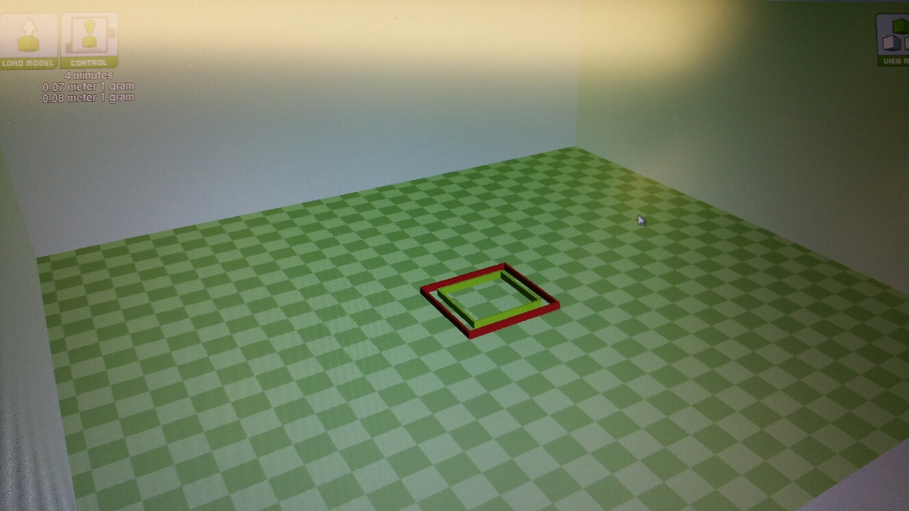

I’m sorry if this has been asked but the search feature is not letting me search.
I got my dual extruder v2 in today. I followed the directions closely and I’m trying to print the calibration print. It looks nothing like the one in the picture. Does anyone know whats going on?
Instructions: (step 27-28)
[https://ohai.lulzbot.com/project/dual-extruder-v2-tool-head-installation/accessories/](https://ohai.lulzbot.com/project/dual-extruder-v2-tool-head-installation/accessories/)
Here’s what I get
[http://i.imgur.com/4hIJSBy.jpg](http://i.imgur.com/4hIJSBy.jpg)
**Post date:** [March 18, 2016, 7:38am UTC](https://forum.lulzbot.com/t/dual-extruder-calibration-error/3150/2 "2016-03-18T07:38:23Z")
Yeah… the directions forget that the “ooze shield” and “wipe & prime tower” are on by default.
To turn off, switch to “full settings” and uncheck the boxes under “Dual Extrusion”.
**Author:** ![sjgoalie](https://avatars.discourse-cdn.com/v4/letter/s/bc8723/32.png) [@sjgoalie](https://forum.lulzbot.com/u/sjgoalie)\
**Post date:** [March 18, 2016, 5:27pm UTC](https://forum.lulzbot.com/t/dual-extruder-calibration-error/3150/3 "2016-03-18T17:27:42Z")
That was it, thank you!
