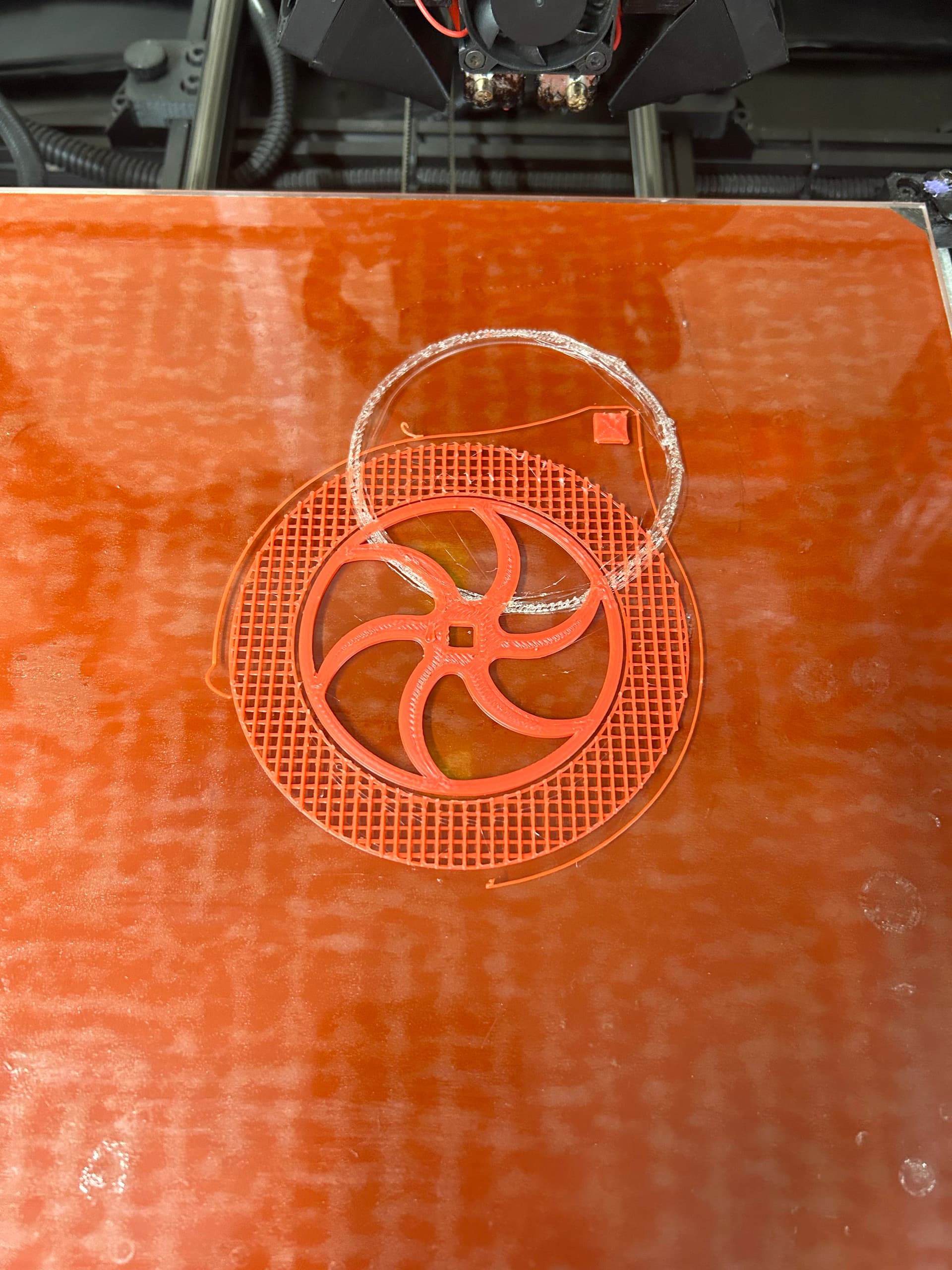

Hi I am having an issue with a taz 5 dual extruder where when it works great while printing the ABS(Red). But when it is supposed to print the TPU(White) it begins to print it with an offset it seems.
 ![IMG_3560](https://us1.discourse-cdn.com/flex020/uploads/lulzbot/original/2X/0/0c1289f0108b4477453c1e31b82d79327a792cc3.jpeg)

This is what should have been printed
 ![image](https://us1.discourse-cdn.com/flex020/uploads/lulzbot/original/2X/b/b7a1523a870f33520614270e1b0ae4d5b91aec0b.jpeg)

Offsets are handled in Cura, with default offsets based on the extruder you selected when you added the printer. If I had to guess (which I guess I do) you have selected the Dual V3 instead of the Dual Extruder V2 (or vice versa). V2 has the nozzles one in front of the other along the Y axis, while the v3 places them besides one another on the X axis. By selecting the wrong one, it’s not shifting primarily on the proper axis, and instead is primarily shifting on the wrong axis.
To fix it, just add a printer to CuraLE and ensure you’re choosing the correct dual extruder with it.

That seems to have done the trick. Thank you.
