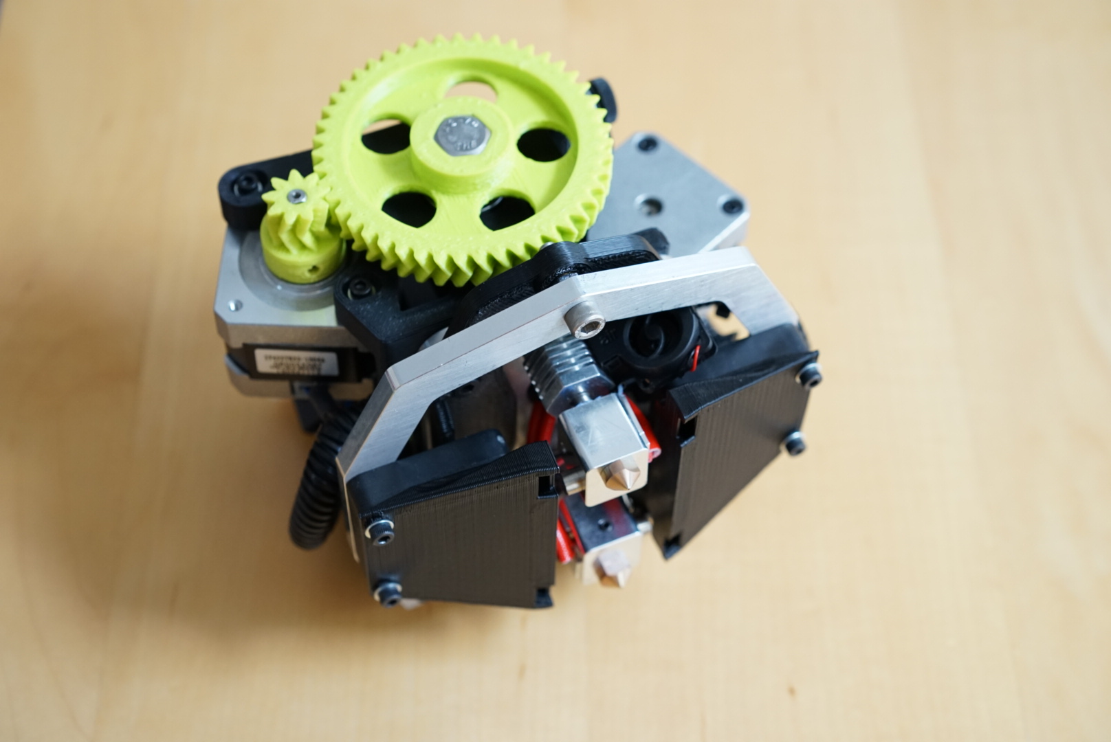

So… the Dual Extruder V2 came in the mail today. It’s a monster… its looks to be well built upon first inspection. For the most part it looks like it well do well for dual color printing of the SAME filament. Because of the fan duct system, it may not do well in mixed filament prints which require different fan cooling characteristics.
Here’s a picture of the bottom of the extruder:
 ![LB Dual Extruder v2.JPG](https://us1.discourse-cdn.com/flex020/uploads/lulzbot/original/2X/2/298b7ea01128498bc2c40ce8f42ed15ef990edb0.jpeg)
There are two fans which can be independently controlled. The issue is the fan ducts. Each duct cools BOTH hotends. Ideally each fan would independently cool the left and right side of each hotend.
So if printing different filament types in each extruder, the options are to block one of the duct port so that only one hotend is cooled by the associated fan or to redesign the ducts so they wrap around the hotend… which would make changing the nozzle more difficult.
I have mixed emotions about this. I have the utmost respect for Lulzbot and the engineers. While this seems like a minor over-sight… it doesn’t demonstrate the expertise I’d expect. I hope the folks at Lulzbot re-visit the duct design for the Dual Extruder v2.

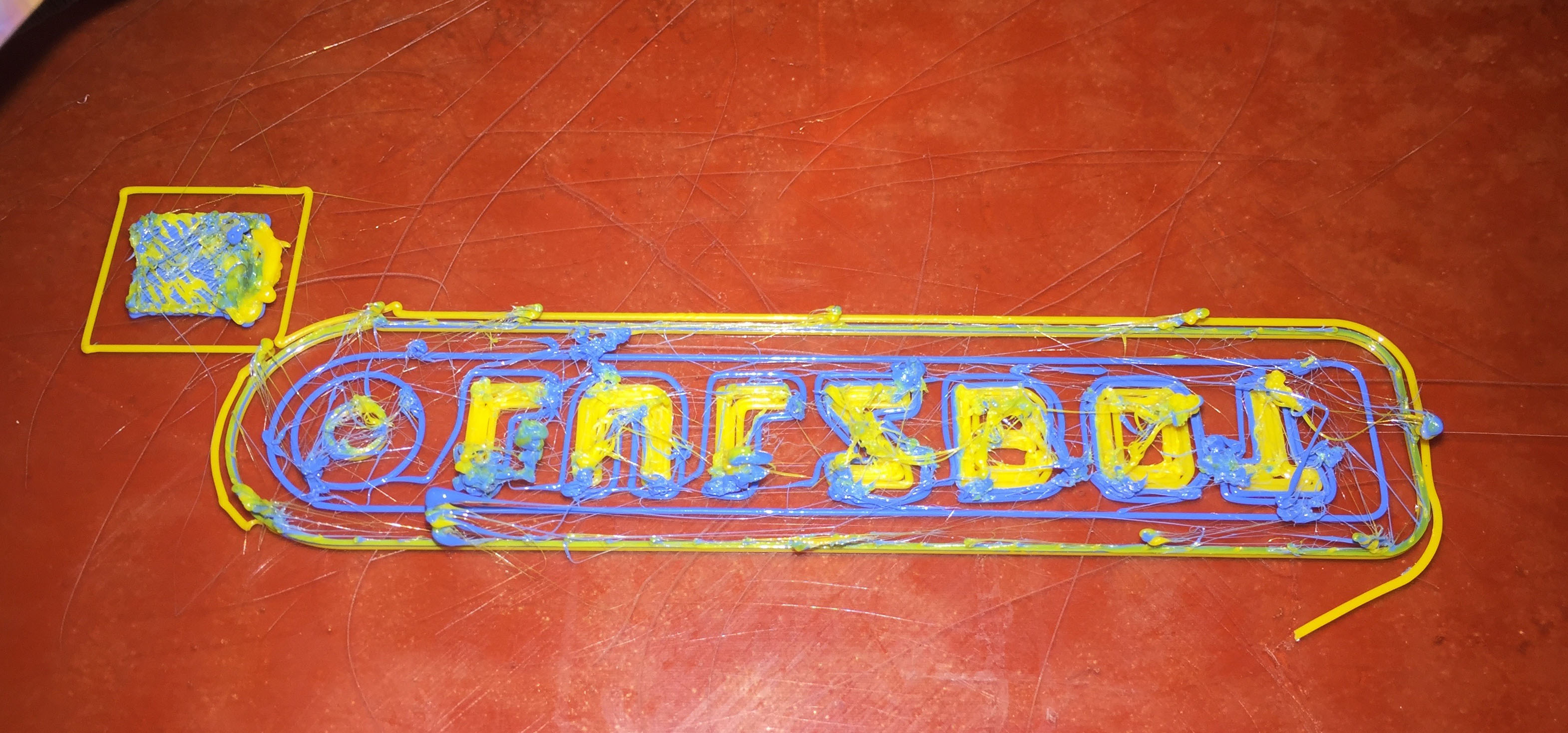

HI-
I got my LulzBot TAZ 5 Dual Extruder Tool Head v2 last week and have been toiling along in the evenings trying to get it to print nicely. Installation instructions are easy to follow and the calibration squares print nicely and its possible to align the two extruders (in X-Y) without too much hassle. However, the problems start when the print is \>2mm tall (Z-axis). Filament from one extruder appears to be blocking the nozzle of the second extruder resulting an incomplete messy print (‘Dual’). As you can see the the gears have dug into both the filaments (‘Filaments’) stopping further extrusion and a complete print. When I print the two colours separately the result is slightly better (‘separate’). Any suggestions would be much appreciated.
Best.
-Peter

**Post date:** [January 31, 2016, 6:01am UTC](https://forum.lulzbot.com/t/dual-extruder-v2-is-available/2734/18 "2016-01-31T06:01:04Z")
Check that your bed is level. It looks like the left side of the blue filament isn’t adhering very well.
Once you do that’ re-check that both extruders are level.

I got mine too. The other part I don’t like about the ducts is they are printed. These are the metal hex extruders and can be run at 300 c. So those ducts are not going to survive. They need to be made out of something else.
Also minor quibble my mount came with a crack where one of the heat inserts was installed and the insert was sticking half way out (the screw pulled it out and there was a gap). Looks like they didn’t get it hot enough and jammed it in delaminating the print. No big deal I can reprint the mount, but that shouldn’t happen to a $500 assembly. Where was quality control? It was very obvious. I noticed it within 5 seconds of taking it out of the box.
**Post date:** [February 2, 2016, 9:04pm UTC](https://forum.lulzbot.com/t/dual-extruder-v2-is-available/2734/20 "2016-02-02T21:04:01Z")
Yeah. I thought about the heat from the hotend and the duct. Sadly this may be a shift in the mindset at Lulzbot towards a business conscious approach.
I pay a premium for parts, I expect the engineering and quality. They’ve given us a usable part (at least my dual extruder seems okay… 🙂), its up to the community to modify and improve the part the final 10%.
